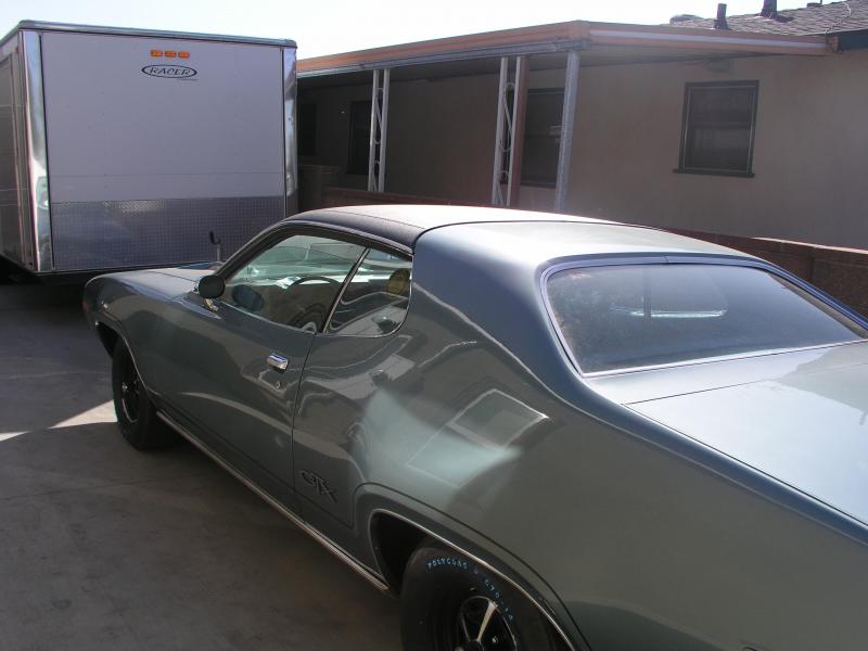

It is called a canopy vinyl roof. See photo of my 1 of 6 GA4 GTX, has gunmetal blue seats.

Any by the way, the moulding on a 71 isn't chrome, it matches the color of the vinyl. Later model years were chrome.
Correct, the top strip is semi gloss black to match the top material. BTW: I may be selling this nearly perfect 71 X, all numbers matching w/build sheet.
I know, but after looking for a correct '71 trim for over a year, I went with the chrome from a '72 and up. I think the chrome looks better any way.

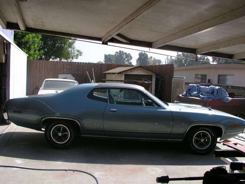

Side view of top:
