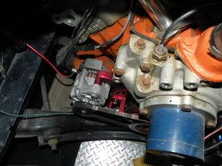

I'm using a Mr. Gasket electric water pump drive kit and I'm being forced to mount the alternator down low because of the water pump pully. I need to mount the alternator on the low passenger side. I've seen a image of one of the set ups but can't find who makes it...
i run a DMI low mount alternator bracket and east coast alternator 1 wire. great neat efficient setup.

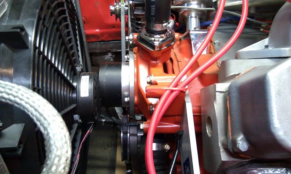

Here is my set up. My elephant ears had a alt. notch machined in it.
