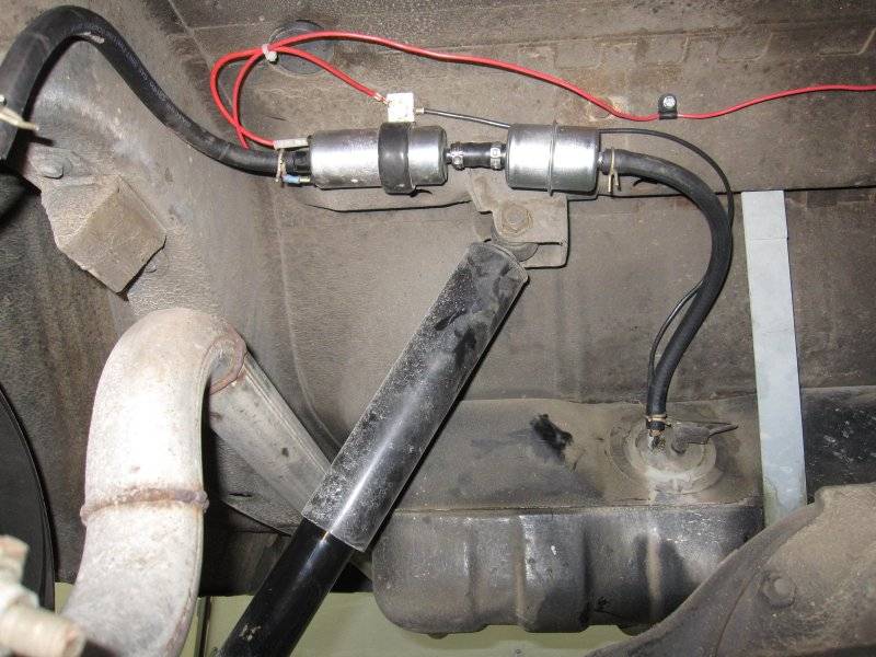

I had exactly this on my 440 6pac in my 70 Challenger RT. I used a Holley red pump and wired via a relay to a toggle switch. I mounted right in front of the tank off the brace that the shocks mount to. It worked ok and did what I needed it to but seemed to add a degree of complexity I didn't feel I needed and eventually removed it.
The fuels of today evaporates very quickly. On my RR, I mounted a Holley Gerotor (QUIET) pump next to the fuel tank. About a dozen years ago, or so. Problem solved.

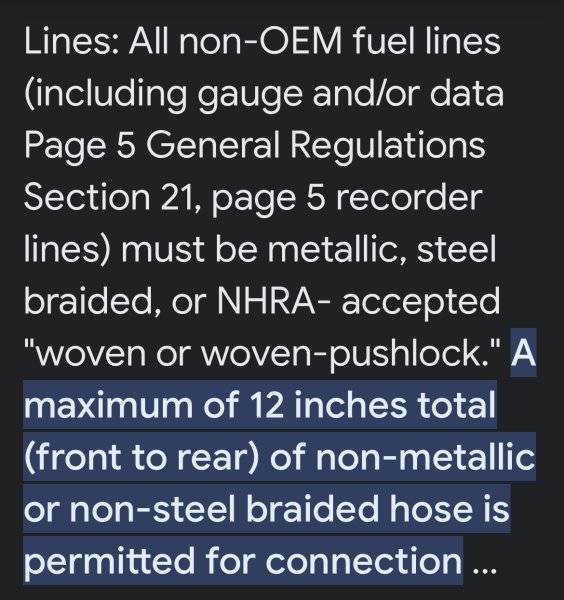

I would never run that amount of rubber line especially in an area that is cooked with the exhaust heat and not easily inspected. This setup is a good way to burn your car up as todays rubbers dry rot quickly even tires can not be sold legally after so many months.

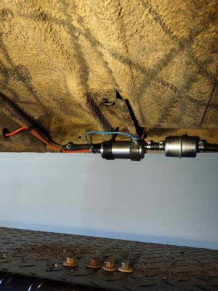

I used this same pump on your recommendation. Initially it was just for priming on a momentary switch . I lost the mechanical pump due to a pushrod failure, and now I am running it as my only fuel pump. I mounted mine along the rocker where the stock fuel line ran. No problems so far.

Perfect!!! It’s why NHRA checks this stuff it’s a fire hazard and puts legitimate builders cars at risk.. Don’t hate the messenger.

I fully understand the reasons for the minimum hose rule. Any tiny length of hose can pose a risk. How many tens of millions of cars and trucks came out of Detroit with hoses? Evidently the need for vibration elimination overrules the risk :).
