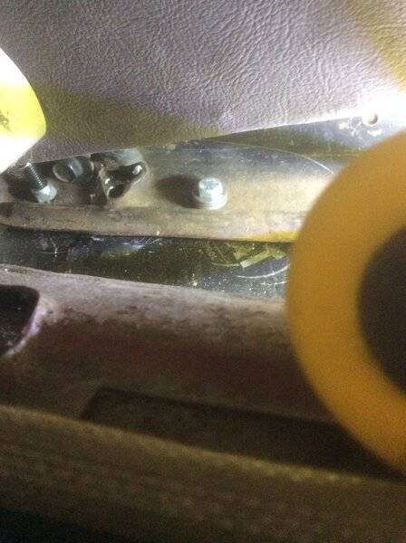

My enormous stomach made me move seat back. Took a 1/4" x 1"x 18" mounted seat on them. Used 4 counter sunk bolts up from bottom to mount seats to steel strips with 5" of the steel strips out front. Drilled 4 holes mounting seat to floor. Holes in the steel strips for floor mounting need to be 4" forward of the holes for mounting strips to seat. you'll need to drill a hole in seat mounting bracket 4" forward or rear seat mounting hole. I don't like my bent to much while driving. Like my leg only slightly bent when I brake hard.

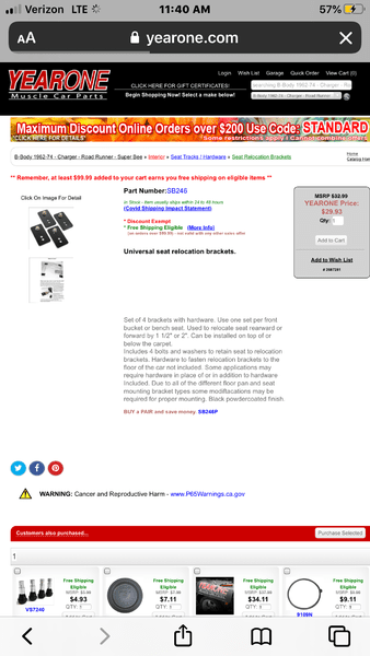

I used Year One relocation brackets (I have an E-body) which requires the studs to be removed as well.

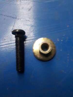

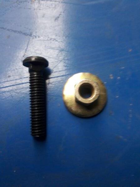

Usually a sharp rap with a hammer will break the swage and pop the studs out of the square hole. I've used carriage bolts to mimic the seat bolts and made a swage tool to stake them in place.
Would these help?

We reproduce both styles of the seat studs. You can use the push on flat retaining washers to hold them tight to the seat frame, but they do fit tight to the frame. Once you pull the seat down tight with the nut, they will not go anywhere.
The counter bolts coming from bottom the seats are bolted to seat frame. The hex head bolts hold the strip the seat and frame are attached to. The hex head bolts go through existing holes in floor. This is a 4" seat set back.
I want 4 of those! The wife’s Dart bench is to damn close to the wheel. It has a second set of holes about an inch forward that I can use to push it back!
