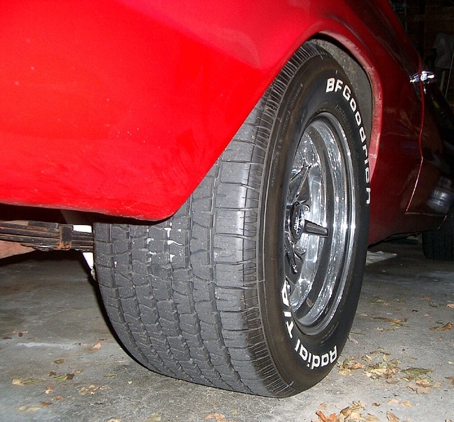

67 Mopar
I'm with my buddy Reed (Gpuller)... 295's are best on a 10"
I remember when you used to have a Charger...
farg'n flat landers.
Smart ***
When I get the Charger back on the road I'm coming over therefarg'n flat landers.
What do you think about 275's on a 10" wheel ? Very little bulge?those look proper. If you stuff a 295 on an 8" wheel you will not have a 295mm wide contact patch. I have a 275 on an 8" and it is as wide as my 255's on an 8". You lose width in the bulged sidewalls.
I`ve got a new set of 275 65 15 drag radials on 8" prostars- perfect fit. also got a set of 295 65 15`s on 8" prostars, gotta run w/ about 20 pounds to gettem close to being on the ground. less at the strip. (untubbed 68 barracuda)Here's a useful link. 275s on a 10" wheel should be way too stretched (and look like ricer wheels).
http://www.mickeythompsontires.com/strip.php?item=ETStreetSS
