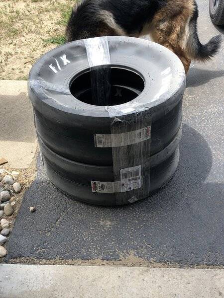

So in my usual way to try and fix things that aren't broke I switched from MT 31x10.5x15 slicks to Phoenix 29.5x11.5x15 slicks. They are almost the same size.
Anyone know if tire pressures would be the same? Currently running 13-13.5lbs

You'll be in the ball park. We are running Phoenix 29.5 x 10.5 and I think I was hovering around 14lbs give or take. So 13 would be a good starting point with the Phoenix.

First pass on somewhat green track, third pass on the Phoenix @13lbs 1.69, horrible. Couldn’t race like that. Put the M/T back on @13lb 1.53 wheels in the air.
I was going to put the Phoenix back and run a couple test passes but I was too lazy. I will run them again and keep trying.
