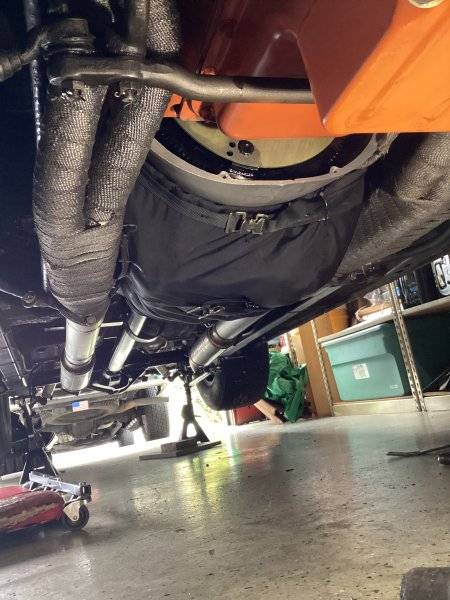

Here's some quotes that I'm surprised more who commented didn't address:
turn-downs at the rear axle that slightly faced each other.
Like topside, turndowns in front of the axle, 45° angle toward each other.
all the way out the back
to the rear bumper
WHERE the exhaust ends makes a huge difference in how loud it is and how it sounds.
Under the car like before or just behind the rear axle makes the exhaust pulses reverberate and somewhat echoes and amplifies the sound.
OUT the back, even with or just beyond the rear bumper or OUT the sides, even with or just beyond the lower edge of the car makes the sound quieter, no doubt.
Personally I loved the sound of opened cutouts on my Roadrunner because of the rhythm of the cam and idle speed ~900 RPM but didn't "sound" high-all relatively speaking.

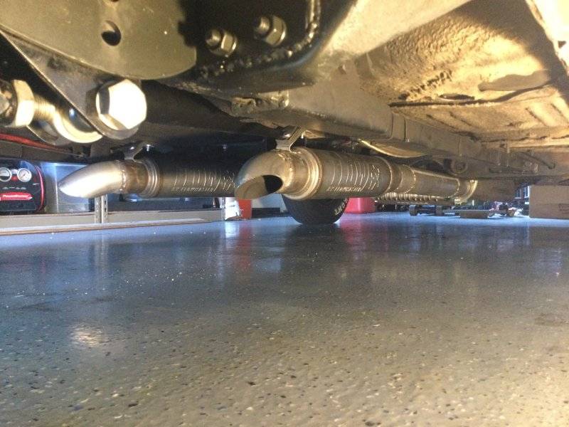

I'd swap those side to side, to point the turndowns at each other. That's a suggestion a friend of mine made a few years ago, and I did it to my Cortina. I liked the sound and they kinda smoothed out the tone. I was using 3 1/2 hooker aero's.
(Also blew less garbage at warm tires on the return road)
