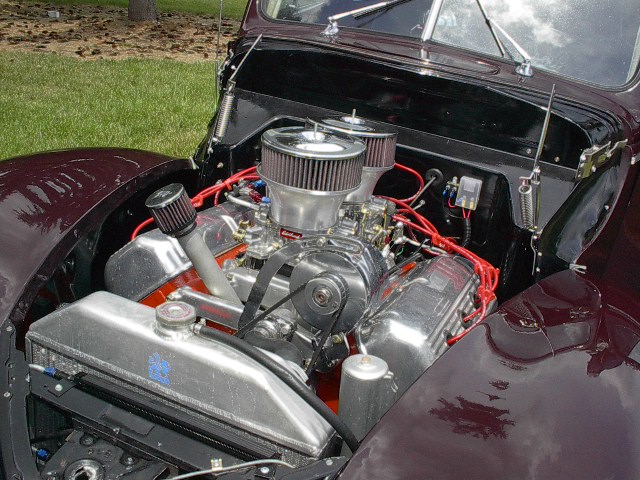

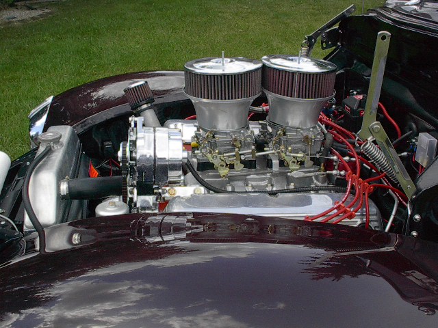

View attachment 127777View attachment 127778
I run 2 4's on my 392 hemi with progressive linkage. Not only is the idle great but the off idle performance is smooth. The gen 1 hemis came with 2x4's from the factory. And when you step on it and bring in the other carb it to me out performs a single carb. Yeah, todays carbs and intakes can outperform the older intakes with multiple carbs as some testing has shown but on the street it is the feel the driver gets that matter. And have driven them all, tripower, 2x4's, and single carb I like the performance of the multiple setups when tuned right.
Nice lookin ride.
