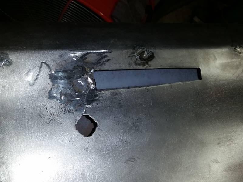

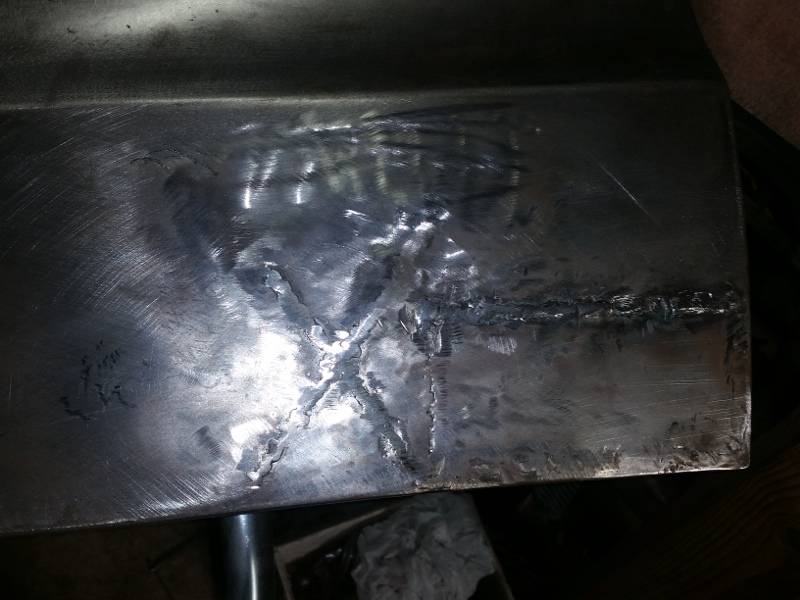

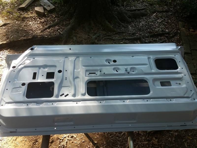

Errrr, I hate fighting warpage!!!Wishing my metal skills were a bit better, but I work with what I've got and I try to do my best . . . been fighting with this passenger door, and the patch that it needed in the lower front corner . . . and having all kinds of "fun" with the metal . . . but . . .
After another hour fighting with it tonight, I think I've got it where I can work with it now ! ! !
The "X" on the left was a high spot ( still don't have a clue "how" I managed to do that ) that I got corrected by cutting the X in it and re-welding the joints . . . it worked. However, the end result was that it pulled the panel in, and I did not want to put 3/8" of body filler in the area . . . so I fought with getting it pulled out and it's much better now . . .
