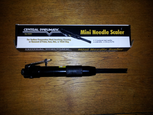

Needle scaler - test one . . . What is this and what can it do ? ?
THANKS H2E . . . all I can say is - let's take a look a sample test of this thing . . .
Here's an example of what this thing can do . . .
First, here's what a Needle Scaler looks like ( I've never heard of it before )

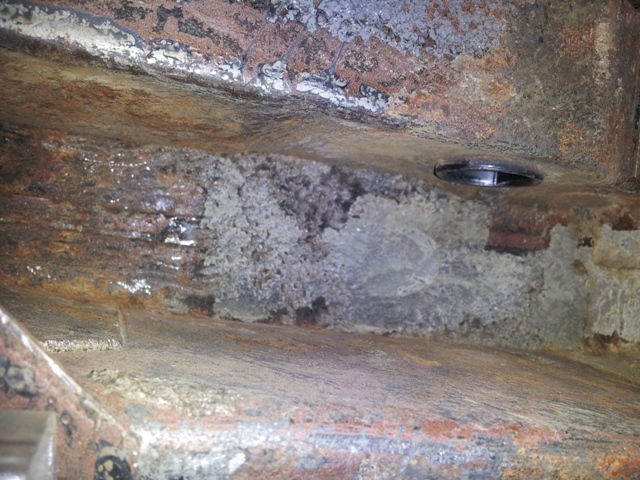

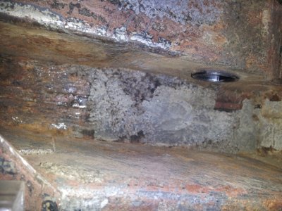

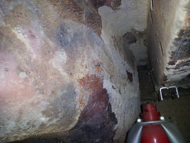

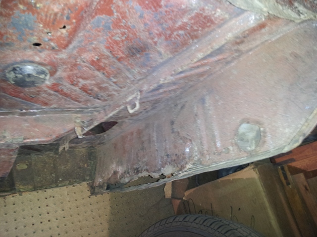

So I shot a picture of a part of a frame rail that had some undercoating on it for a quick test . . .
This is the before shot:
Less than 1 minute later . . . this is the after shot . . . same area

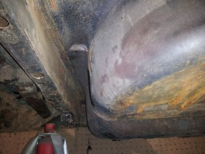

I just spent 2 hours tearing into the remaining undercoating left on the trunk area of my car and have this to report . . . The spare area - I was wondering "how" I was going to get into these areas to clean them up . . .
This is the before shot . . .
And they were not even a challenge for this tool . . .

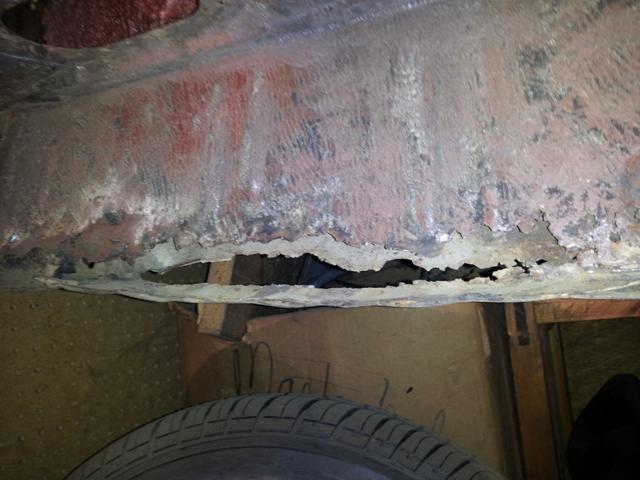

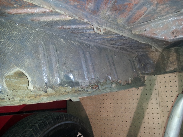

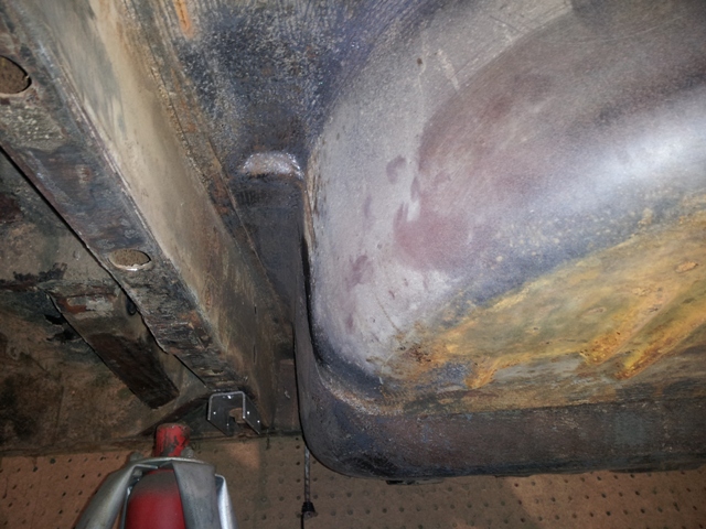

Trunk extensions . . . the before shot ( yeah, this is the driver side ) . . .
And after shot . . . on the passenger side . . .

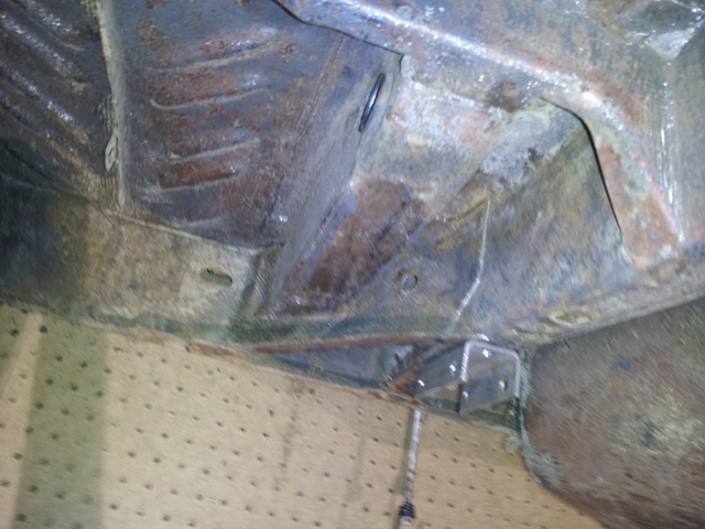

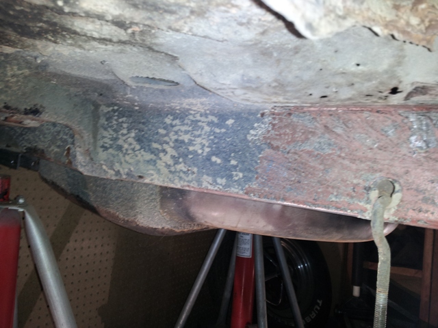

This is the frame where the leaf spring shackle attaches . . . the before shot . . .
And the after shot - even all the cubby holes have been cleaned out ! ! !

Conclusion - For $30 ( plus I used my 20% off coupon ) this tool is WELL WORTH it ! ! !
And it makes the job of undercoating removal "almost" enjoyable . . . I said "almost" . . . give me a break ! ! !

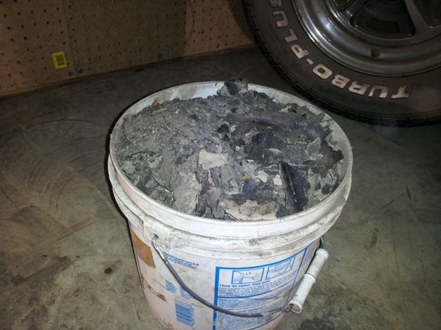

More undercoating removal . . . and bucket number 4 ! ! !

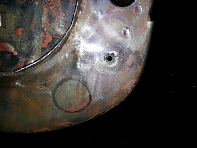

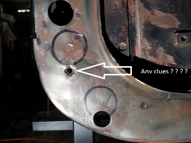

First thing . . . the core support I've been letting sit undone . . . is because it's got something that I'm not sure what to do . . .

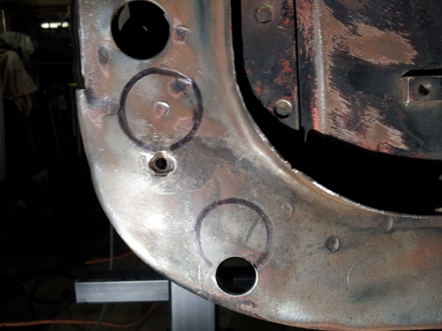

Here's the setup for the core support : marked the holes with marker for reference:
There is a threaded hole on both sides that will be covered by the core support.
Any ideas what goes into the holes ? ? A lot of the car was disassembled when I got it . . .

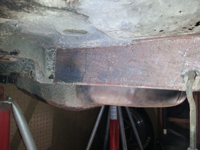

Here's a nice example of a cubby that needed to be cleaned . . .
And the results of the work with the scaler - maybe 2 minutes total . . .

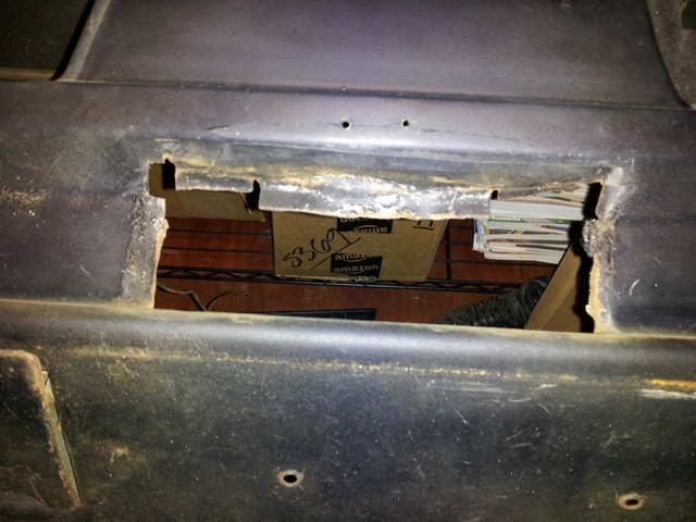

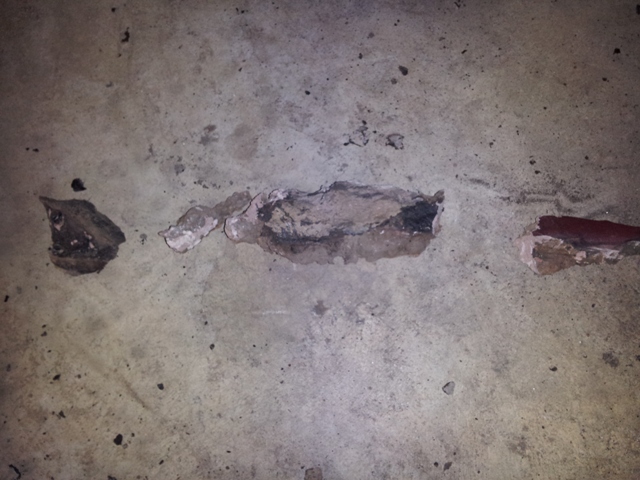

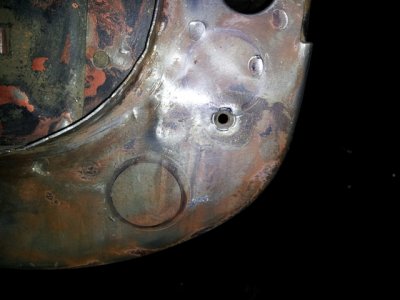

Cleaning the driver side I pulled these big chunks of bondo out of the side of the car . . .
Which was shoved into these holes and painted over to hide the damage . . .
No biggie . . . I'm going to get the thing fixed the right way this time.

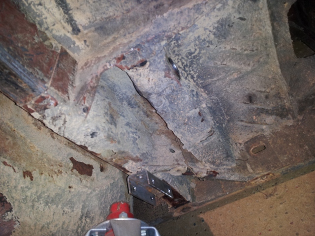

Had the mother load of undercoating in here . . . 1/2 inch thick in some places . . . it was THICK
But the mess has been all cleared out now - take a look ! ! !

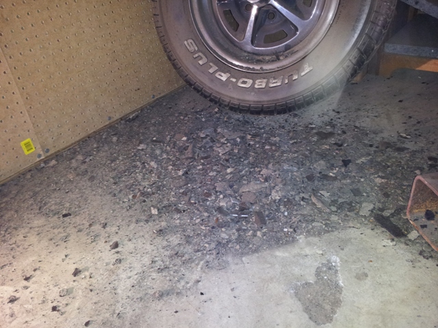

And the load of undercoating that was removed . . . 1 1/2 hours work . . .
And . . . we've gotten a full bucket number 4 ! ! ! Almost time for the final weigh in ! ! !
Got about another hour of final touch up and clean up . . . and I'll be DONE with undercoating removal. The sad thing about it that this scaler would have probably cut my time on removal in half . . . if not more ! ! !

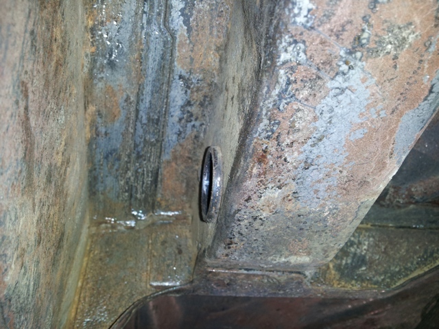

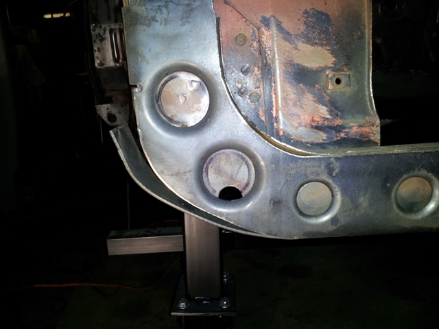

HELP . . . I have no idea what this hole is for, but it's kinda in the way of my new core support.
Can anyone show me a picture of what attaches here ? ?
I've not attached the core because I don't want to lose these holes if they are needed . . .
They've got me baffled . . . anybody know ? ? ?
Just guessing but given where they are "maybe a fender brace"????????? Most fenders have a rod connected to the bottom fronts to stiffen them.
