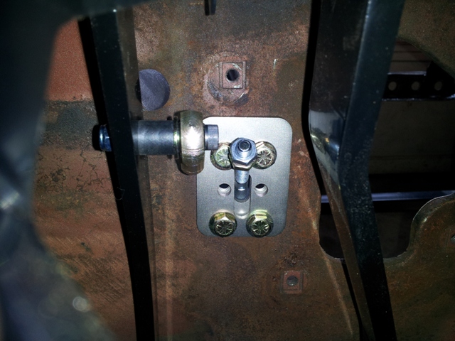

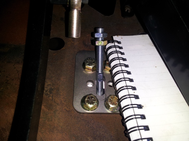

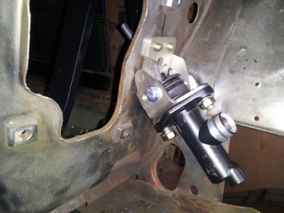

Still trying to figure out how to get the hydraulic clutch setup installed . . .
Got the master installed . . .
However - if I use the existing hole in the clutch pedal for the connection - I've got a bit of a mismatch on the alignments . . . 2 views . . .

I think with all the surgery and cleaning up your doing in the engine compartment I'd just put it exactly where it needs to be to be (just another hole to fill). Sucks to hear they're still d#cking you around.
I was beginning to think the exact same thing 747Mopar . . . and a little more welding practice to boot ! ! !

I'd definitely put that master cylinder where it belongs instead of in that exiting hole. I would have expected to see a pamphlet or something with it that said where the new hole would need to go. Also note to self, once you get the trans in the car and connect everything with the hoses I would make sure you take it back apart and bench bleed the system all assembled. (ie master cyl, hose, slave cyl). The problem with those is the orientation of the master cylinder traps bubbles of air in the master instead of encouraging them to come out. Went through bleeding mine 4 times to get it perfect but also ended up having an issue with rod length (not a custom adjustable master like yours).

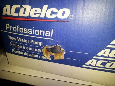

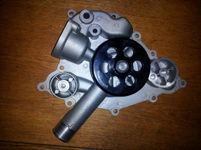

Parts delivery . . .
Got home to a box sitting on the front steps . . .
Was a little worried after opening the outer box to see this on the inner box . . .
But I inspected the water pump - especially the area that would have poke through the box - and all looks to be just fine.
I did not like the fact that the old water pump had all the white residue, all initiating from the pulley seal area . . . safer ( and easier ) to replace it now.
