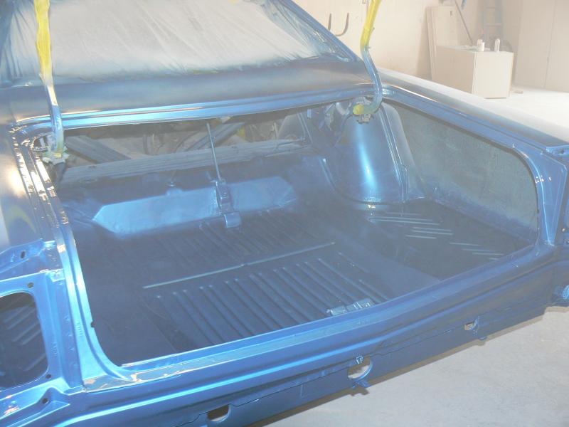

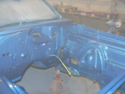

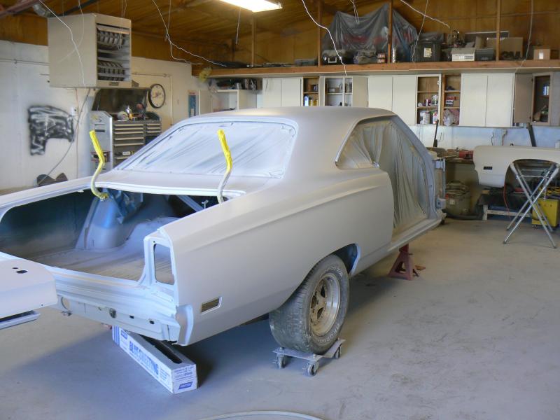

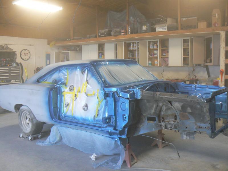

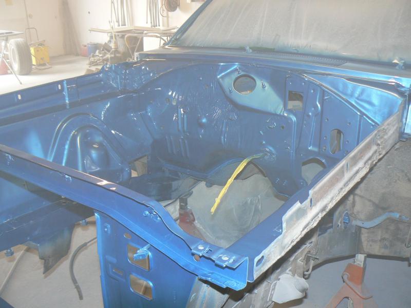

Have done a little more on B5 blue.

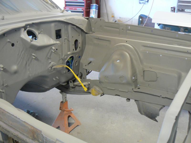

Looks good!
Question for you though. What are those wrinkles under the wiper motor studs? I'm not criticizing at all...just curious. I have them too and have no idea how they got there. Mine are on my right hand inner fender. The only thing I can think was the car was in a fender bender at some point and it buckeled the inner fender. Do you just hammer / dolly those out?
from when the sheet metal was stamped in the press
Wow...it's amazing what I'm learning on a daily basis. I guess I'll just leave them there then. Thanks!
Sorry to highjack your thread....you have a beautiful ride.
Looks good!
I had never even paid attention to them before. But went out and looked at my other 69 RR and it also has those.
Like Snakeyes said, originally there from the factory fella's....Not any indication of past damage. My '69 has them as well. Bird's looking great!

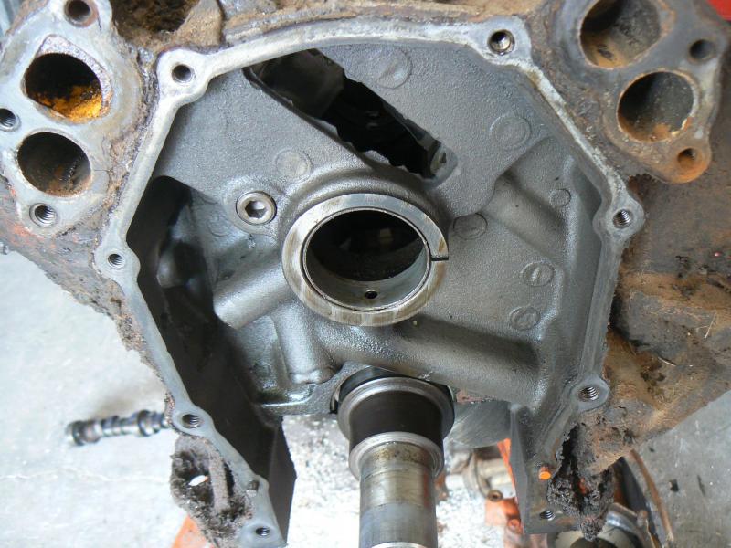

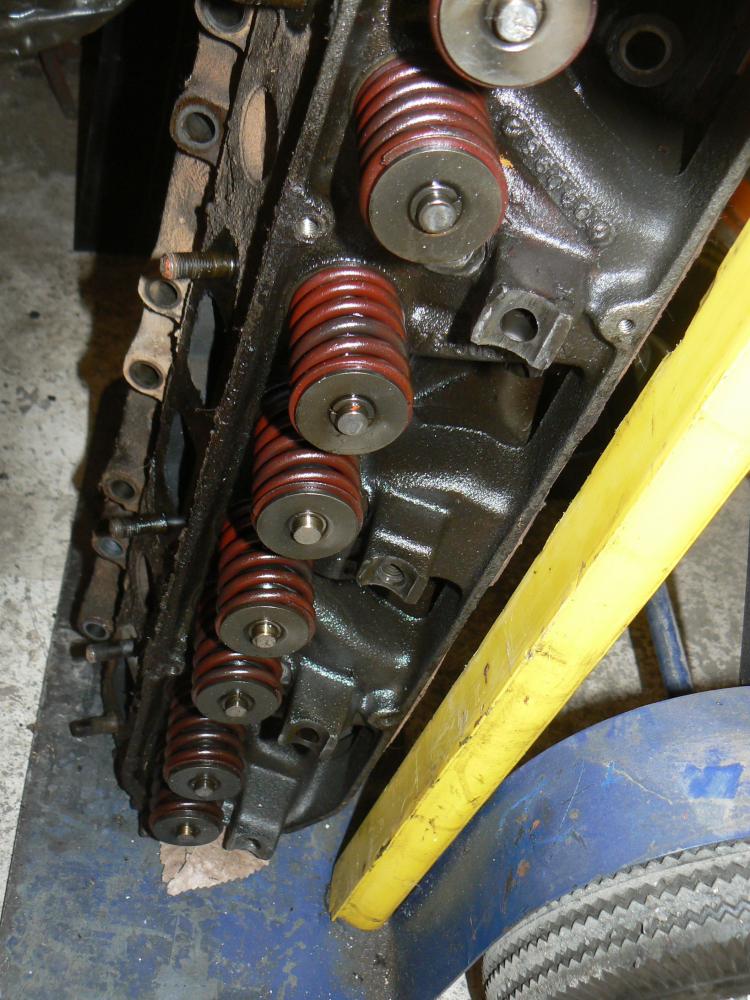

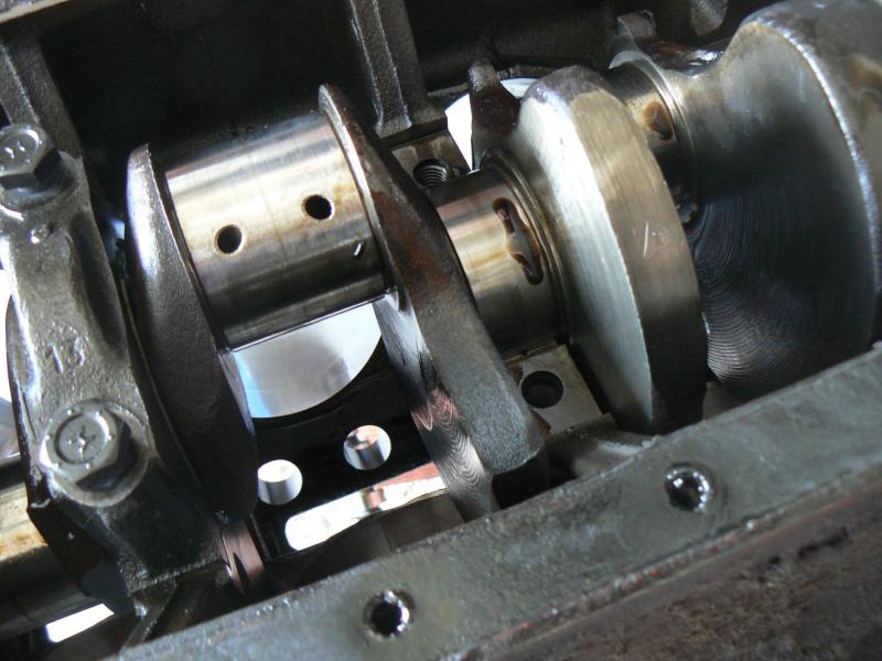

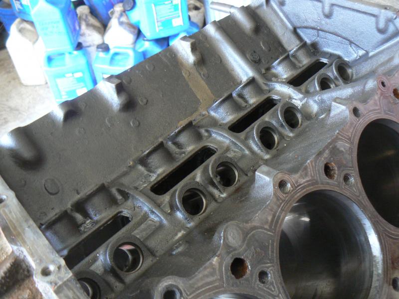

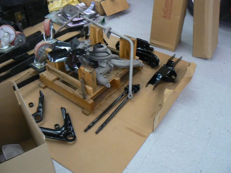

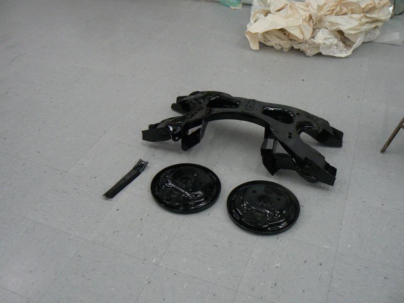

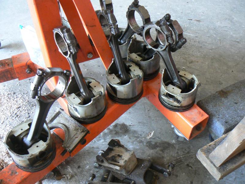

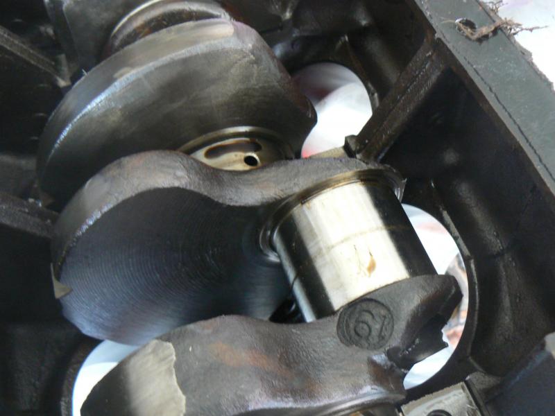

Got some parts back from the powder coaters today. Also started the tear down on the 383. I don't know what kind of oil was used in this, but look how clean it is. The worst tapper or out of round is .003, so I am going to keep the stock bore and just re ring and put new bearings. The car has 106,000 miles on it, and shows little wear.

RR looks real good, sure sounds and looks like someone took very good care of that engine! Nice to find that with all it costs to do everything.. Good luck.

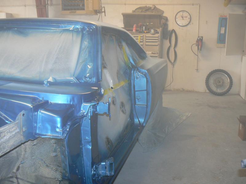

Added a splash of color.

That bird is going to be a beauty!!! Nice shade of blue,,
