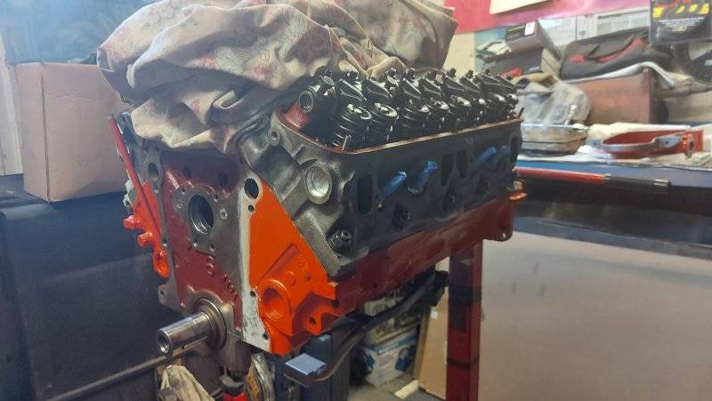

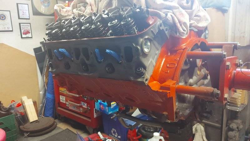

So since I'm in a waiting for parts (cam & lifters) to come in period I might as well get the engine ready for the final paint.
Since the cylinder heads have been a bare casting till now.....
I brushed on some primer.
Then I put the front of the engine back on (without gaskets) as those pieces need final paint too.
Finally I put the oil pan on, again with no gasket.

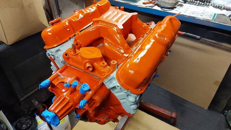

I had the sides of the intake shaved as there was a fitment issue with them with the cylinder heads being shaved.
Total amount removed from the sides was 0.050" which is the thickness of the intake gasket.

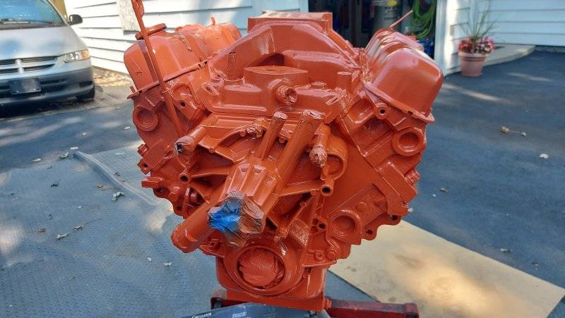

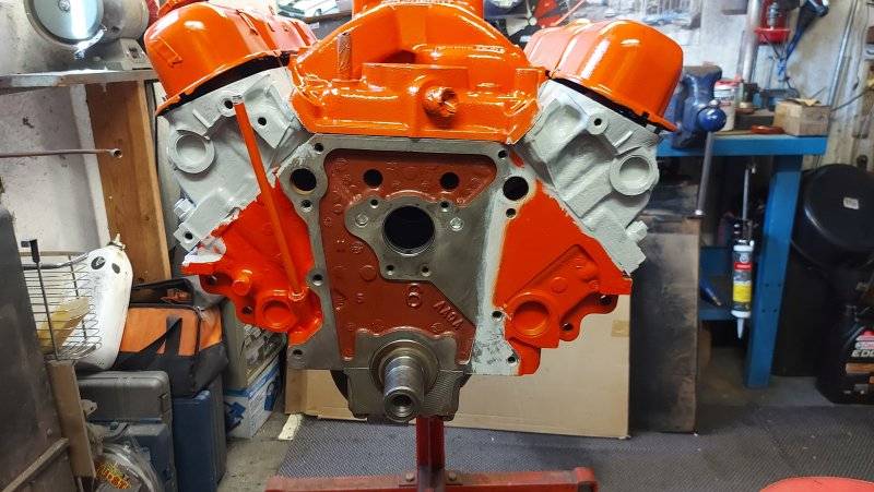

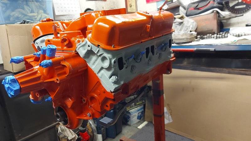

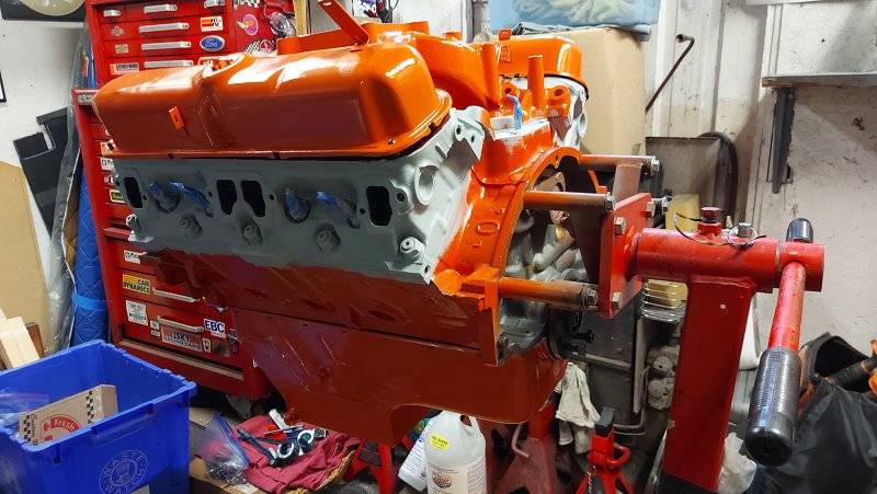

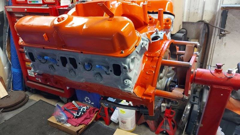

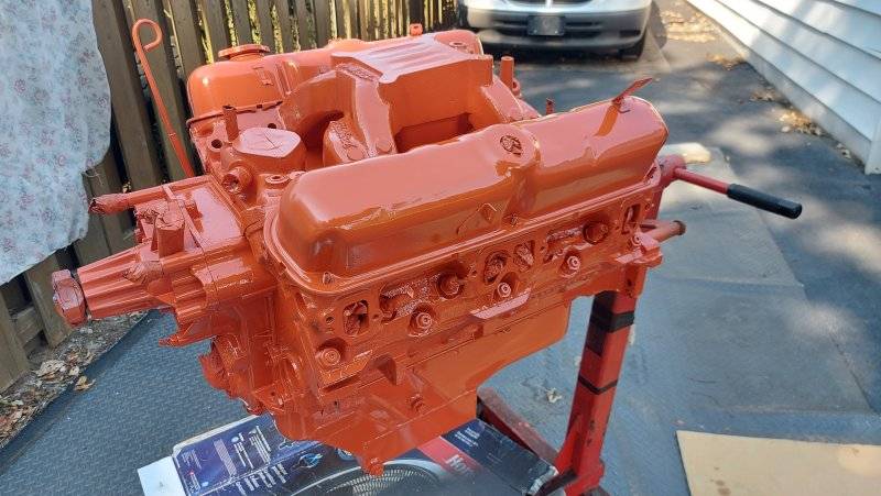

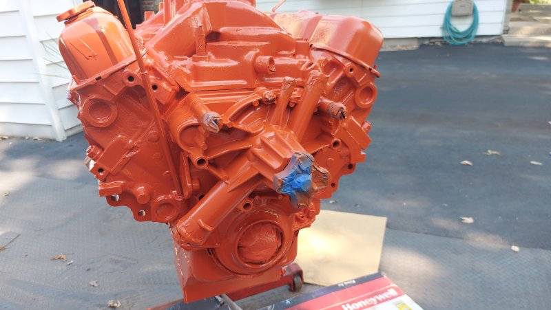

Yesterday I was able to get some paint on the heads and the rest of the engine.

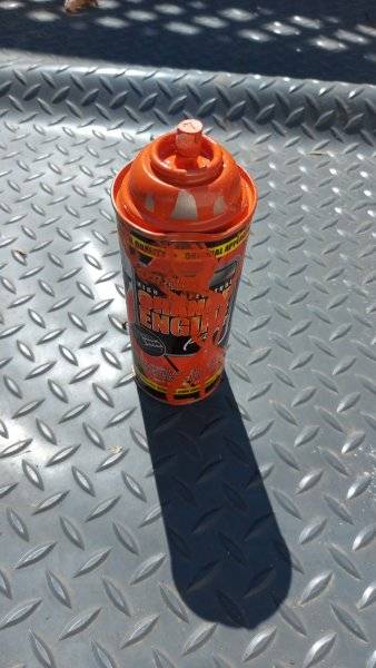

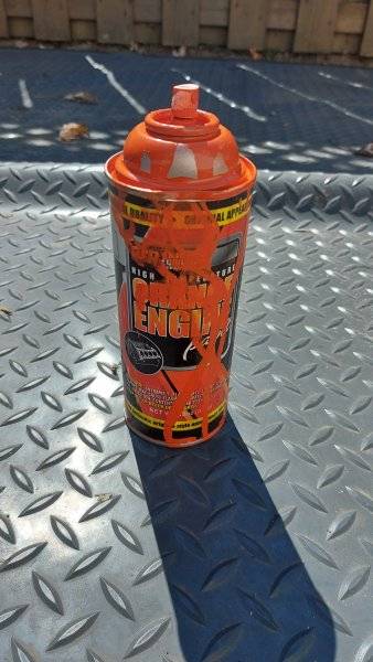

I used the OER orange paint. More of it got on the outside of the can than on the engine.....
But the end result was good.

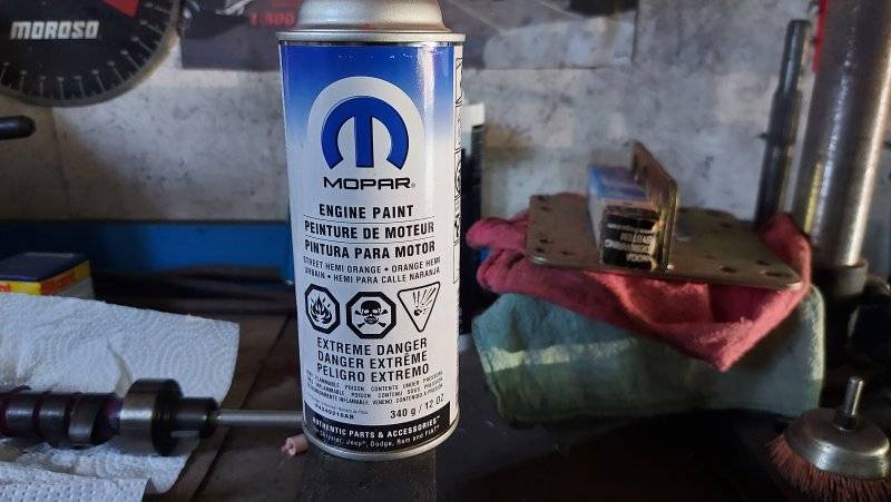

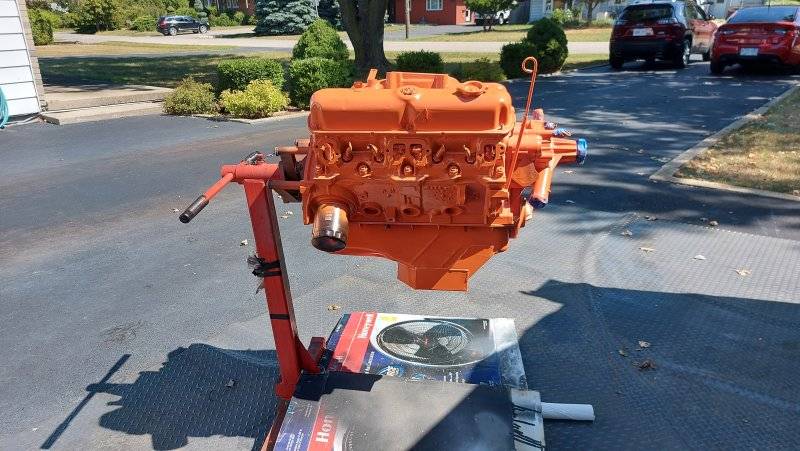

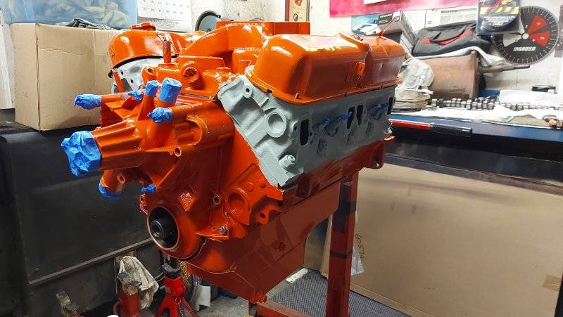

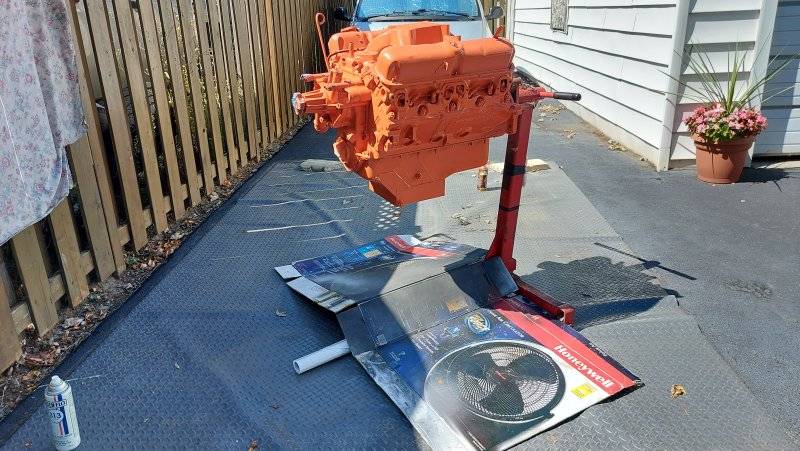

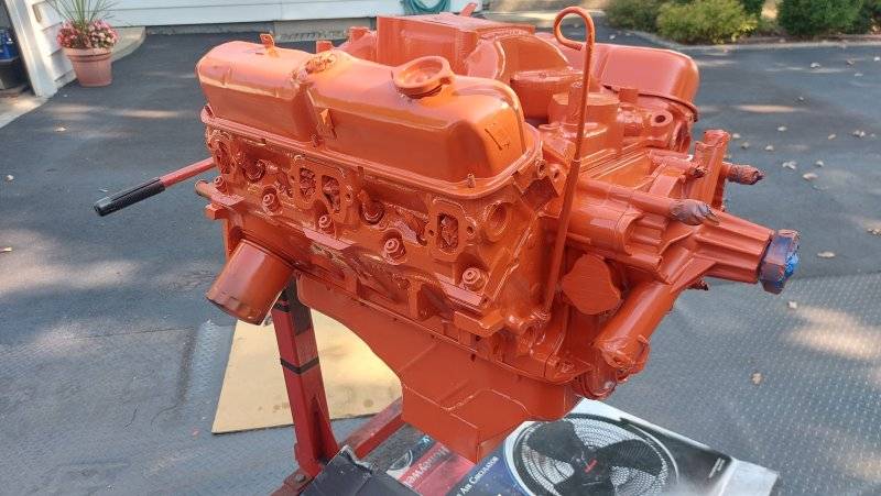

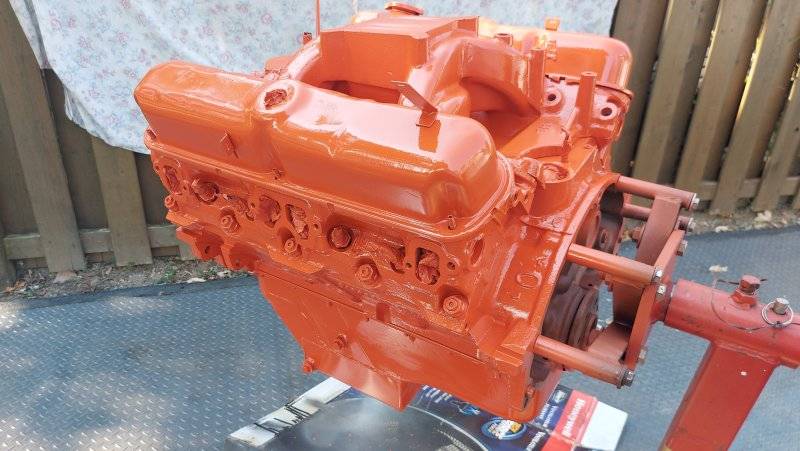

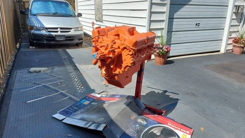

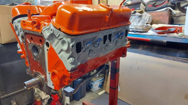

Earlier today I was able to get the final coat of paint on the engine.
This time I used this.
No issues with the can this time and the result was great.

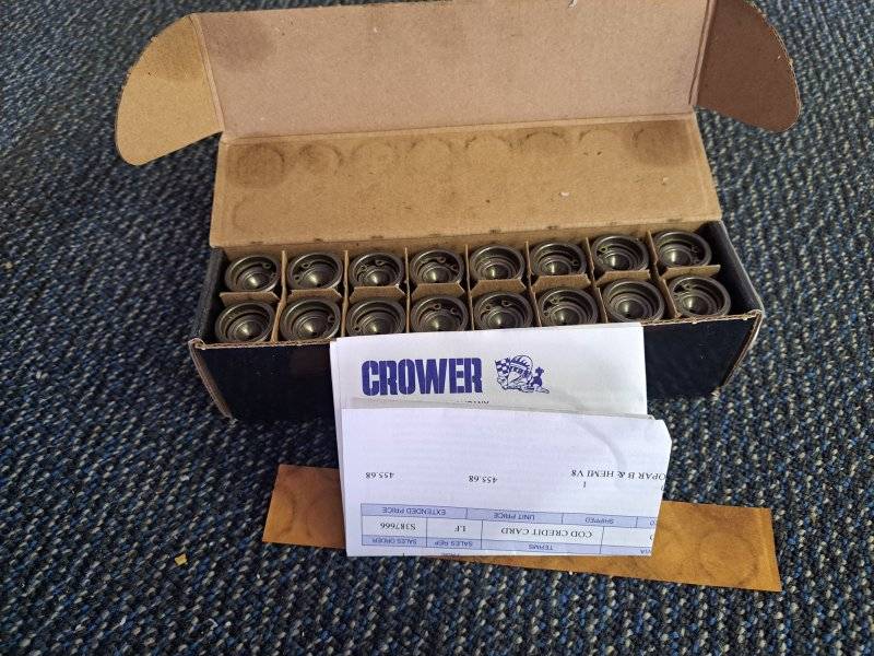

So I get on the phone with Crower lifters and talk to their tech guy, Louie.
He says they will manufacture a set of their lightweight and cool face (EDM hole) solid lifters in 2 to 3 weeks.
So I place my order with them.

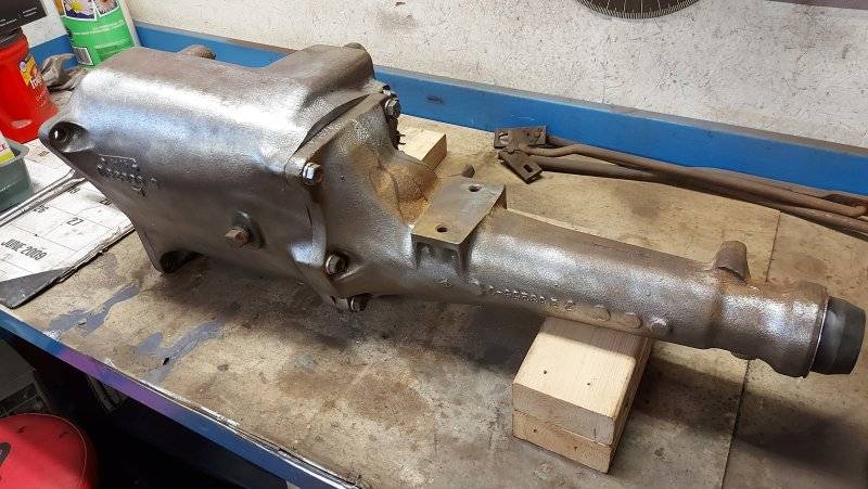

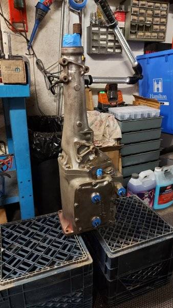

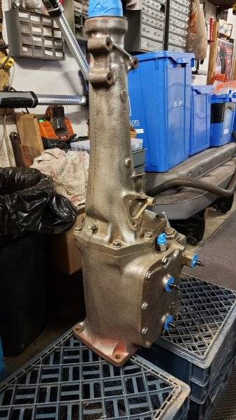

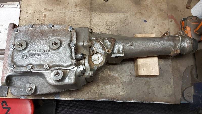

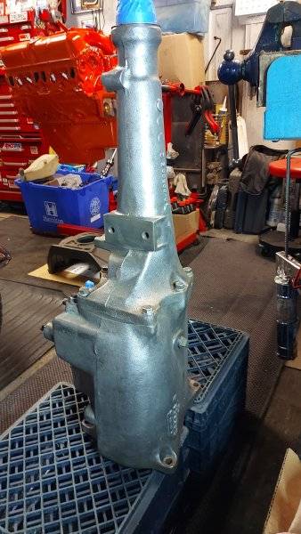

In the meantime, I cleared off all the crap that was on my work bench and unearthed my 4 speed tranny.
Might as well get a start on cleaning it up.

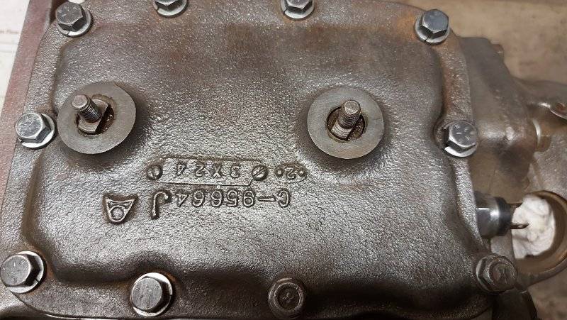

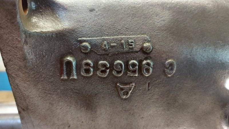

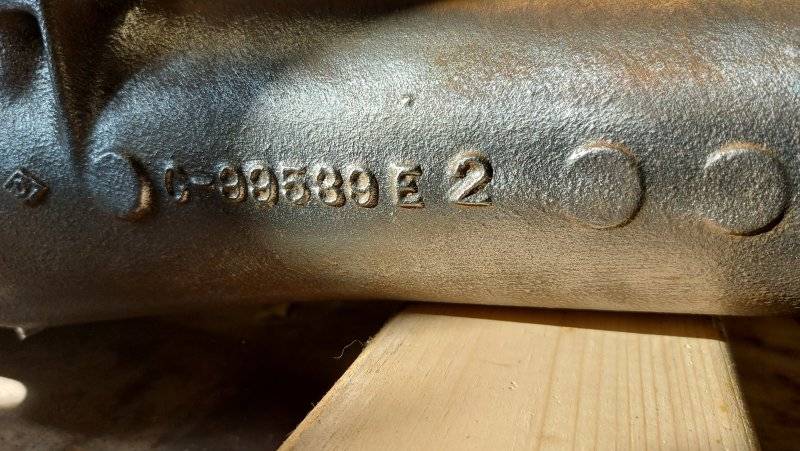

Can anyone here identify it?
It does not have the machined pad on the passenger side.

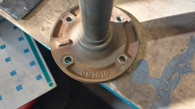

The only casting numbers are these....
I went on the Brewers website and found out from the part number on the bearing retainer indicates its a 1969.
Getting it ready for the first coat of primer.
And here's with the primer.

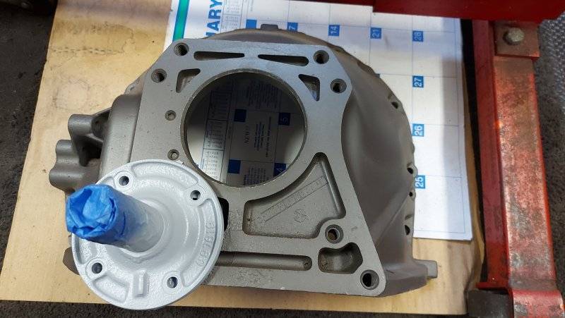

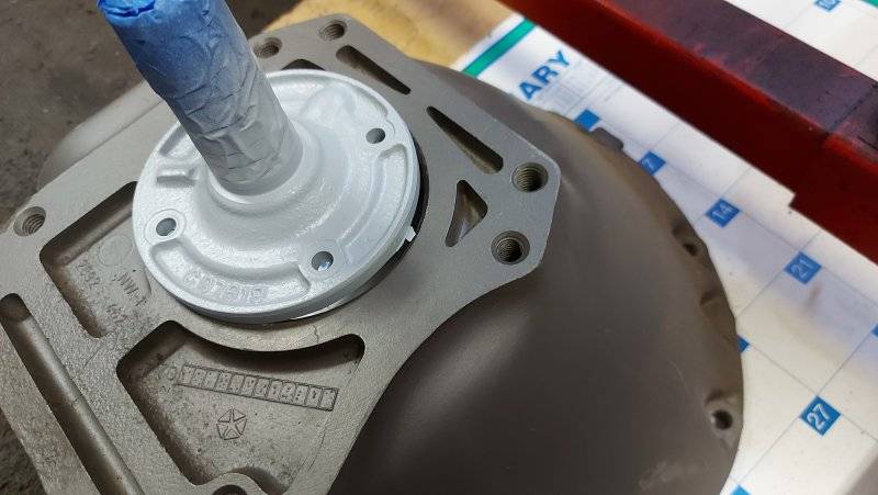

I brought down my bell housing from the attic to get it ready for paint.
But I thought I might want to see if I have the correct bearing retainer for said housing.
Guess what??? NOPE.
So I ask - besides getting another bearing retainer is it possible to machine this one down?
Or can the opening in the bell housing be opened up?
Okay, so I ended up ordering a new bearing retainer thru a local Mopar distributor up here.
Here it is next to the oversized one.

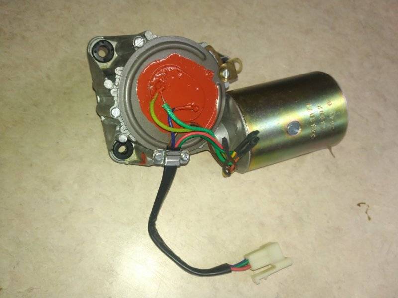

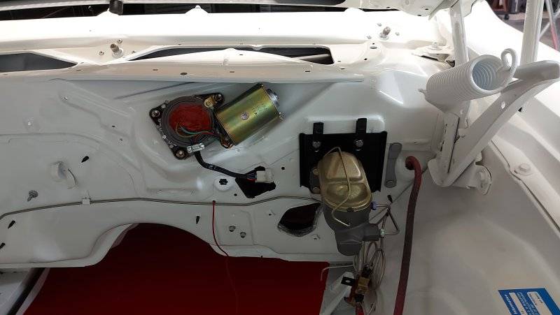

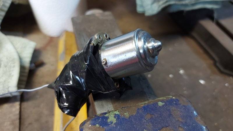

Next, I was able to find a 3 speed wiper motor which I bought and took to have restored.
I just got it back last night - she's a beauty.
And here it is installed.
And finally, my solid lifters have also come in - good news.
Now I just need the cam to arrive as well as the new dash pad.

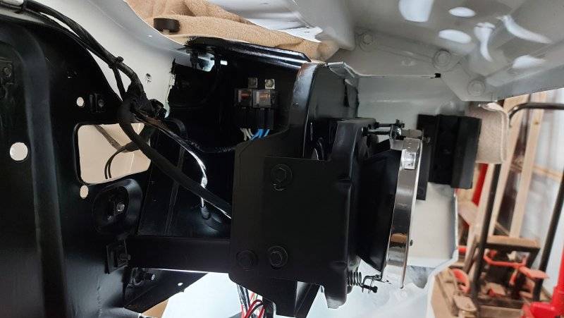

So after a bit of a break and while I'm still waiting for my dash pad to arrive I went and installed the new headlight wiring harness I bought thru Year One and manufactured by M&H.
Then I put in the long splash shields that go right up front.
Passenger side.
And the drivers side.

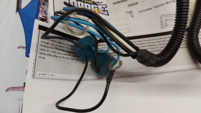

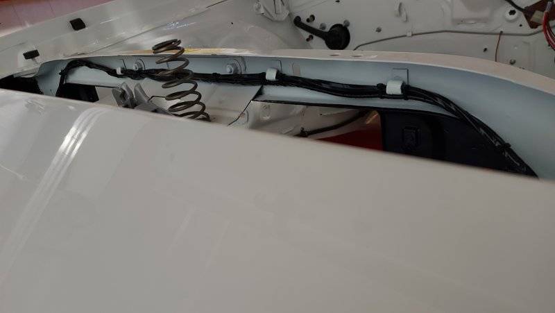

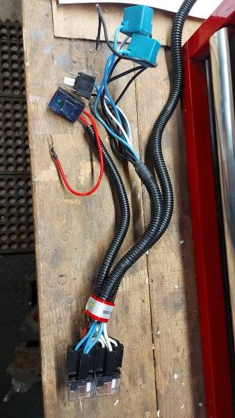

Finally, I also bought a headlight wiring harness many moons ago off E-Bay (way before I heard about the kit member crackedback has).
I removed the plastic wire covering and retaped with proper harness tape.
I hid the relays on the driver side behind the headlights.
And ran the wire across the rad support zip tied to the main headlight harness.
When I purchase some actual headlights I'll plug everything in, plus run a power wire from the starter relay.

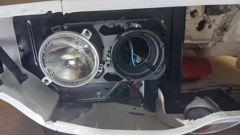

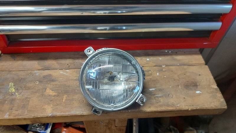

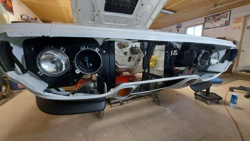

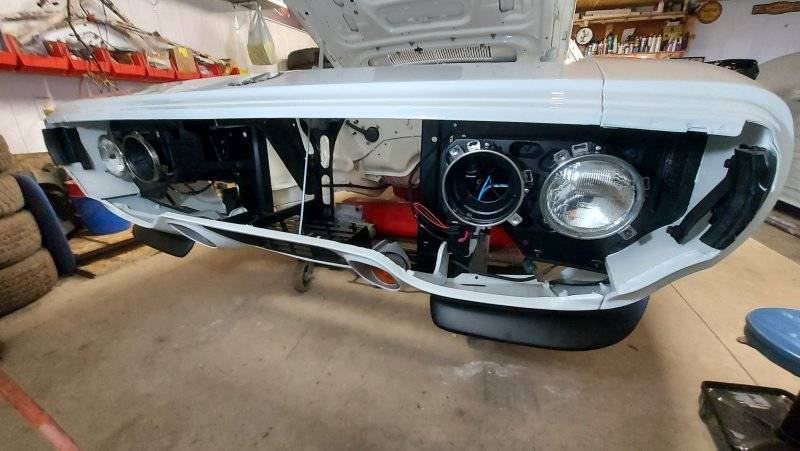

I was able to find a set of low/high beam halogen headlights.

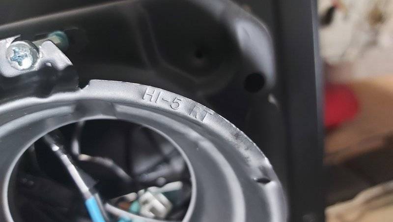

But, as I went to install them, they were not lining up properly with the headlight buckets.
Upon closer inspection I find that I had put the headlight buckets in the wrong locations after painting them.
Apparently they are actually marked for where they are suppose to go.
So after rearranging them in their proper locations I could install the headlights and buckets together.
Then do the install.
Here's the finished product.

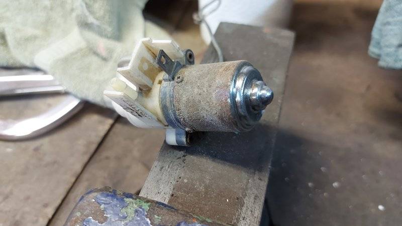

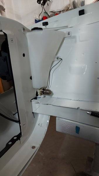

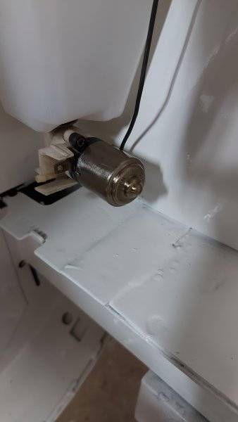

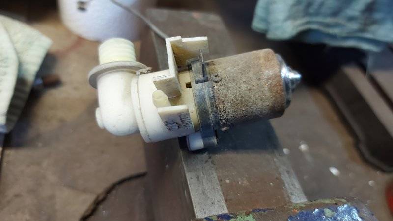

So continuing on, I found the original windshield washer pump.
The washer bottle had a big crack in it and was very brittle, So I bought a reproduction one at my local Mopar car show.
The pump itself was looking ruff, but it does work (I tested it).
So it's time to give it a clean-up.
Right down to bare steel.
Next I'll give it 2 coats of clearcoat, then install on the washer bottle.
Doing that, now it's back in the engine bay.

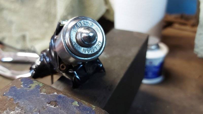

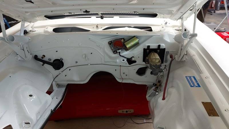

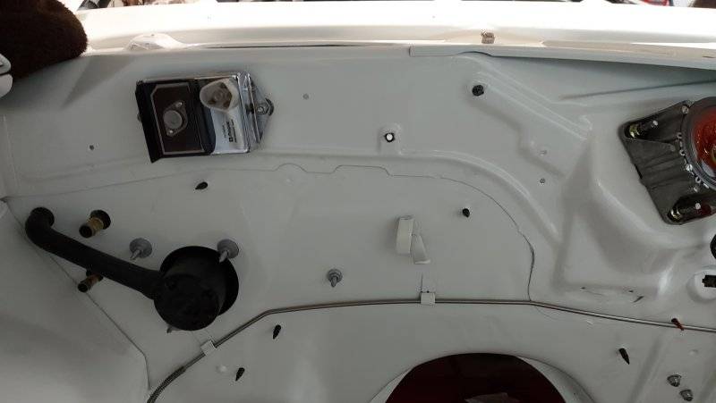

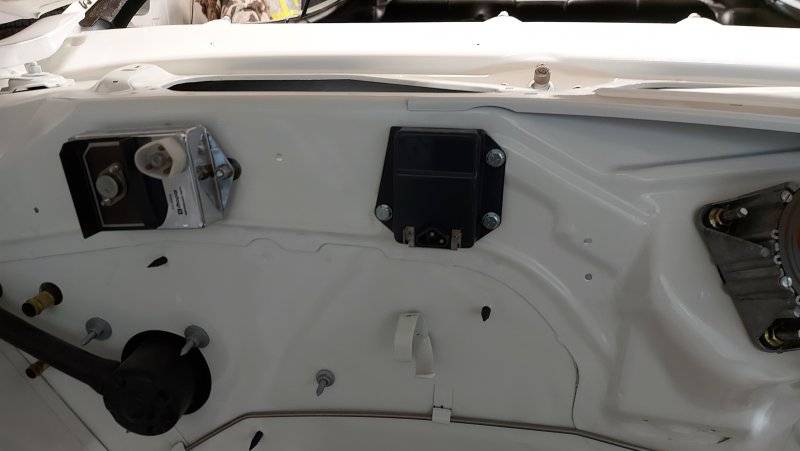

Next its time to mount some accessories in the engine bay.
First is the chrome ignition box.
Next is the voltage regulator.
Here's the firewall as it looks.
I still need to mount the coil and the throttle cable and the beep beep horn.

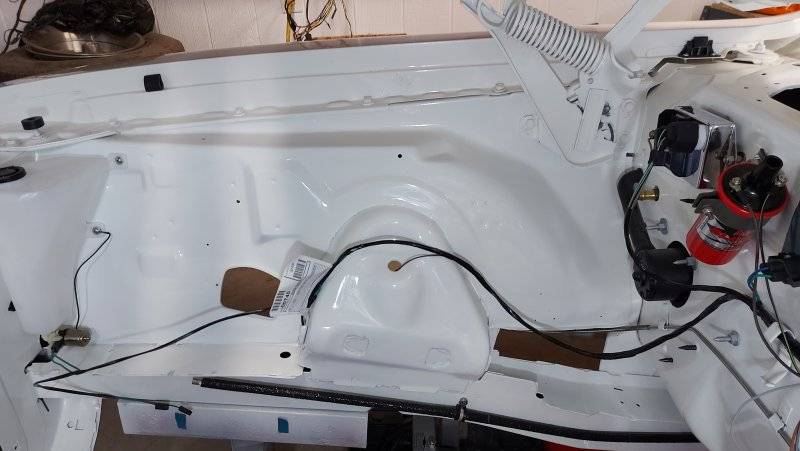

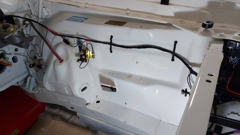

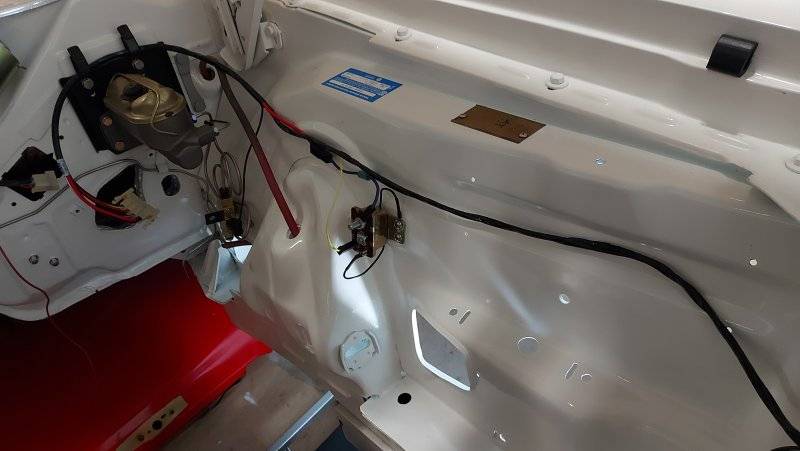

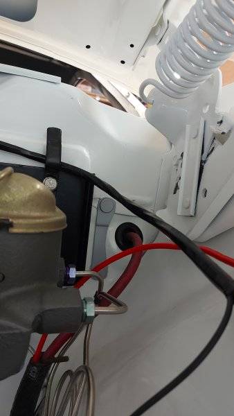

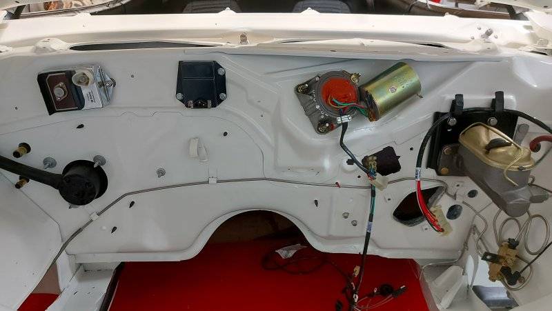

Today I was able to mount the coil and the ballast resistor as well as the throttle cable and hook up the wiring harness to all the bits.

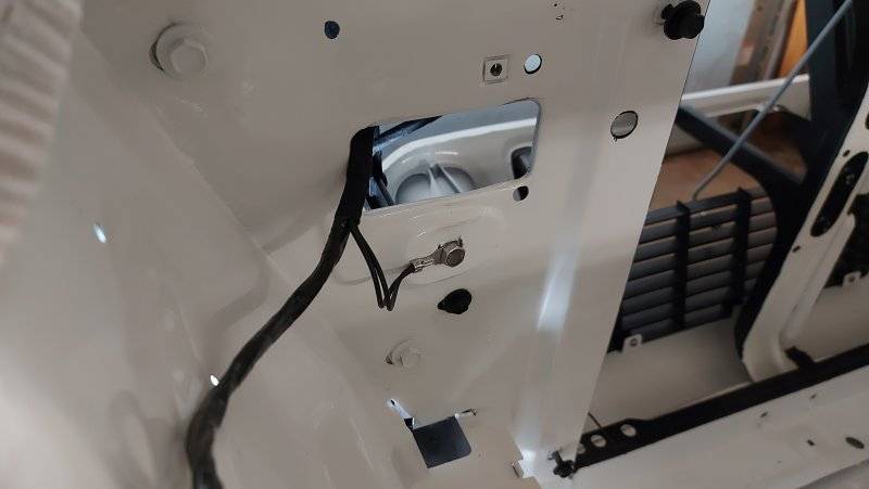

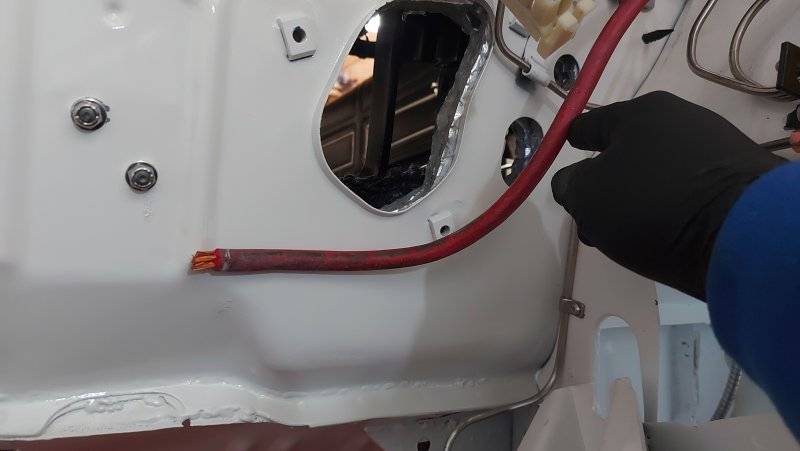

I also provided a positive feed wire from the starter solenoid to the headlight relay harness. I wrapped the feed wire into the existing wiring harness that runs to the front of the car.
Here's some more of the wiring harness used on the passenger side.

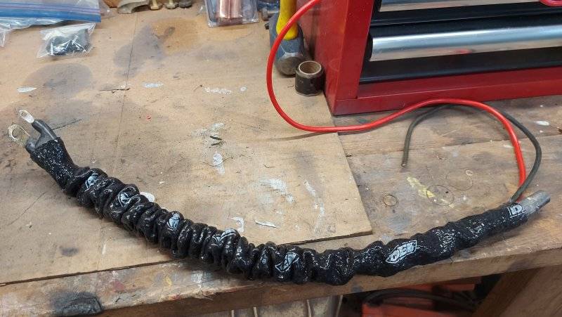

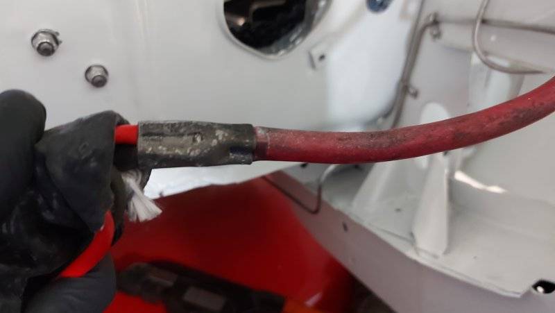

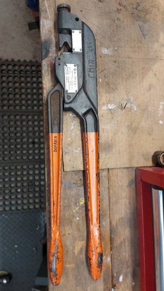

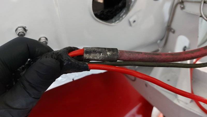

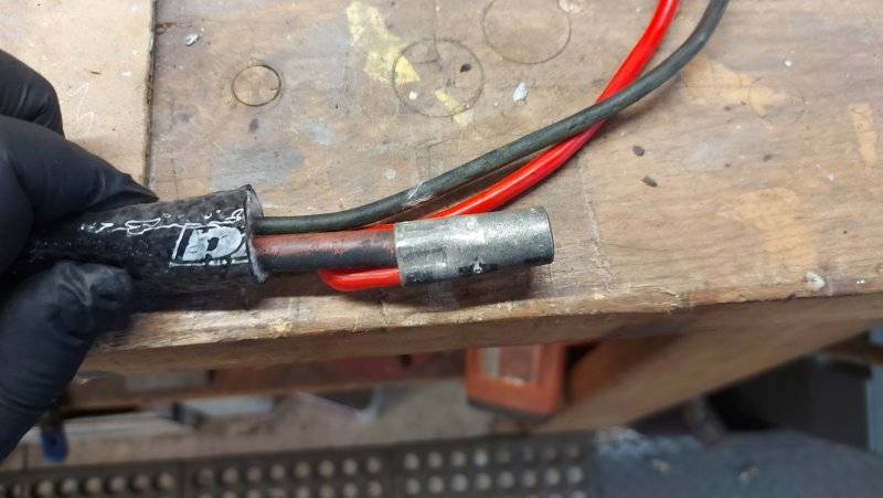

Today I was able to finish up the positive cable that runs to the starter.
Since I'm leaving the battery in the trunk, I needed to connect the starter cable to the battery cable.
So, I borrowed a big *** crimper from my good buddy Lloyd.
Then, cleaned up the battery cable end.
Now the starter cable end along with some DEI heat sleeving.
Here's the big butt connector on the starter cable side.
Now the whole thing together.
I left the smaller 2 wires that run to the solenoid longer - when the engine is in the car and the starter hooked up I'll be able to finish up those two smaller wires.

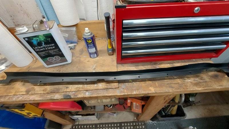

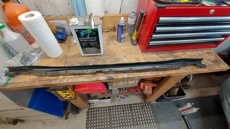

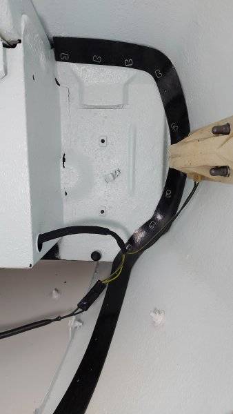

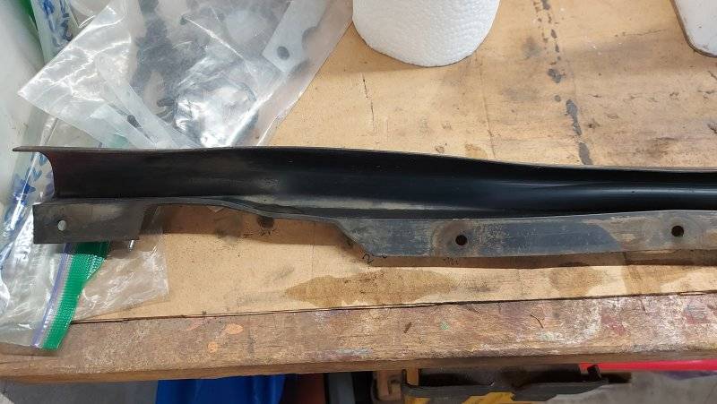

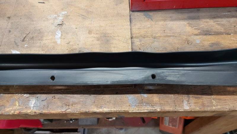

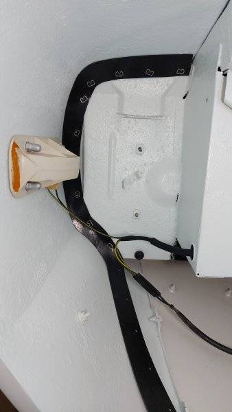

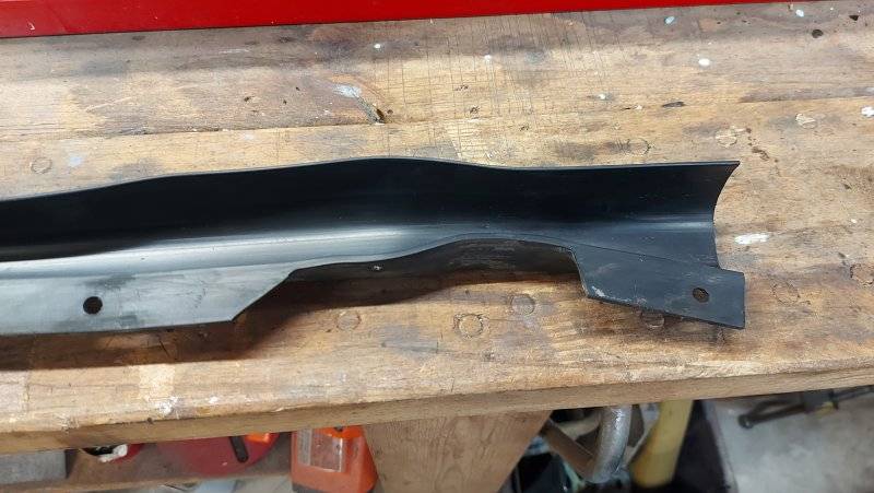

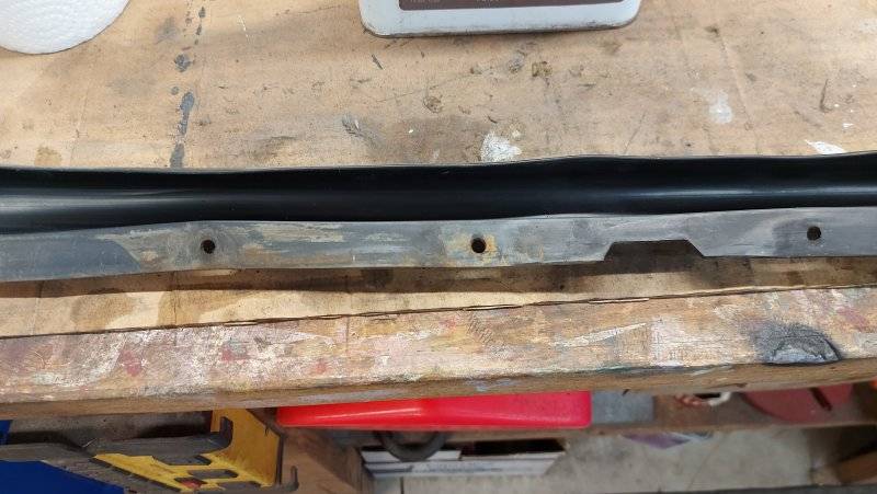

After that was done, I tackled the under hood to rad support seal.
The original one wasn't broken or ripped, just dirty.
So I used a combination of lacquer thinner along with some WD40 to clean it up.

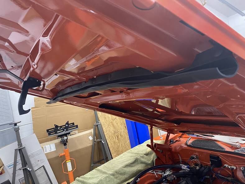

So far so good....Now if I can remember how the thing is mounted to the underside of the hood.
Any members here with pics of their seal mounted?
The flap faces forward and it mounts on the front of the hood lip.
