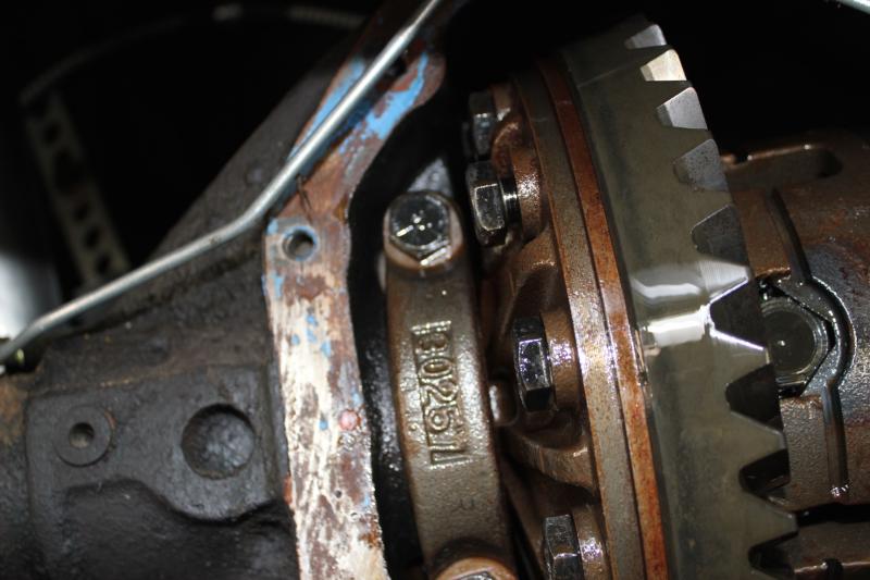

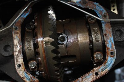

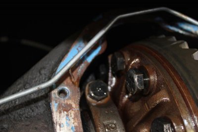

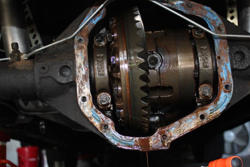

Project today consisted of changing rear gear oil out and inspecting carrier and axels to see what I've got under the cover in the Dana....
Thank god I did this now!!! In the pics below you can see 1 of the 3 ring gear bolts that is 90% unthreaded... I shudder to think what would happen it it worked its way out any further.
The good news is I had thought I was going to have to change carriers since I have 4.56 gears, I was assuming it was a 5 series carrier, but it looks like someone used a gear shim on a 3 series and since I'm hoping to go with 3.54 gears I should be good. (Please someone more knowledgable tell me I'm interpreting that right?)
Also, I don't know 1 carrier type from another.. Anyone recognize that carrier? Powr-Lok maybe? I will also post in the appropriate section of the forum... I'm headed back out to the car shortly to tighten up the ring gear bolts. when I do, I will have to spin the rear wheels and maybe I can get some numbers off the carrier.
IMG_9489 - 2015-05-03 at 12-29-16.jpgIMG_9490 - 2015-05-03 at 12-30-57.jpgIMG_9487 - 2015-05-03 at 12-29-02.jpgIMG_9488 - 2015-05-03 at 12-29-09.jpg
Thanks to some research and helpful posts on another thread, it looks like I have a 3 Series Power-Lok carrier, which is great news as I won't have to replace it to go down to 3.54 gear set.
I'm going to re-torque the loose bolts and get it off to a shop, for the gear change, sometime in the next 30 days hopefully.
