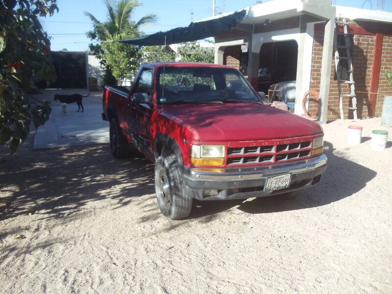

Did it myself, '96 Dodge Dakota (3.9L five-speed 4X4), STP oil filter, Castrol 20W-50 motor oil. After the engine warms up, I hear a slight rattle (and I can't remember now if that is a new sound or one that has been there for a long period of time).
I needed a breaker bar to remove the drain plug, and half-destroyed the oil filter trying to remove it (filter access on a 4X4 is limited). I can only assume my local quicky oil change guy uses gorilla strength on that stuff.
20-50 is pretty high viscosity for a 3.9
Yours is the age where the converter can fall apart inside and rattle. When that happens you lose performance as the exhaust is restricted

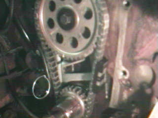

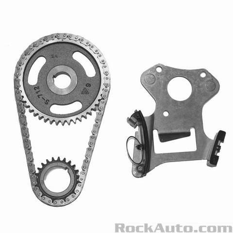

Timing chain tension-er rattle.
There is no tensioner.
At that price, you are buying your oil and filters at the wrong place.
The noise you hear may also be the injectors firing.
When I bought my 93 Dakota 3.9l the chain was hitting the cover. (no tensioner)
I bought the chain and tensioner from the dealer for a 99 I think and they were pretty reasonably priced.
It was pretty snappy after i put it back together.
