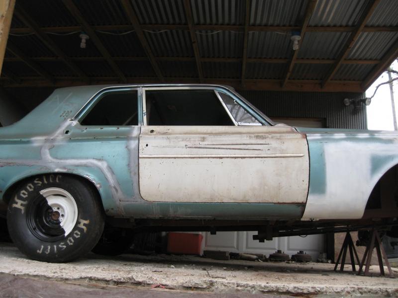

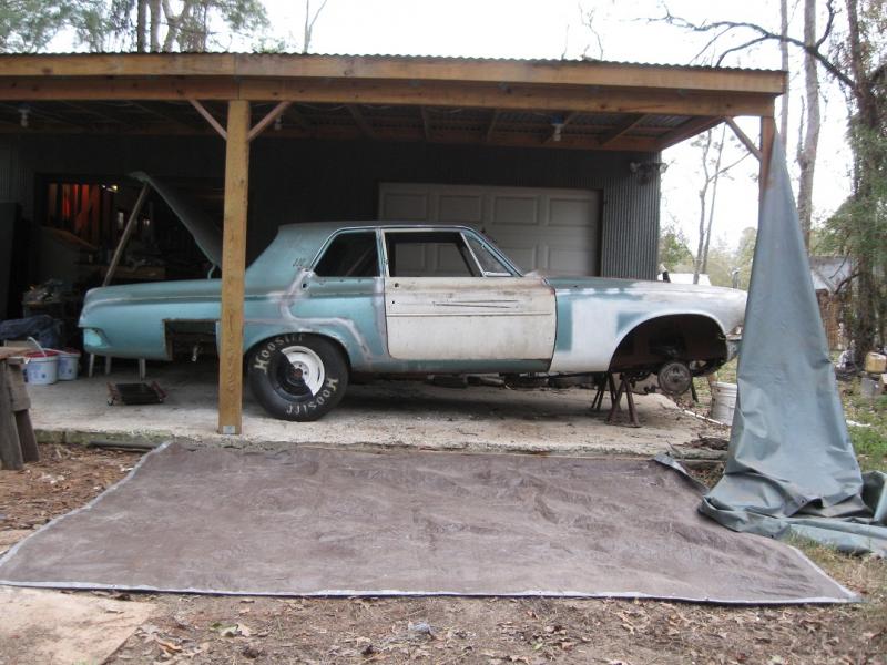

my 63 2 door conversion alterd

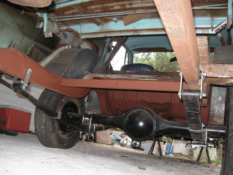

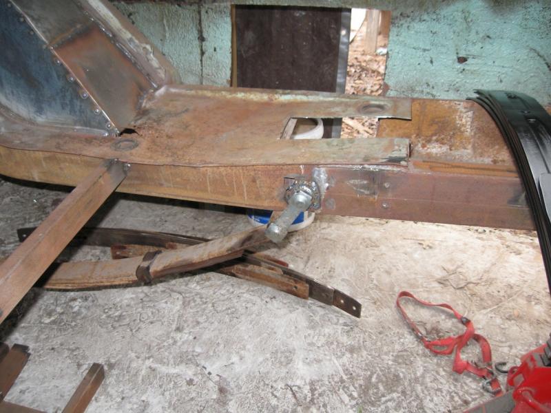

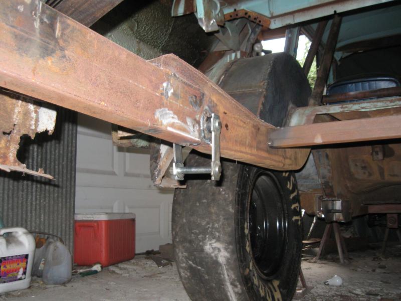

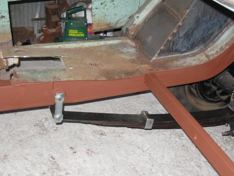

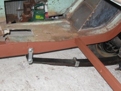

picked up a hole saw for the rear shackles and a center bolt for the springs hopefully tonite i will have some time to get to it

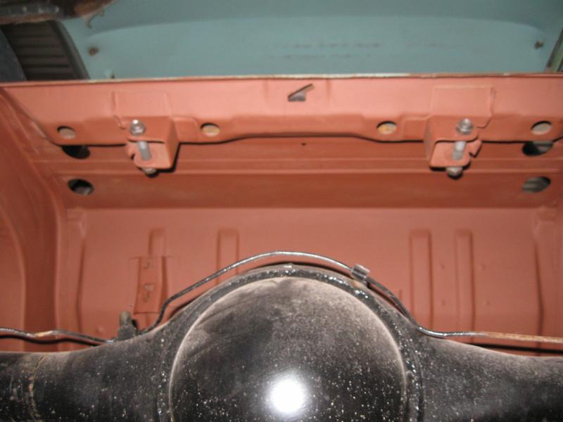

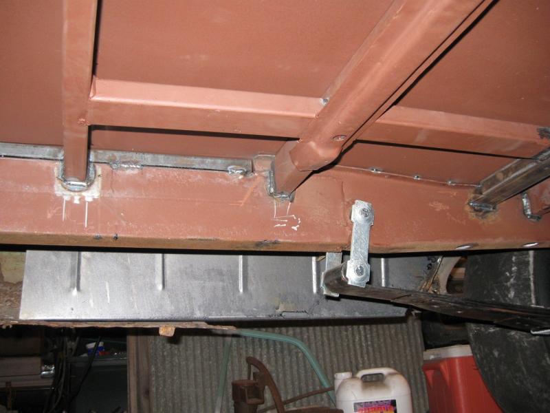

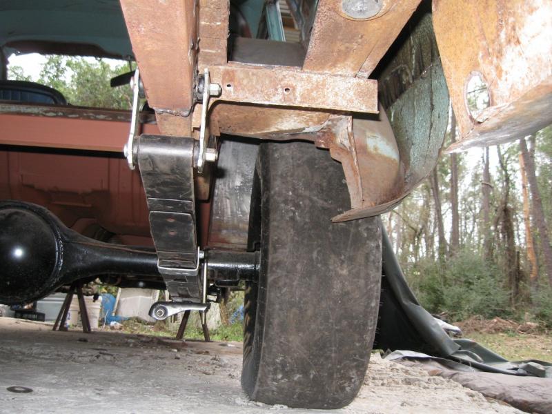

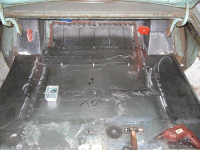

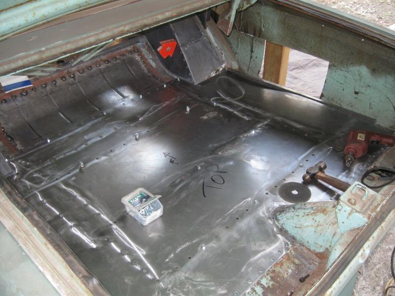

update

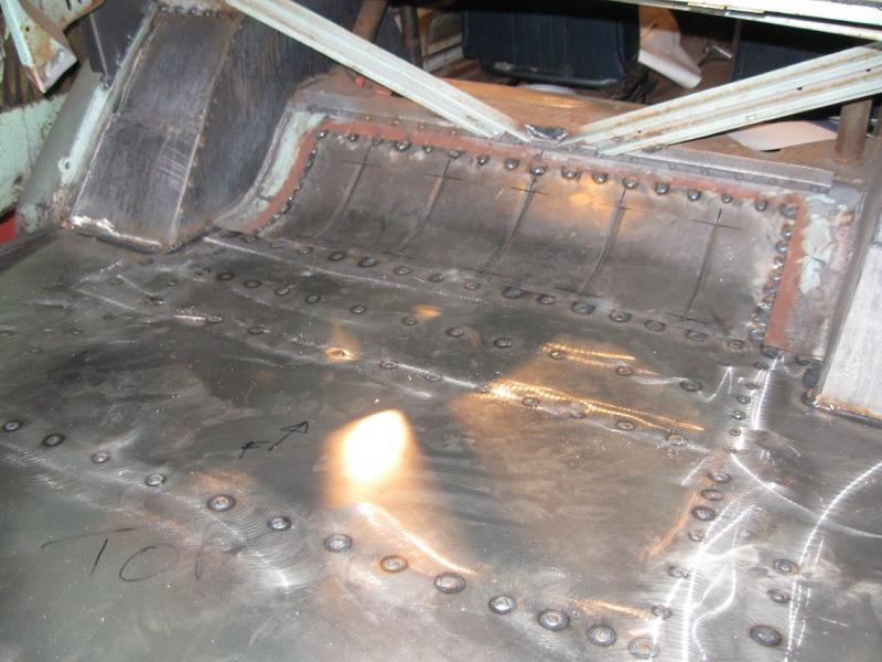

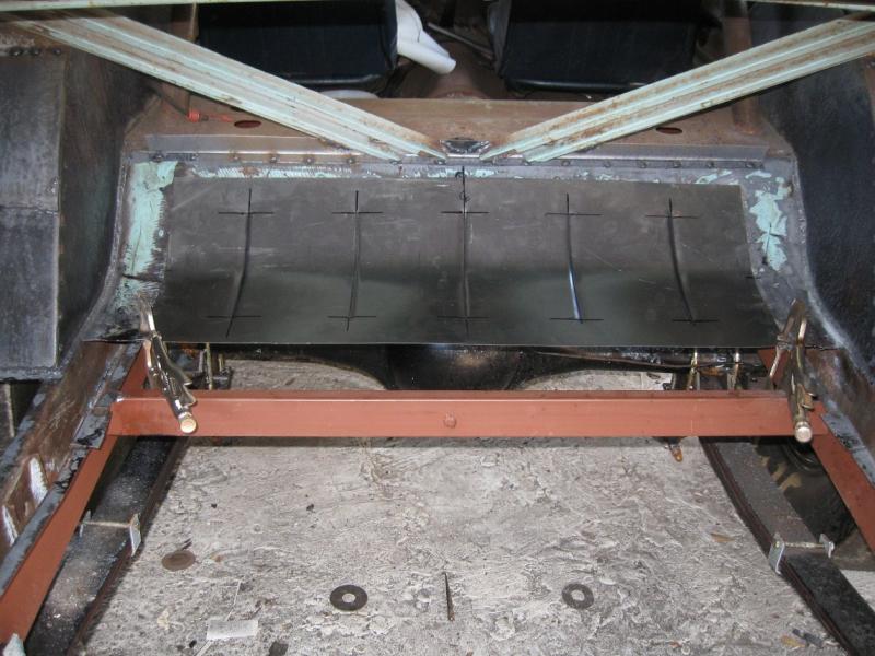

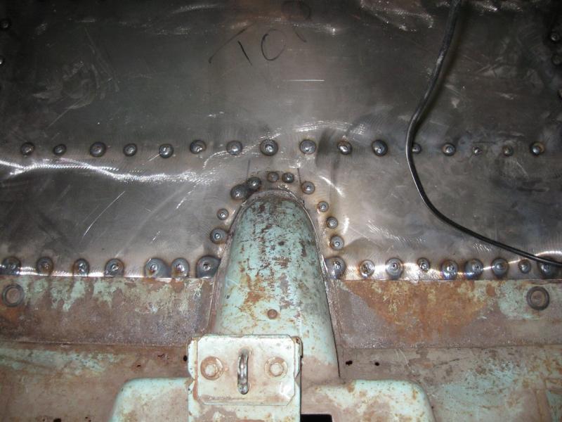

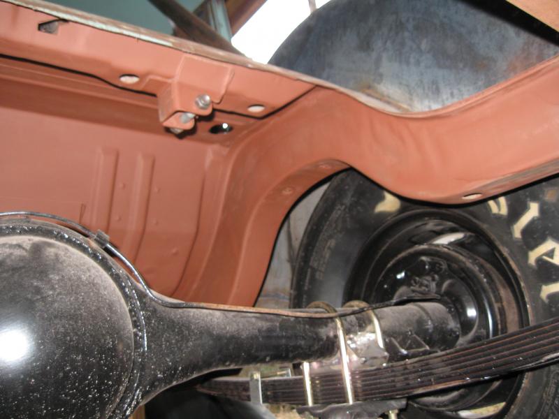

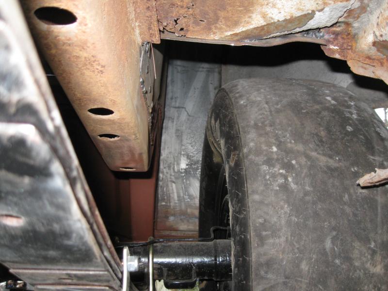

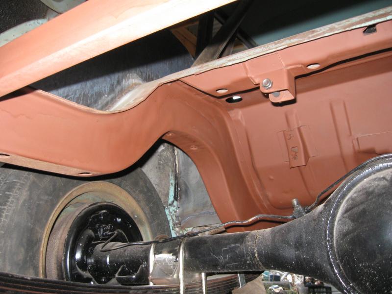

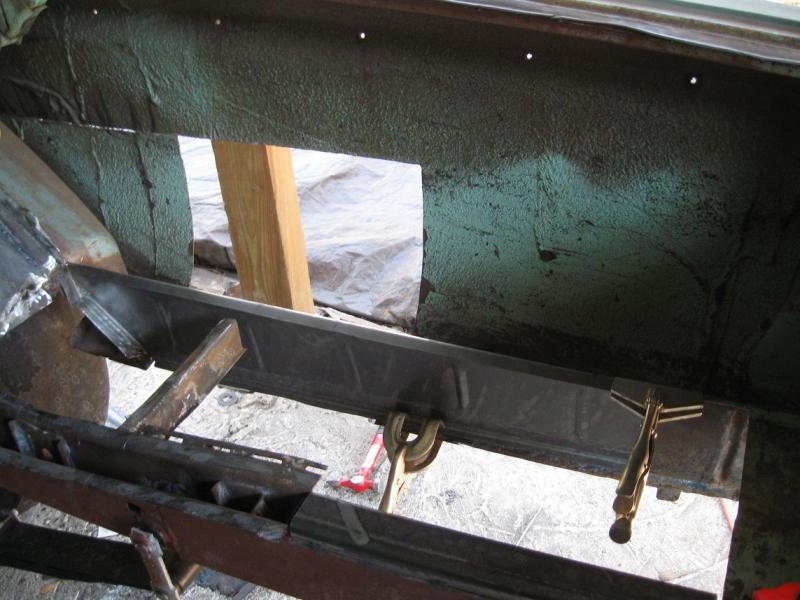

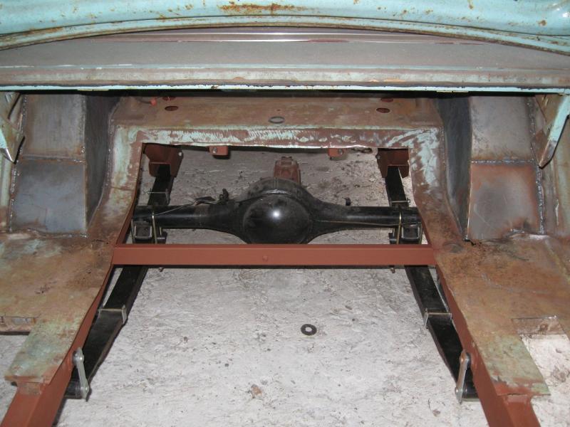

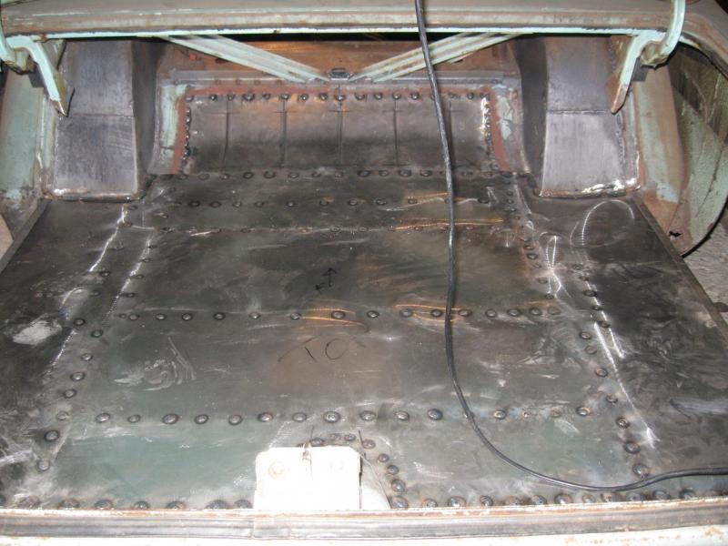

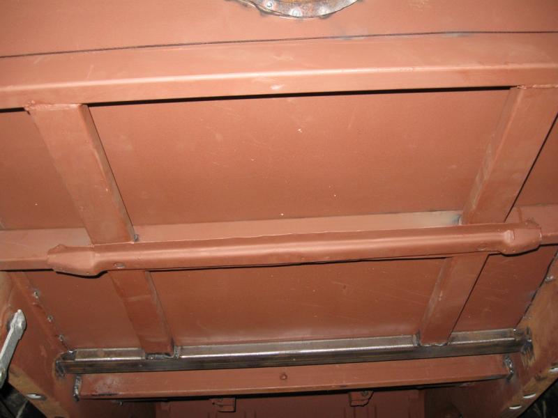

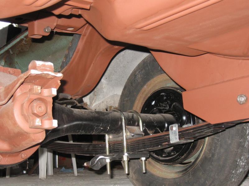

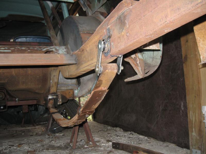

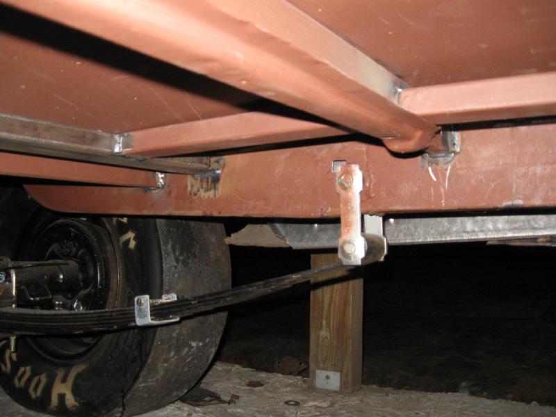

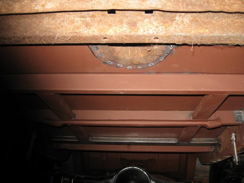

got the rear shackles welded in ,removed the mounting for fuel tank i think it was over kill its getting a re think ,now got to finish the clean up and paint the under side before the rear goes in .then i can figure out back spacing and wheels IMG_1572.jpgIMG_1570.jpgIMG_1573.jpgIMG_1570.jpg

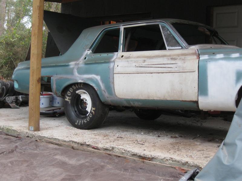

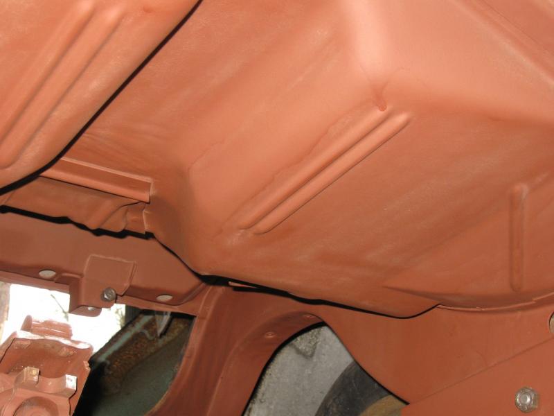

well shes sittin on rear tires now, got more of the under side primed,looks like its gonna be 15''x10'' with 8'' offset wheels to fill the fenders . the idler arm arrived from rockauto its a moog part for half the price vs. local parts store . next the front end gets some attention , well back to the grind :buffer: 63 006.jpg63 007.jpg63 008.jpg63 009.jpg63 010.jpg63 011.jpg63 012.jpg63 013.jpg63 014.jpg63 015.jpg63 016.jpg63 017.jpg63 018.jpg63 019.jpg
63 006.jpg 63 007.jpg 63 008.jpg 63 009.jpg 63 010.jpg 63 011.jpg 63 012.jpg 63 013.jpg 63 014.jpg 63 015.jpg 63 016.jpg 63 017.jpg 63 018.jpg 63 019.jpg

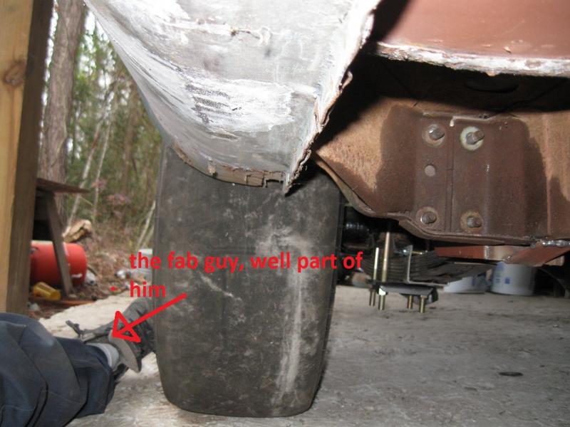

a second glance of your last photo do I see a chain or strap around his foot are you keeping him hostage :rolling:

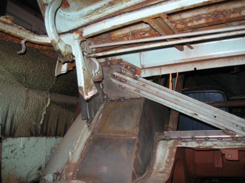

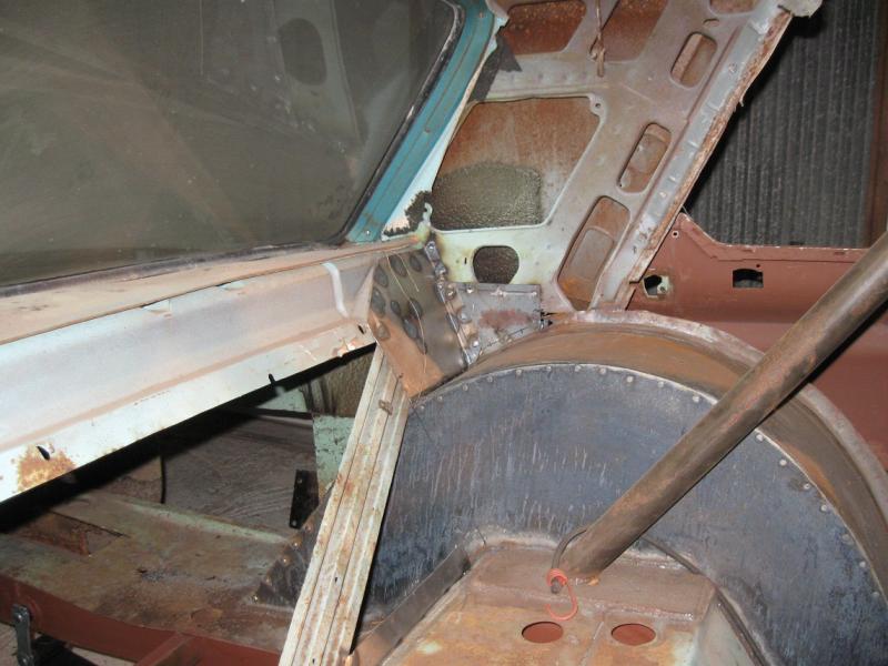

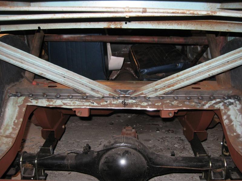

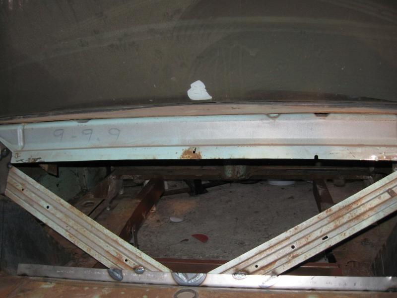

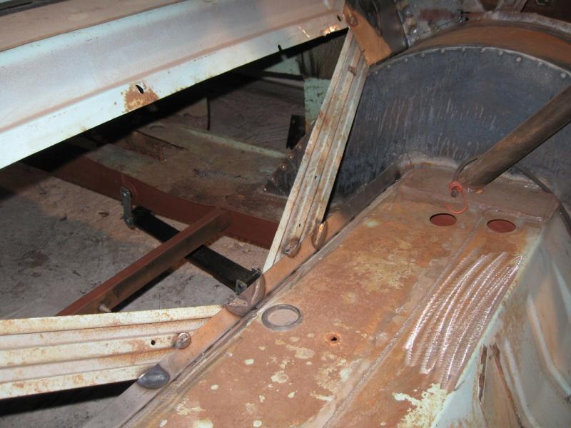

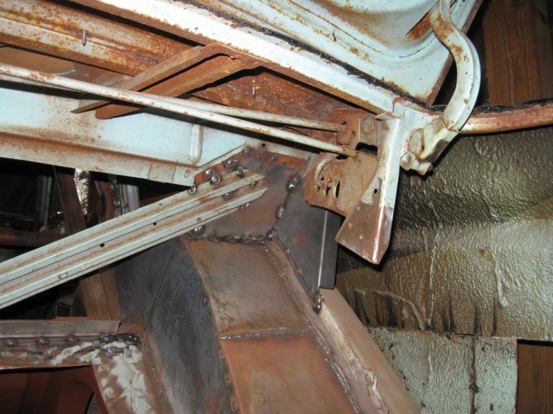

wow. just saw this thread and it's really cool. thanks for the bracing pictures.
I like what you have done. Did you have to reposition the angle of the braces for your wider wheel wells?
yes had to raise them a bit
