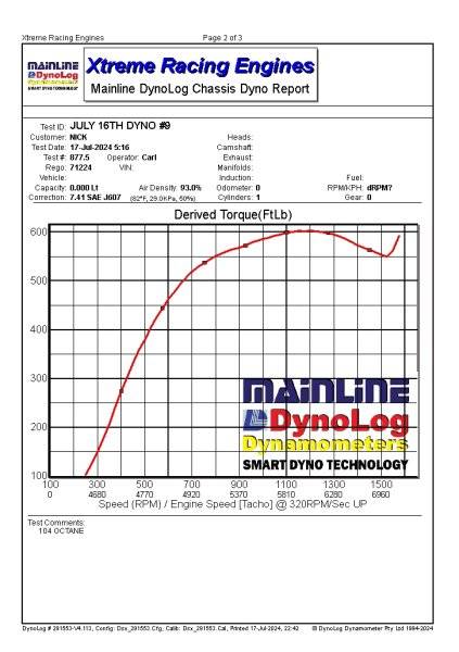

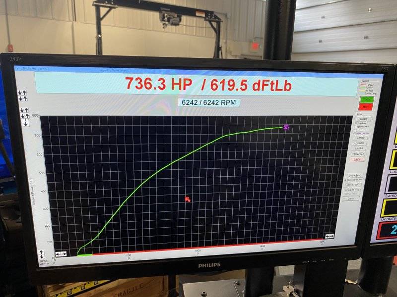

Made 2 tunes and about 15 pulls, plus tuned cruise and cold start. All in all great day. This is on a MainLine Hub Dyno! The higher numbers are on Powermist UL104+
Lower numbers on 93 pump.
Through the mufflers, 3" exhaust, with air cleaner installed and hood closed, w/gear vendors. Not sure what this translates to for engine HP but he feels it's a 15%ish loss from his experience. If that were true looking at 866Hp 727TQ.
Very nice. I recall that’s about where a guy figured the HP would be.

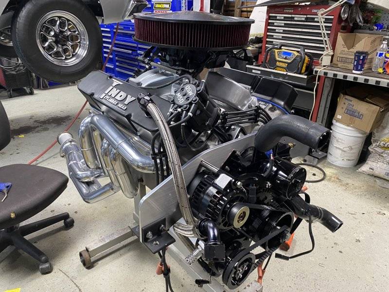

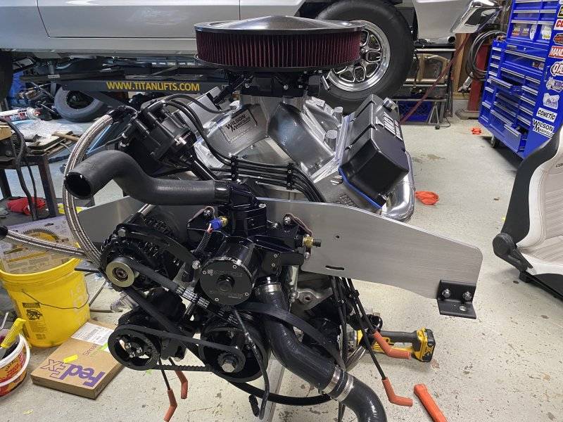

Been doing some work to get the car ready for Drag Week this year. Going to post up some of my progress since I really haven’t since July of last year.

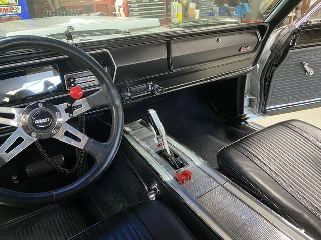

Removed the TCI shifter and built a new mount for a Reverse pattern Motion Raceworks CO2 shifter. It's Kinda weird, it mounts the cable on the tail shaft bolts and feeds in from the back. Also the shift pattern is already RMVB but Backwards/Backwards. Park is all the way back, Forward to R,N,1,2,3. Used a lazer level to find center of car to completely rework console location. Had to move console back another 6 inches + what it was already moved back for the TCI shifter. So console is roughly a foot to the rear and 4” higher then factory location.
