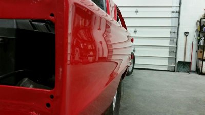

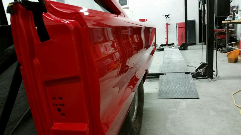

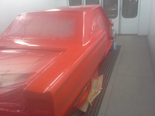

first pic is white sealer with one coat of base, second is finished

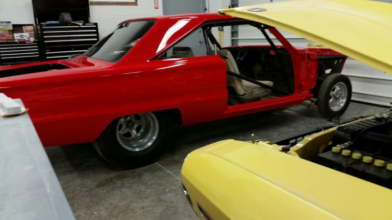

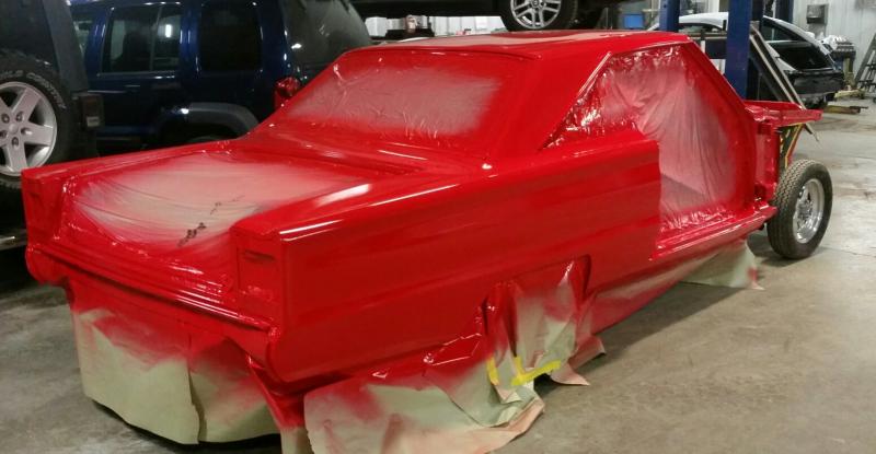

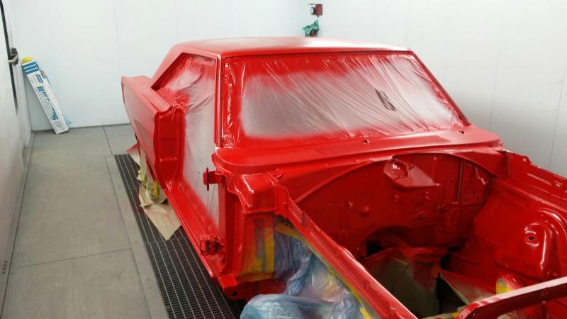

heres a shot after 4 coats of base and 3 clear, will cut and buff mid week
Wow, that's going to be a killer car. Look forward to seeing more of the build.

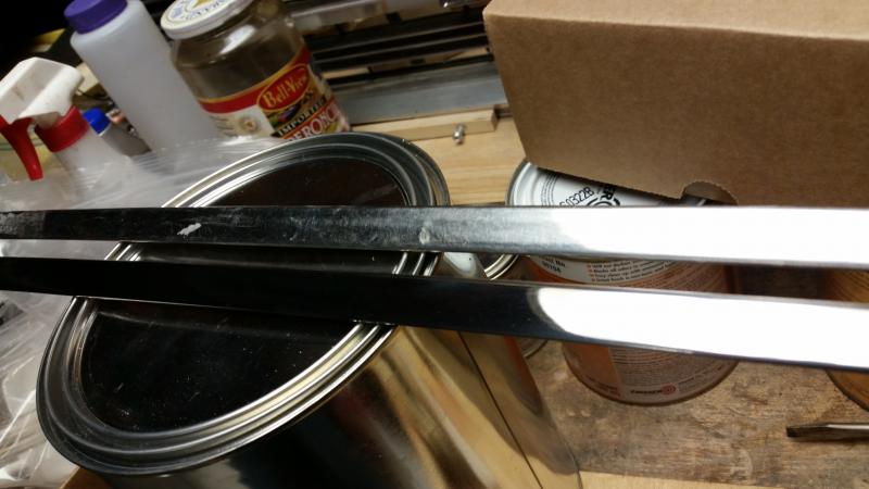

heres the last of the stainless to be polished, windshield side moldings before and after, thanks for the comments, enjoy

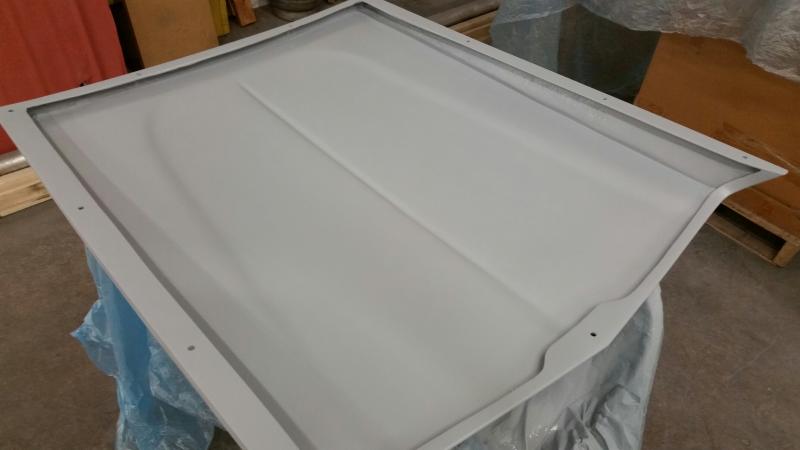

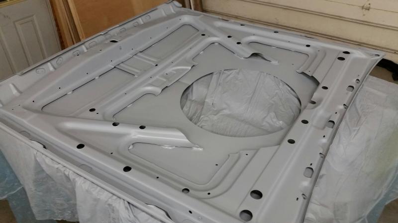

here are some underside shots of the of the hood and scoop finished up, the bottom of the scoop was shaped to mimic the negative of the top to appear as if it was stamped, the hood bracing and hole were cut using measurements off an original ro23 hood and tweaked to be aesthetically pleasing :headbang:

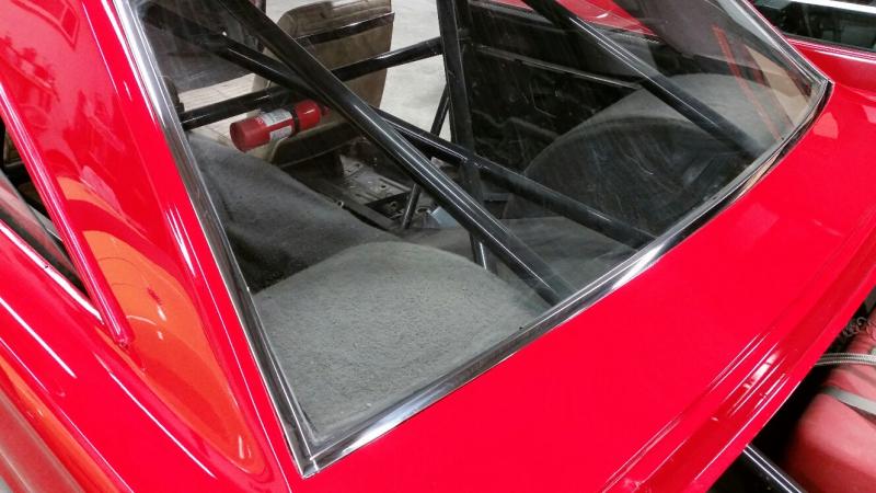

installed the rear window stainless trim. camera struggled to capture the depth of the polish on the stainless :glasses10:

Beautiful work. Can't wait to see it done. Who made your hood scoop?
Thanks, Scoop was made by aar/stinger fiberglass. I have 100 to 150 hours into it to make it look the way it does. Now it has a perfect fit to the hood curvature, 100% symmetrical and the underside is a negative of the top to replicate a stamped piece.

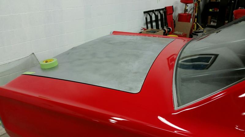

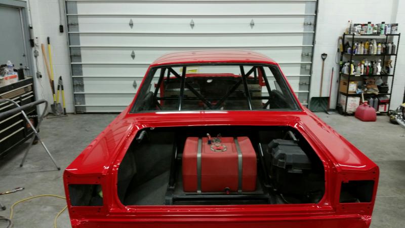

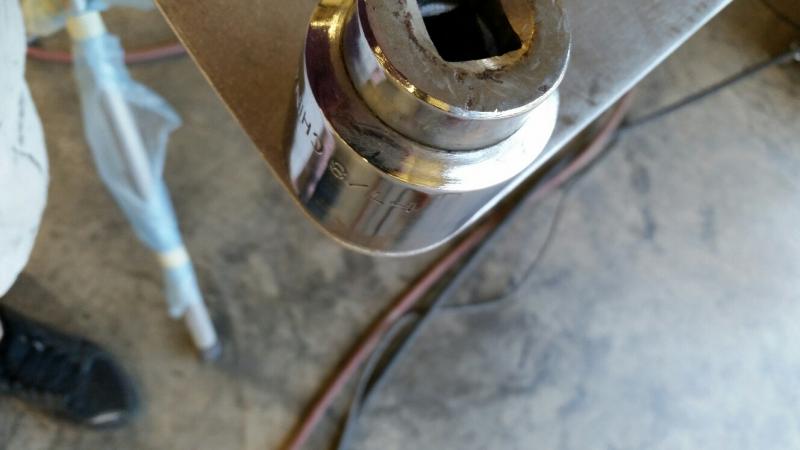

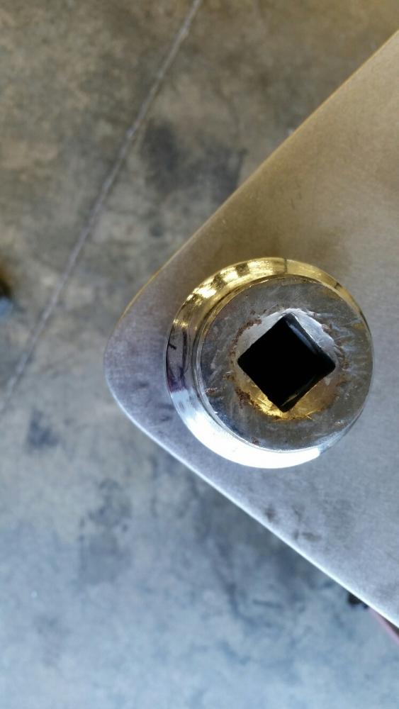

Finished up the metal work on the trunk, corrected the poor factory radius on each truck corner, finishing up the prep on the remaining parts for paint. BTW for those who might be interested the car is for sale, Thanks
