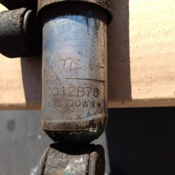

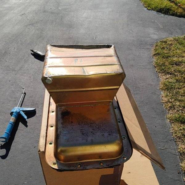

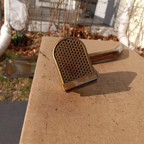

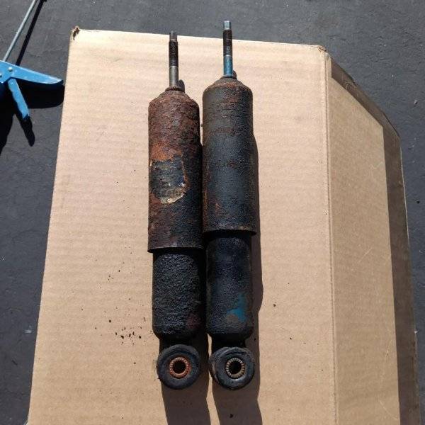

Been a while since I did any work on my car but recently removed the old shocks as well as the race pan.

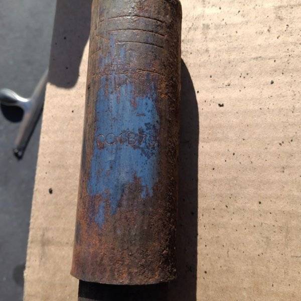

Went back to the stock 402 oil pan. Old shocks read: Monro-Matic, Made In USA 2033 CO12B73 / 2033. Anyway to tell the date on the old shocks?

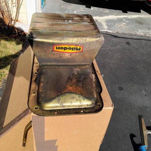

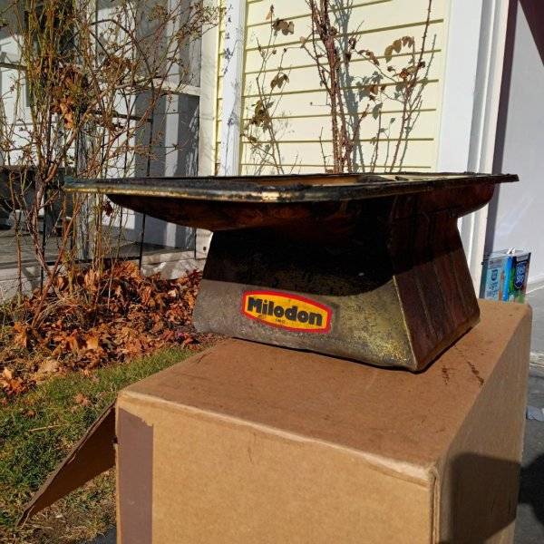

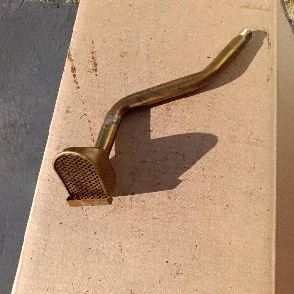

I'll be selling the oil pan, dipstick, pickup as well as the bolts. Gotta figure out a value on it.

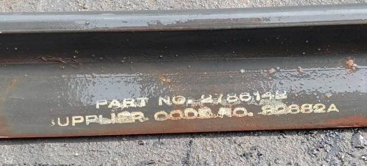

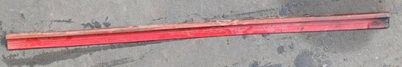

Little project today after a cruise. Pulled the hood/cowl weather stripping. Someone back in the day had painted it. Stripped the paint off & was happy to see the part & supplier number, which makes me believe this has been on the car since it left the factory.

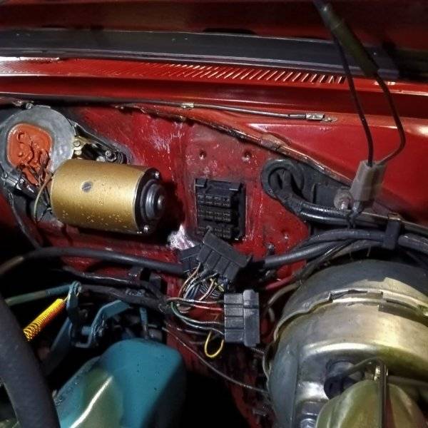

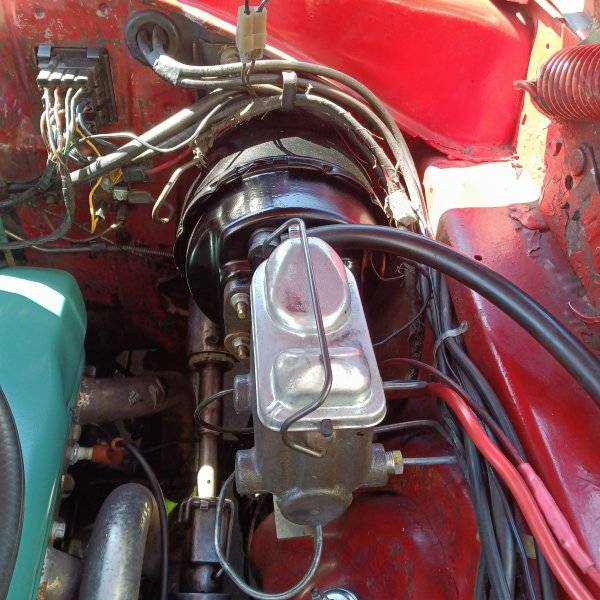

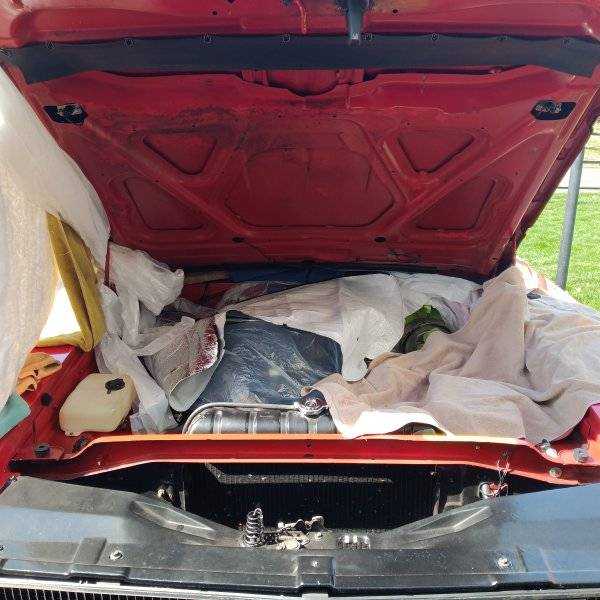

Began removing the black paint on the firewall. After a few different tries with various chemicals, Lacquer thinner was the winner. Discovered there was a respray of Red on top of the original red paint then the Black.
More detail here: Firewall Paint Removal
Spent a wet raw dreary rainy day in the garage tackling the other side of the firewall. As the area is much tighter to work in, used a small spray bottle with lacquer thinner in it. Really worked out well to spray/soak the black paint & continued to use my Dremel brass wire brush to scuff off the black thick paint.
Pretty much have it all done but have some areas to touch up and hopefully will be sunny next weekend so I can work outside & wash the engine bay down to clean it all up & then shine up the firewall.

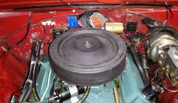

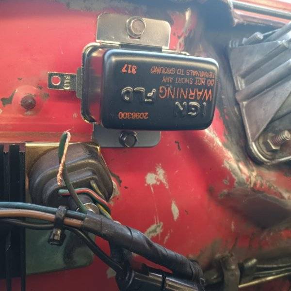

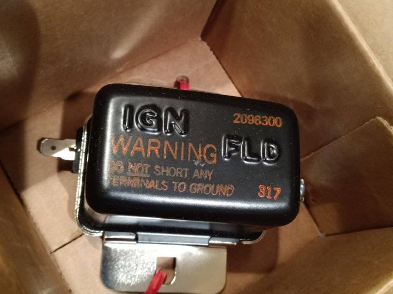

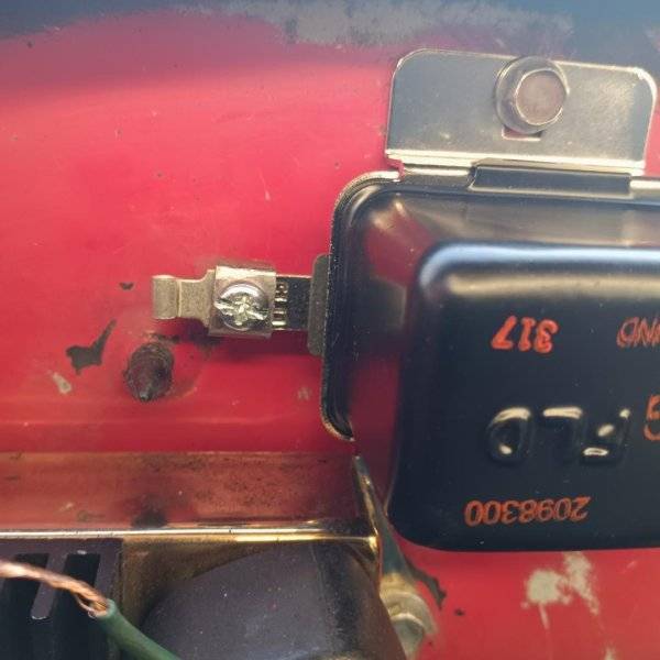

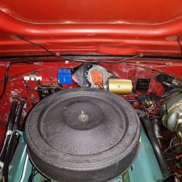

Installed the OEM style Voltage regulator tonight and went for a test drive. Bought the VR thru Mega Parts & as it did not come with the U shaped cover that's on the FLD side made one myself.
Big shout out to Tommy White at Parts Hound!
I had reached out to Tommy White @ Parts Hound | Mopar Muscle Car Parts | Ebay Vintage Car Parts and while they do not have the OEM style they have the same one that Nacho-RT74 suggested. I ordered 3 of them and they're shipping tomorrow. Great guy & service!

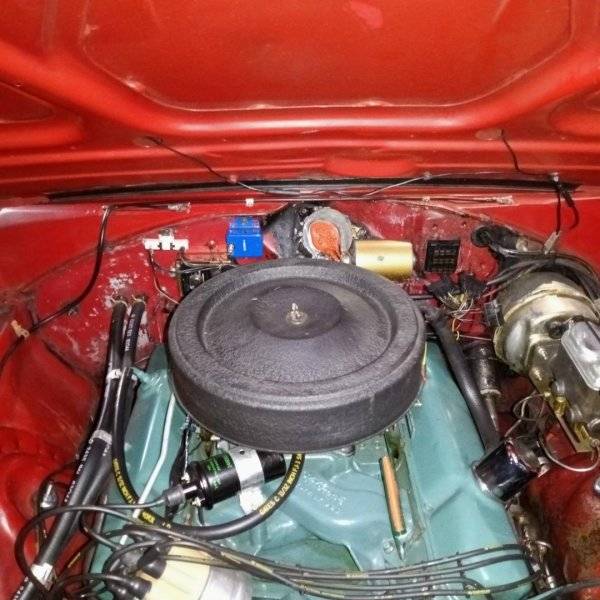

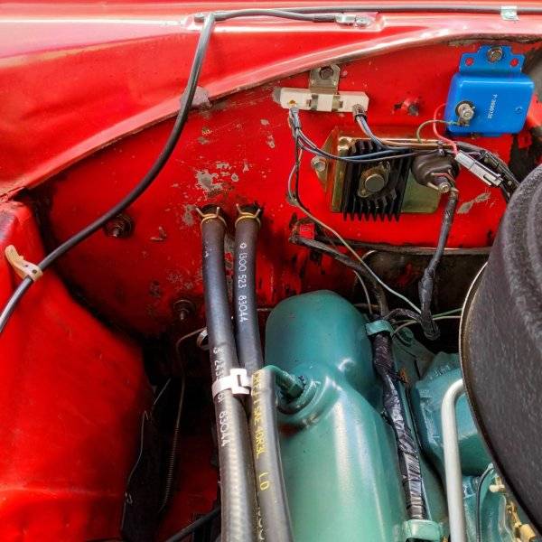

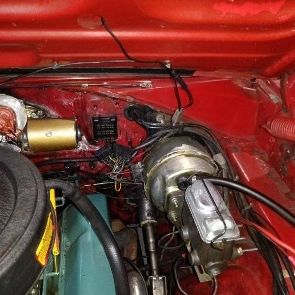

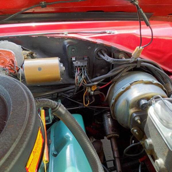

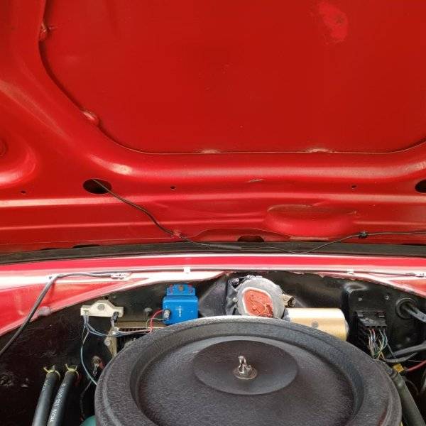

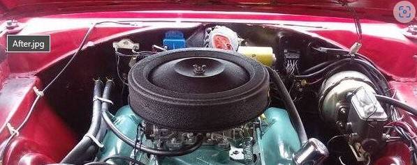

Busy day (8hrs+) today as I'm getting ready to go to a show close to my house tomorrow. Installed the back seat jute, seat adjuster knob on the passenger side & under hood wiring clips I got from Mega Parts.
Also installed a NOS bench seat belt clip. Spray painted the wiper motor with Testors Gold Flake paint which matches very close to Yellow Zinc Chromate & coated the wiring area with Red Insulating Varnish.
Vacuumed & power washed the car & then took it out for a drive.
