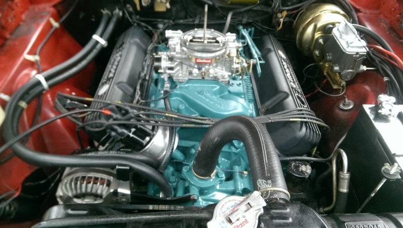

You taped and sprayed it in the engine bay. You absolute madman. I want to do this so bad but mine is all flaking and looks like a tv zombie.
Nope, l used a brush to avoid overspray and creating a bigger mess to fix

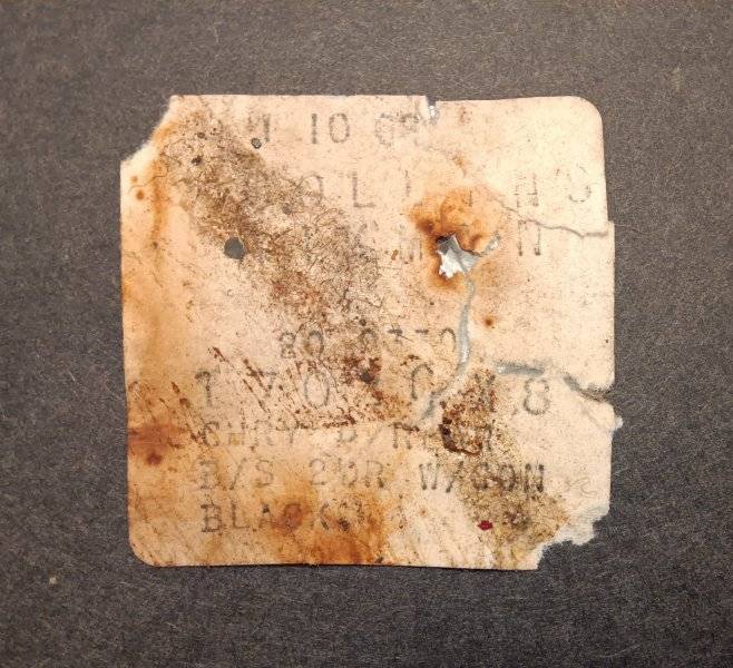

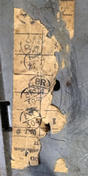

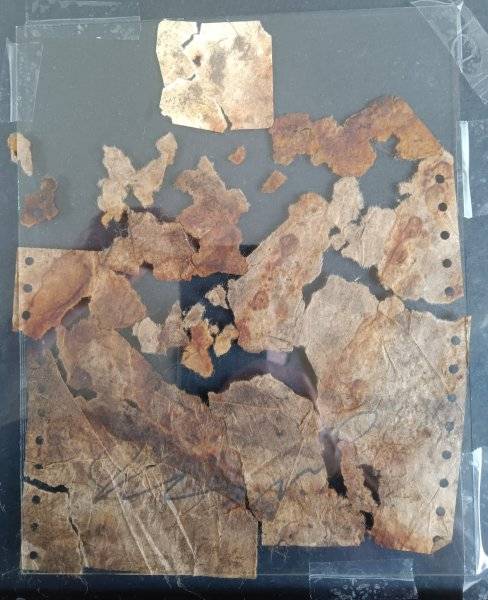

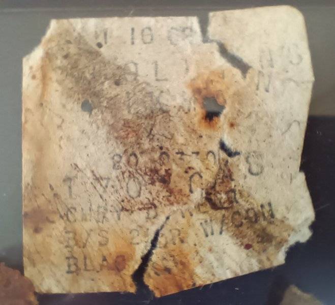

While looking at my back seat bottom date tag decided to look under the carpet and see if anything was there and struck gold.
As l already have the BS and Fender Tag, l wonder if these are for my car or not.
I sent the pic of the tag to Dave Wise to see if he knows what it is as I did not see it listed in his General Field Guide.

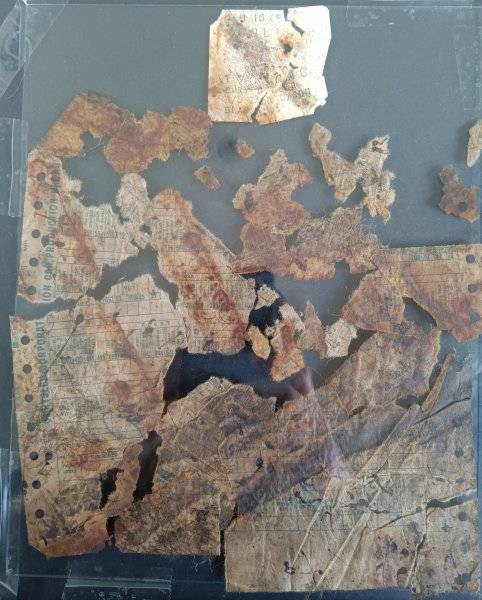

Putting it all together pc by pc scotch tape on the back. Found some more pcs but unfortunately looks like l'm missing the vin.

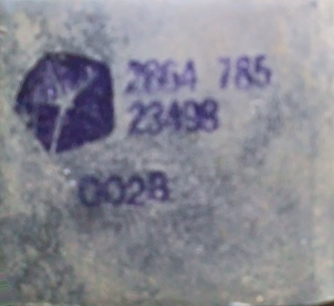

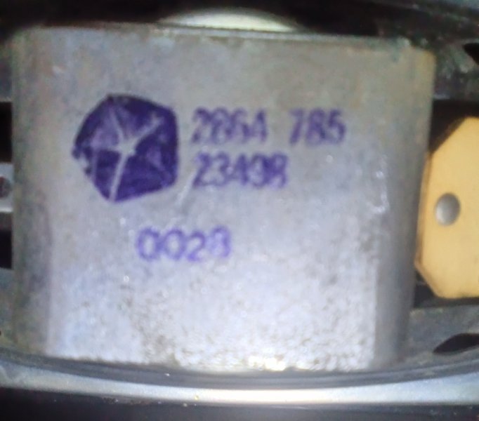

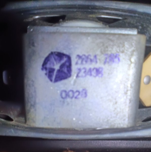

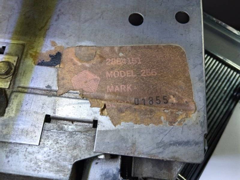

Dropped the radio down yesterday to get pics of the date code on the speaker, 0028 = 1/2/68.
Also took pics of the radio but not sure I'll be able to get the date due to the quality of the sticker.
