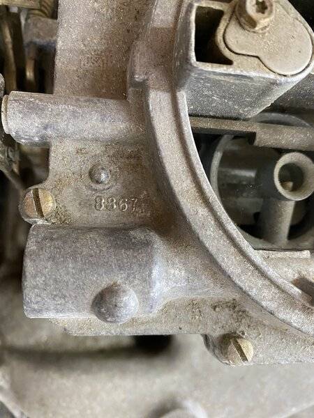

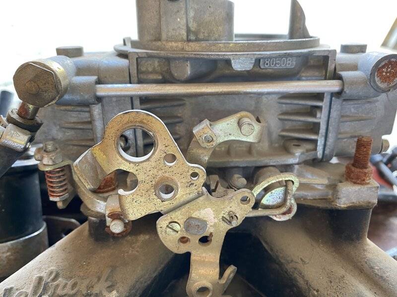

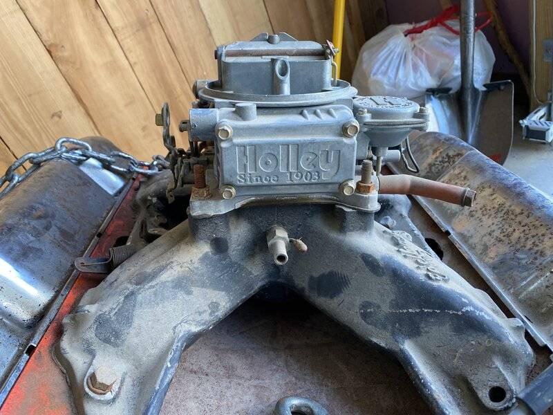

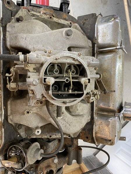

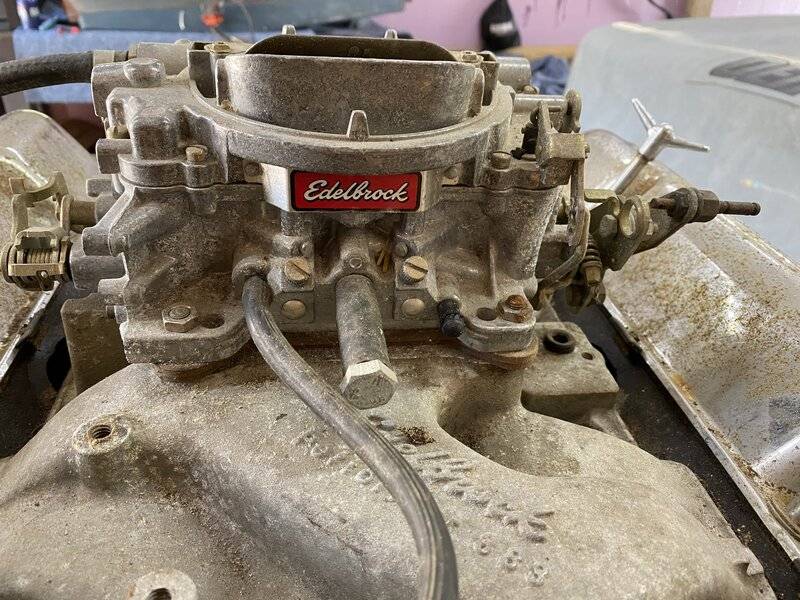

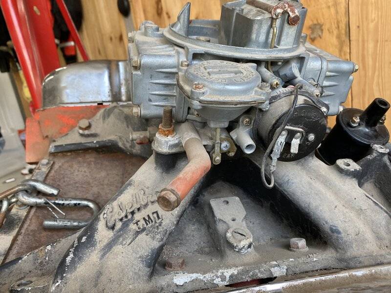

Got the dash figured out, now I’m trying to salvage any parts I may need off of the 400 before I attempt to sell it, which leads me to my next question. I have 2 carbs, a Holley that came on the 440 I bought, and an edelbrock that was on the 400 that came with the car. Is there one that’s better than the other? I’m thinking about hanging onto both in case one doesn’t work. I don’t know anything about either of them but I’ll attach pictures of both.
Agreed Jeff. I have yet to even touch an idle screw on the SuperBirds carb in the 31 years I've owned it. Lost track of how many Holleys and/or rebuilds on those I've done in the same time period on the Bee.
I’ll plan on going that route then. Rebuilding the edelbrock and hanging onto the Holley. Thanks

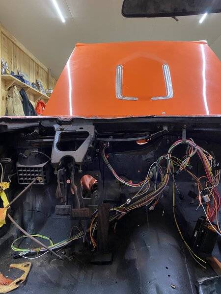

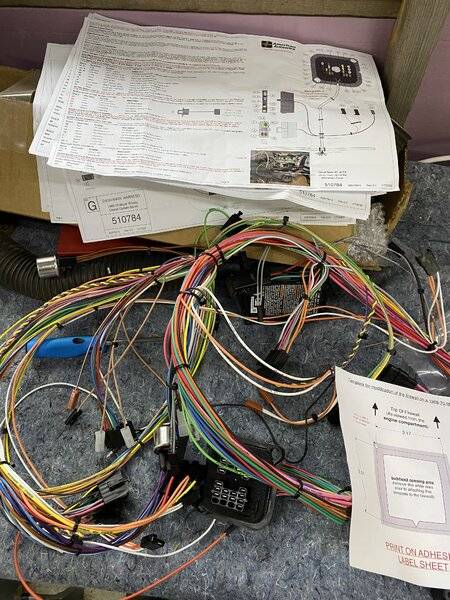

My classic update harness from American auto wire finally came in! But I didn’t realize I had to buy the crimpers separately, I had some at work I thought might work but no go. Now I’m waiting on the crimpers to come in.
Know it's not funny but when opening up the box and your checking out what they send us and every thing is not their. I my self had looked into the box to see if any thing was still in their. Hey good luck and your getting her done so that is what count's in the end. :thumbsup:
Started laying out the wiring harness while waiting on the crimpers to come in, and I found out that the previous owner put in a generic floor pan. This means nothing is marked out or where it “should” be. I’ll have to take measurements for the 4 speed floor hump, the seats, the dimmer switch and probably a few other things. Does anyone have a picture of where the dimmer switch is supposed to go? Or have measurements from something that isn’t the floor pan?
