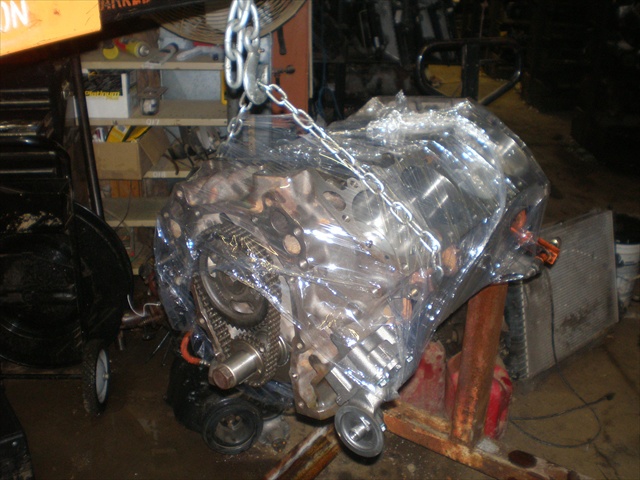

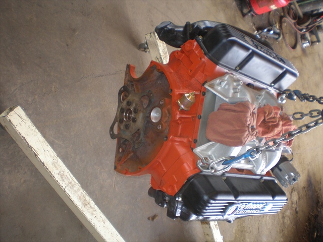

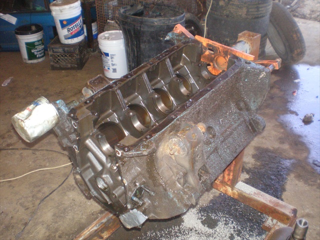

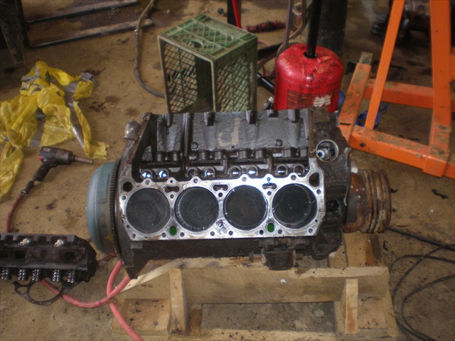

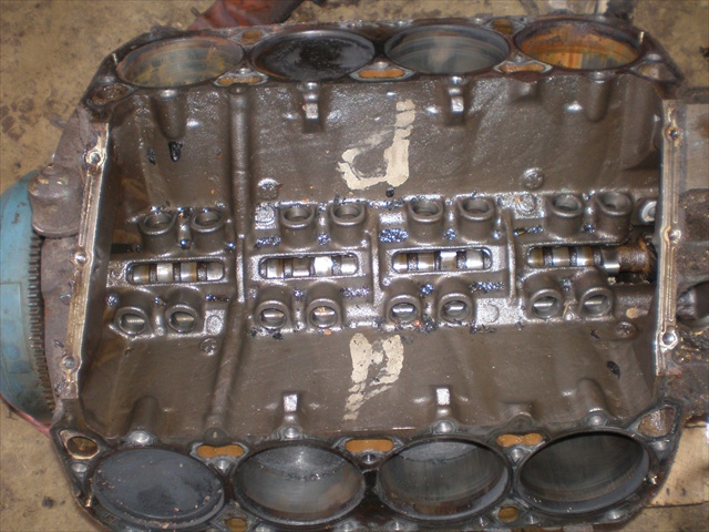

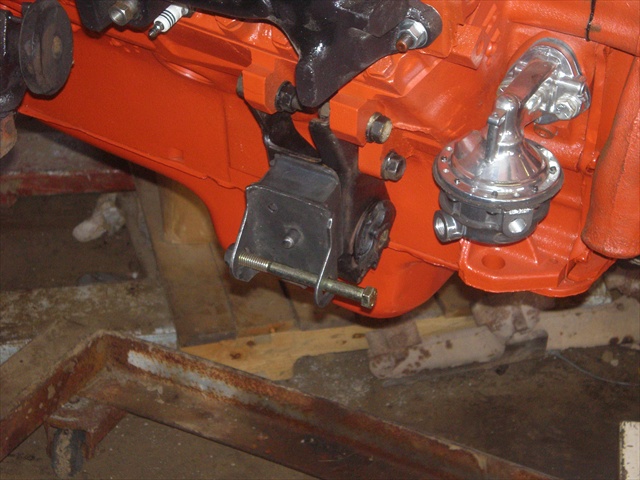

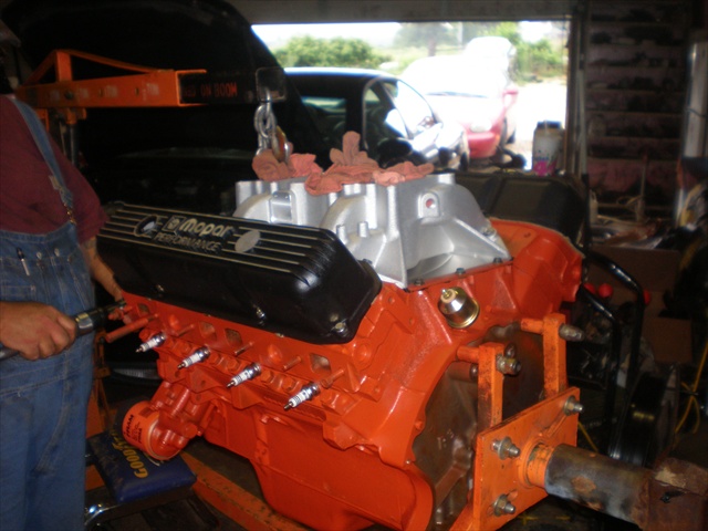

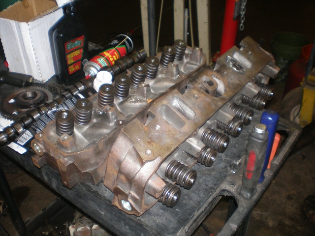

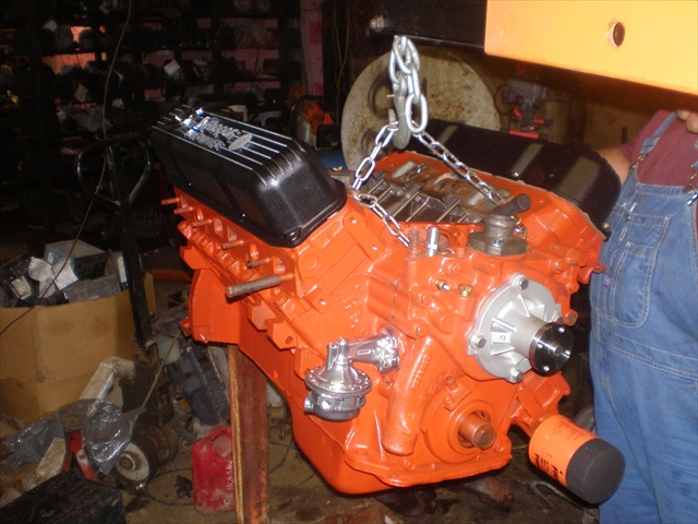

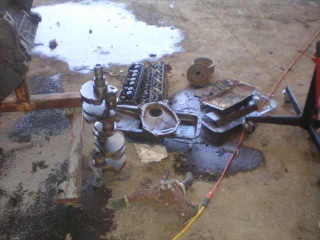

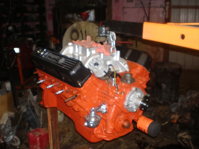

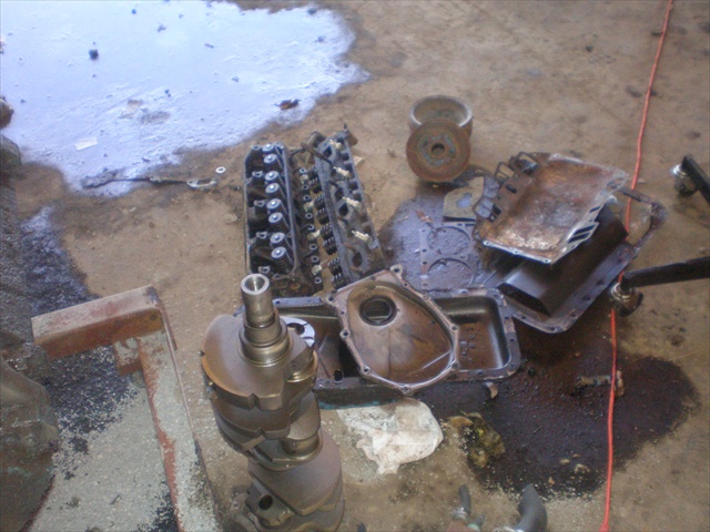

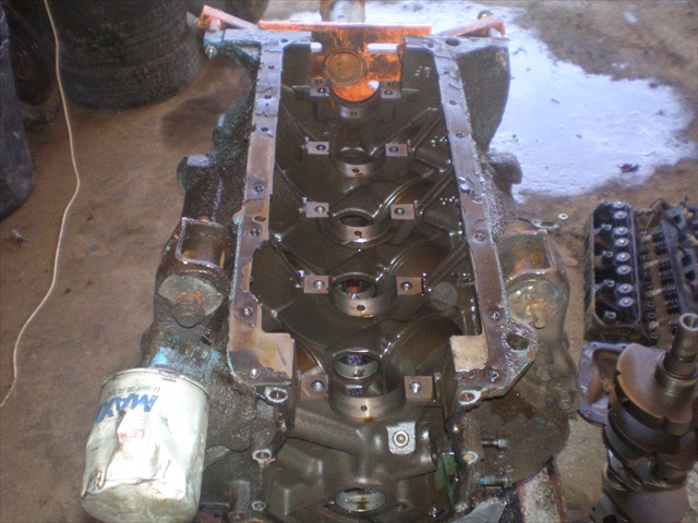

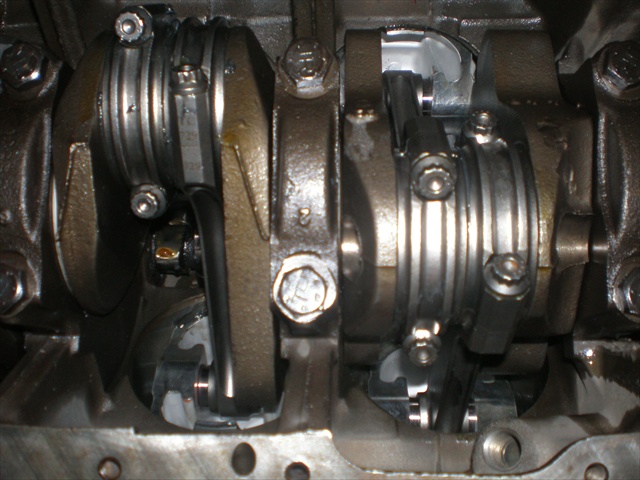

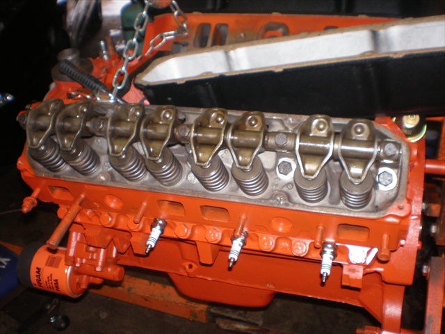

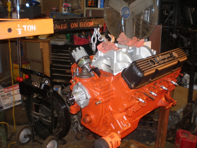

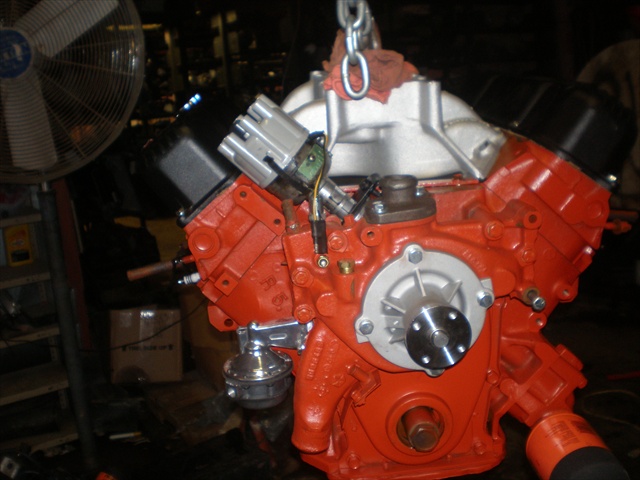

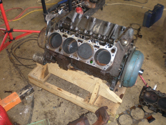

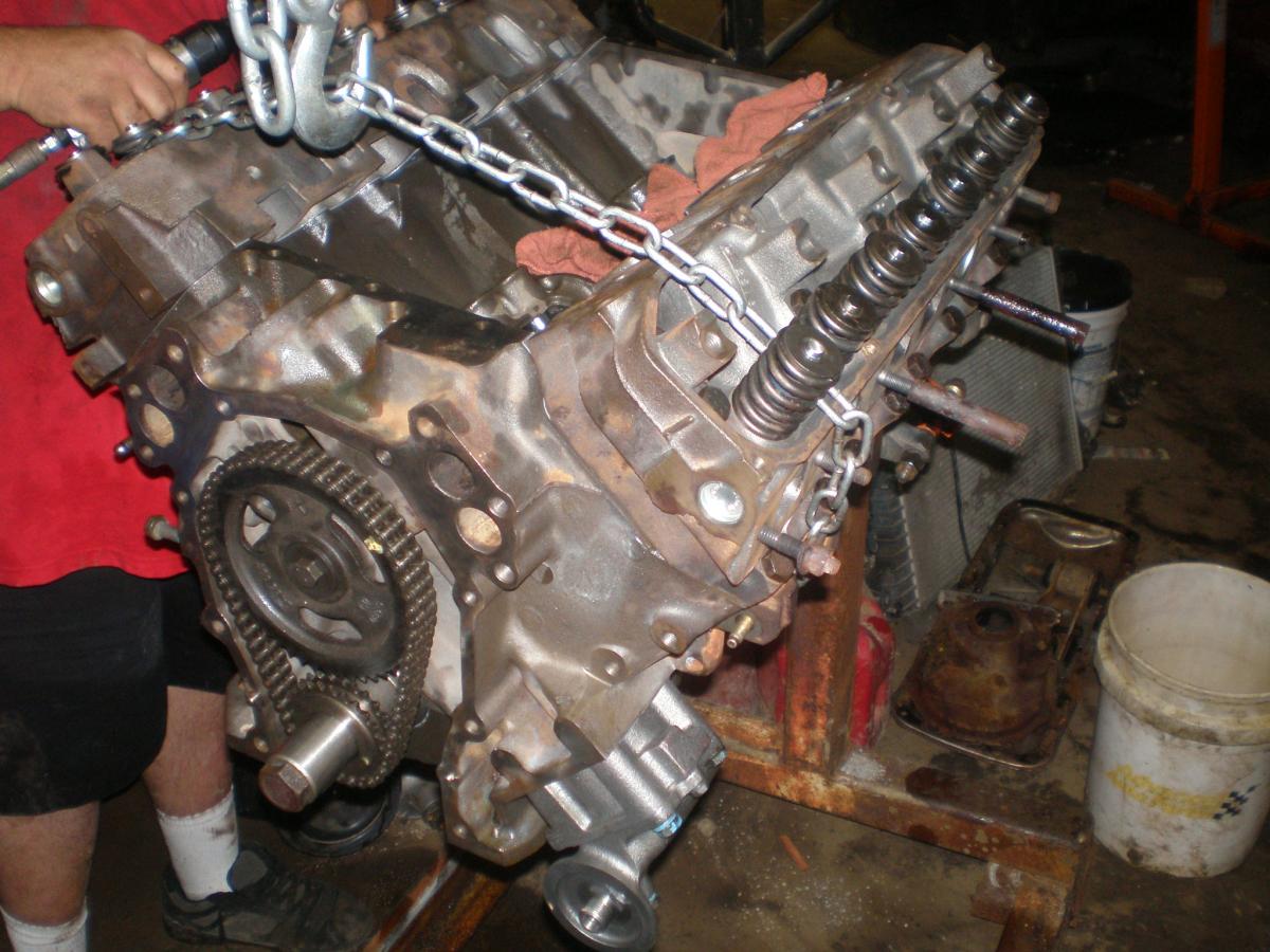

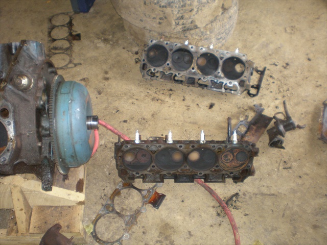

motor was suppost to have just 60 k on it so i was hoping to hone it rering and re baring it and go. no such luck had to punch it .30 over

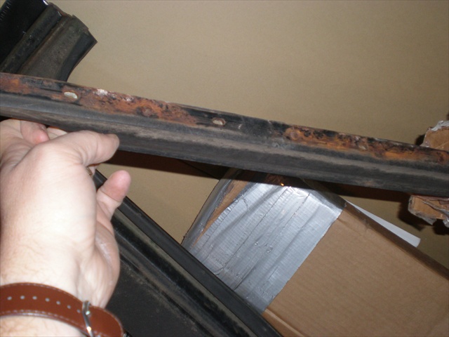

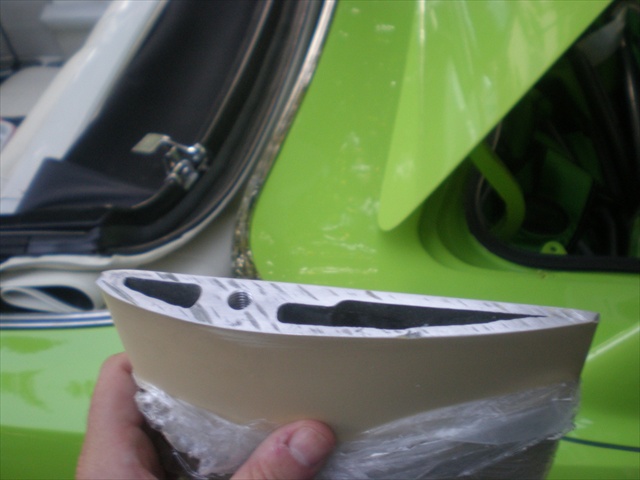

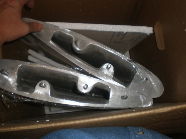

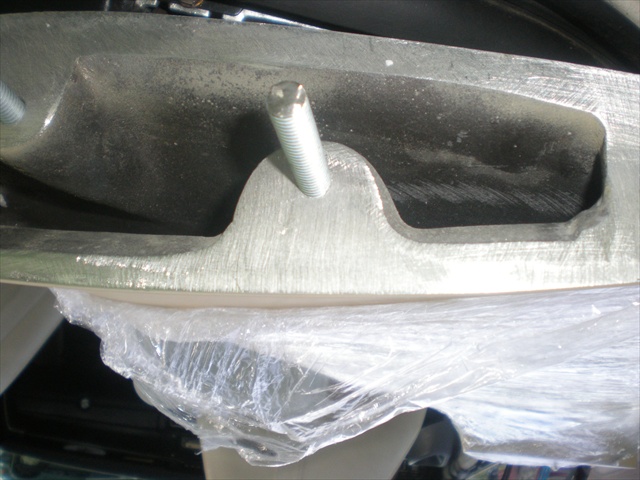

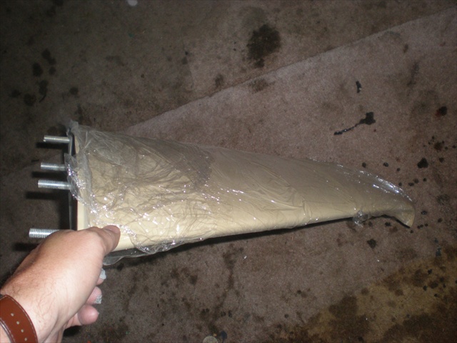

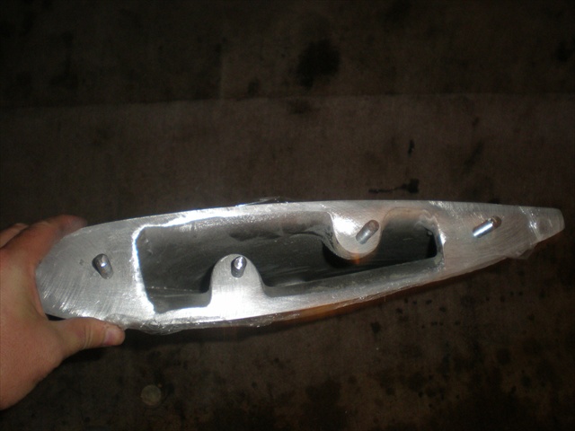

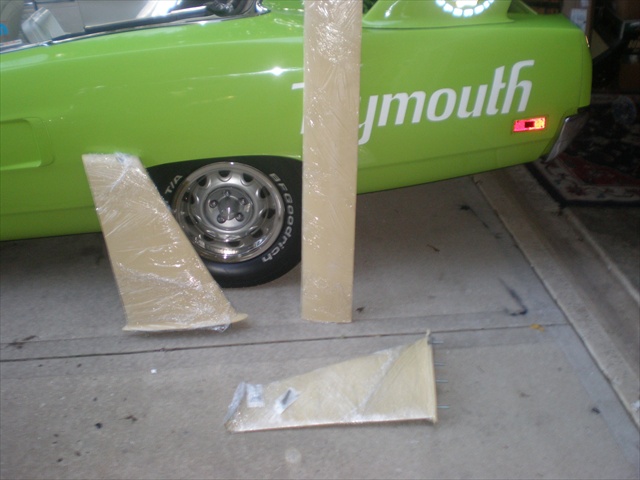

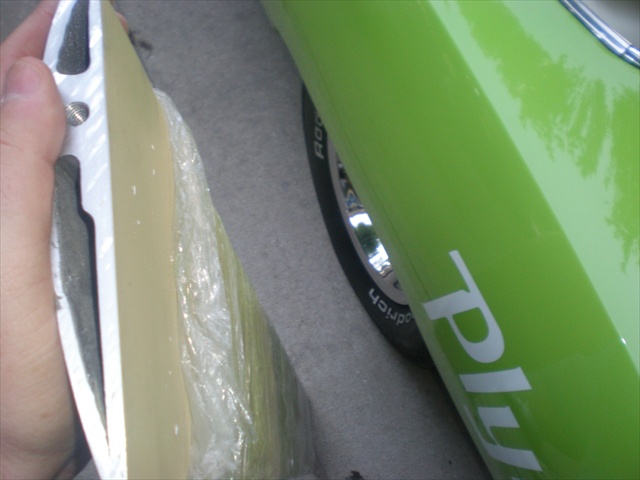

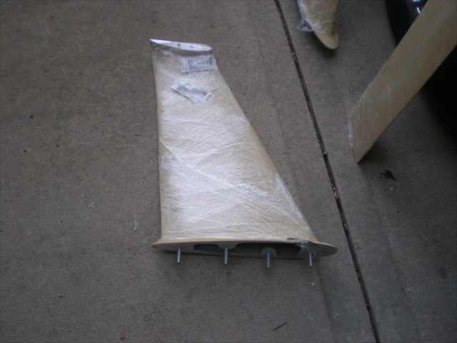

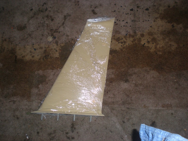

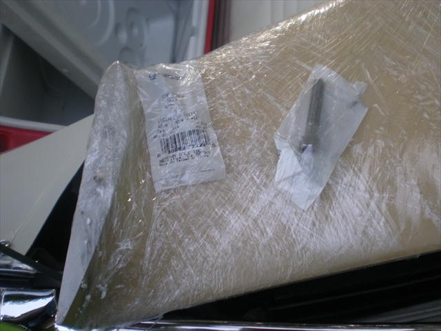

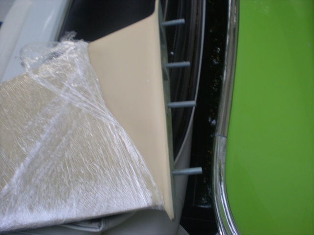

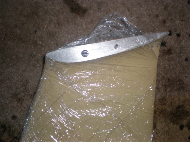

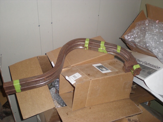

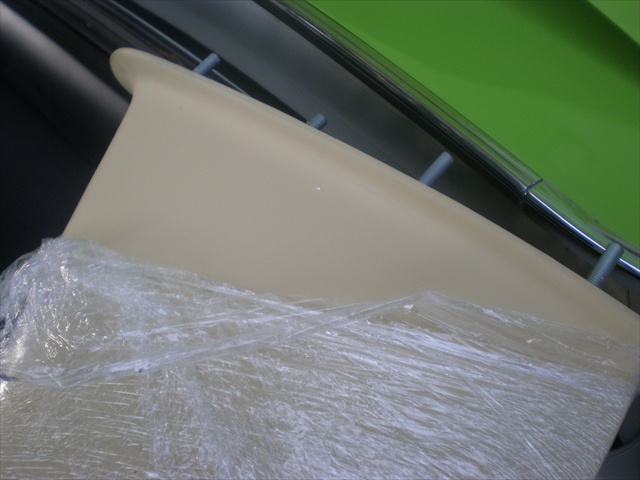

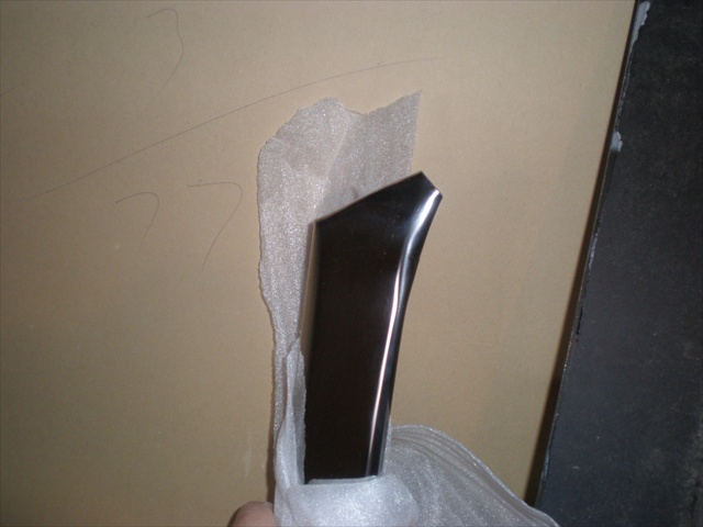

:santa: custom daytona and charger 500 only trunk lid hinges , wing washers they mount up in the quarter panel top to strengthen the quarter for the wing .

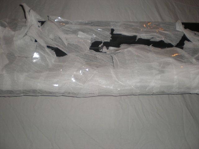

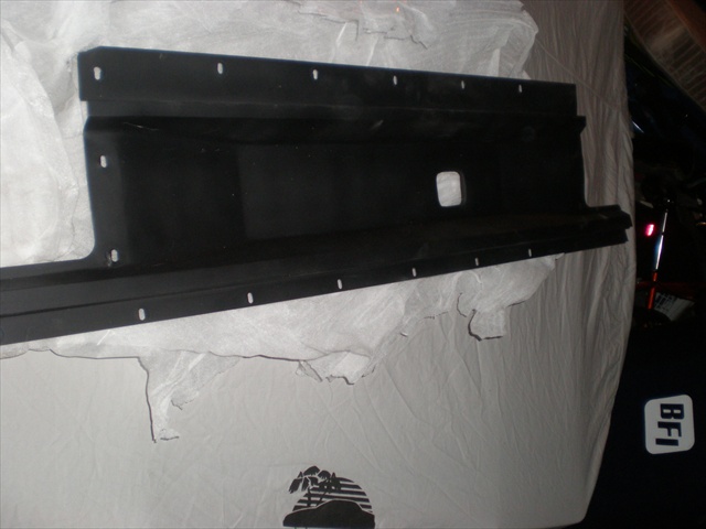

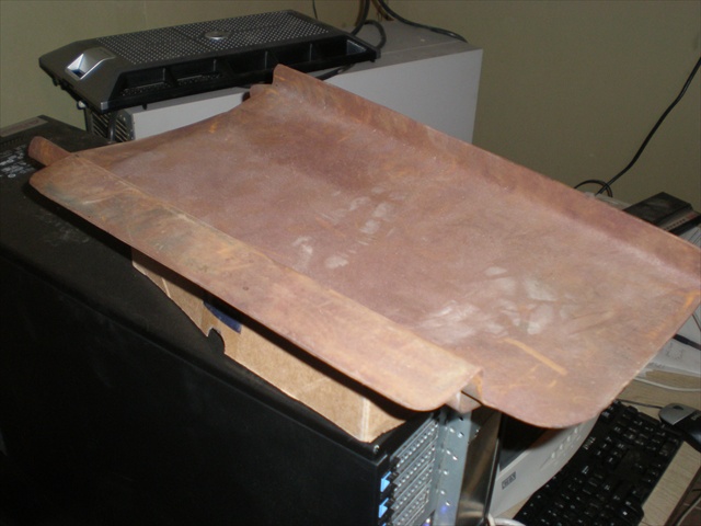

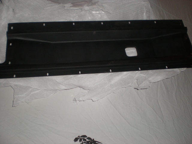

that is a partial 73 charger dutchman panel . Once you get the vega hatch installed it make the front drip ledge for the truck .
