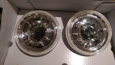

-LED headlights

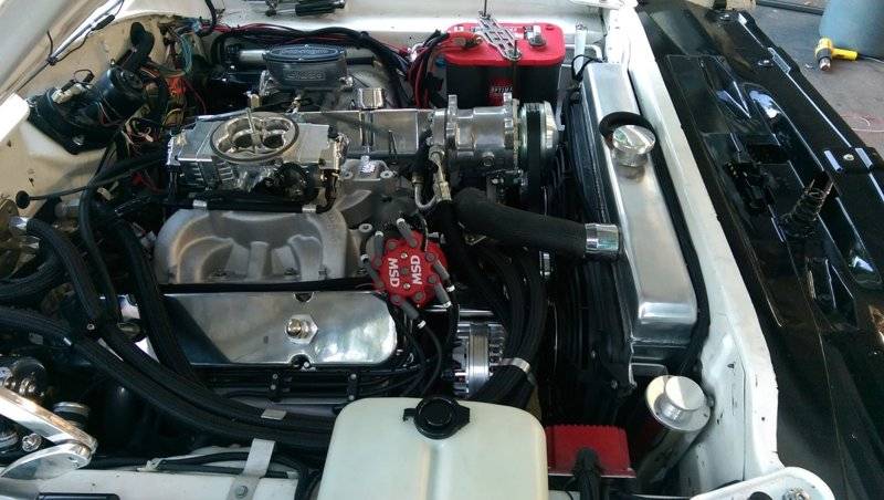

The EFI switch was awesome, the car ran smooth for about a year until one day it didn't. I checked everything possible and turned out the Fitech unit fried the ECU. Fitech's customer service was a waste of time and wouldn't even allow me to send the unit in for repairs so after months of talking with Fitech getting pushed to different support technicians going over the same items over and over I walked away from the car for a while.

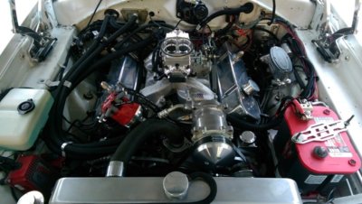

After getting sick of seeing the car sit I decided to start over and toss the Fitech. Thought about going back to a carb but decided to go with the Holley Terminator stealth unit. It has been on the car for 2 years now and has been awesome.

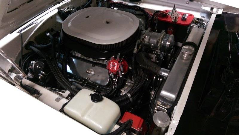

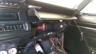

Once the car was running I figured the stock harness was maxed out. So I pulled out all the wiring and rewired it in 2017 with a kit from American Autowire. This kit is very well made and had all the extra circuits to handle the EFI, electric fans, fuel pump, and all the other accessories I've added over the years. Kit went in perfectly, just needed to buy a good pair of ratcheting crimpers for all the specialty connectors and was pretty easy to wire up.
wiring 1000117.jpg wiring 10001114.jpg headlight projectors 1001.jpg engine 100111.jpg engine 100113.jpg engine 100114.jpg

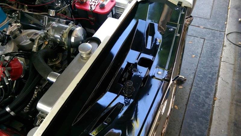

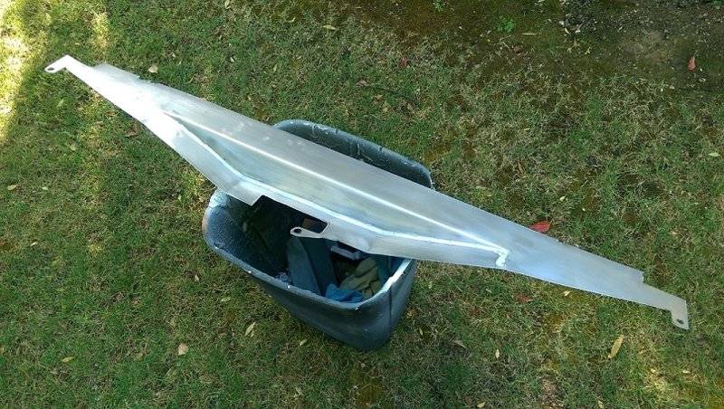

Another project I did while it was sitting was I made a filler panel to cover the hole in front of the radiator. Its not perfect but I'll make another to get the gaps spot on.

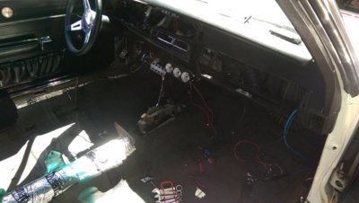

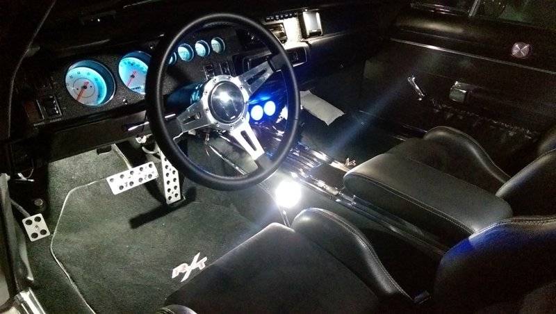

Here's a shot of the interior after the wiring was done. The kit includes 2 lights to help light up the floors which I think looks real good to brighten up the interior.
So the one bummer with the wiring kit was that it does not allow you to use the stock a/c box. So my future projects will be to install a new a/c box and hide all the hoses to clean up the engine bay. Either going to go with a Vintage Air unit or Restomod Air. Not sure which yet but from what I hear they are both great companies to deal with.

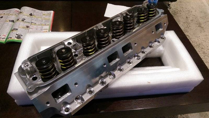

I've also got a set of ported aluminum heads from Marsh Performance to install. Can't wait to get these on.
That car is sweet !! Let me know how those heads do, I was looking into them also. It’s a toss up between those and for a couple dollars more, the trick flows
