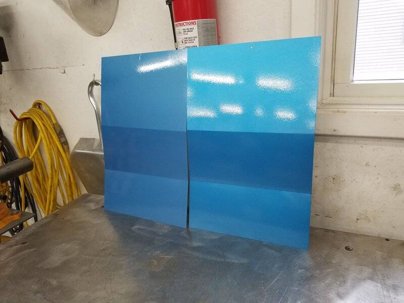

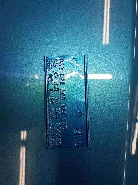

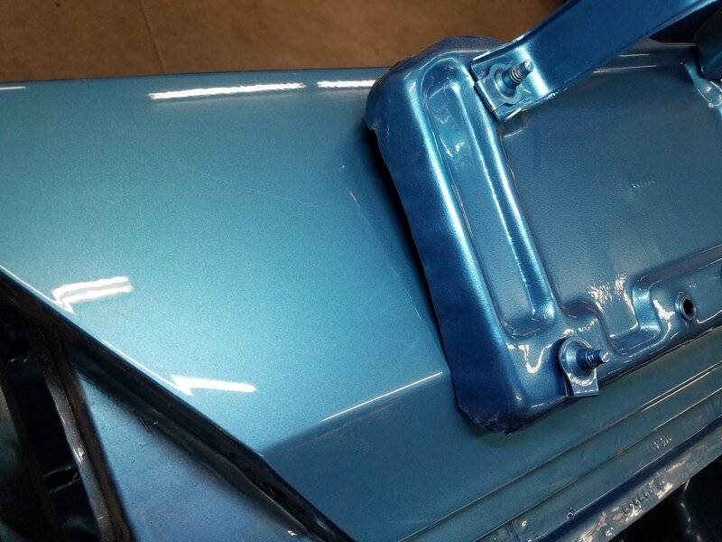

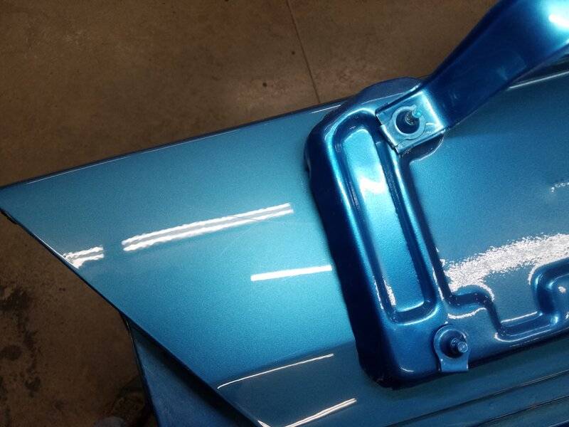

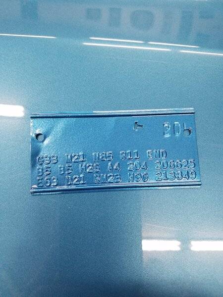

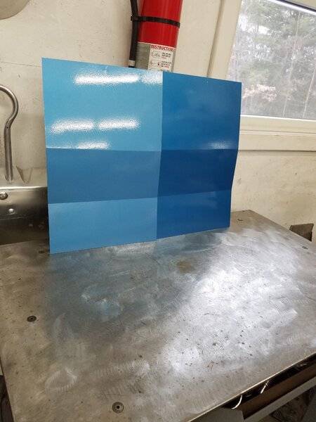

When I had the car painted years ago it was with Martin Senior because that's what the shop stocked and used on everything. I used PPG on my Bee, liked that, and decided to use that on this car as well. PPG has their top of the line Deltron at $900/gallon at well as Shopline at $250/gallon. It is common to spray a couple coats of the cheaper stuff on first before covering with Deltron. I was surprised by the color difference between the 3. The 2 test panels shown are Deltron on the right and Shopline on the left at 2 different angles. Oddly the Martin Senior on the car is closer to the Shopline hue. Couple pics of the fender tag and battery tray I sprayed with Deltron laying on the top quarter of the car. Looks like it will be a more vibrant color than what I had.

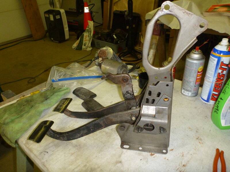

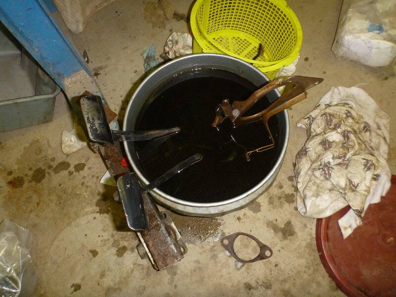

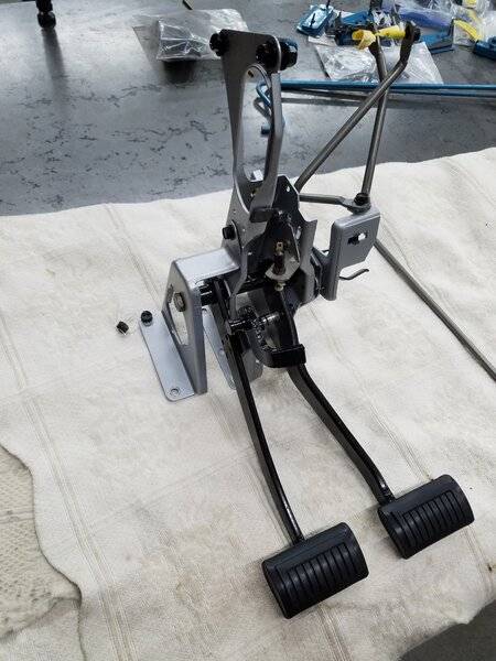

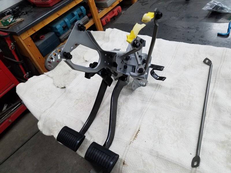

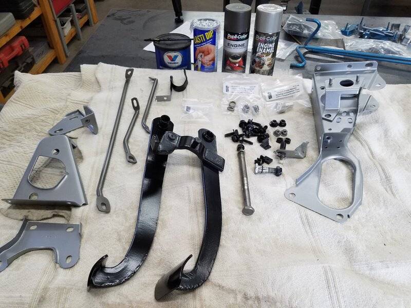

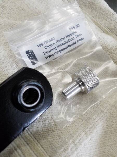

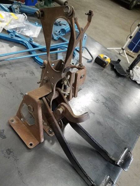

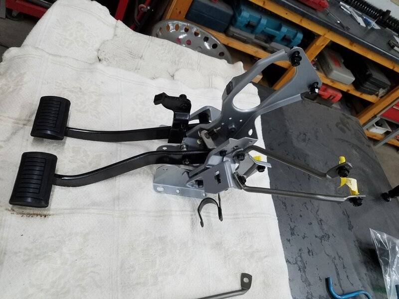

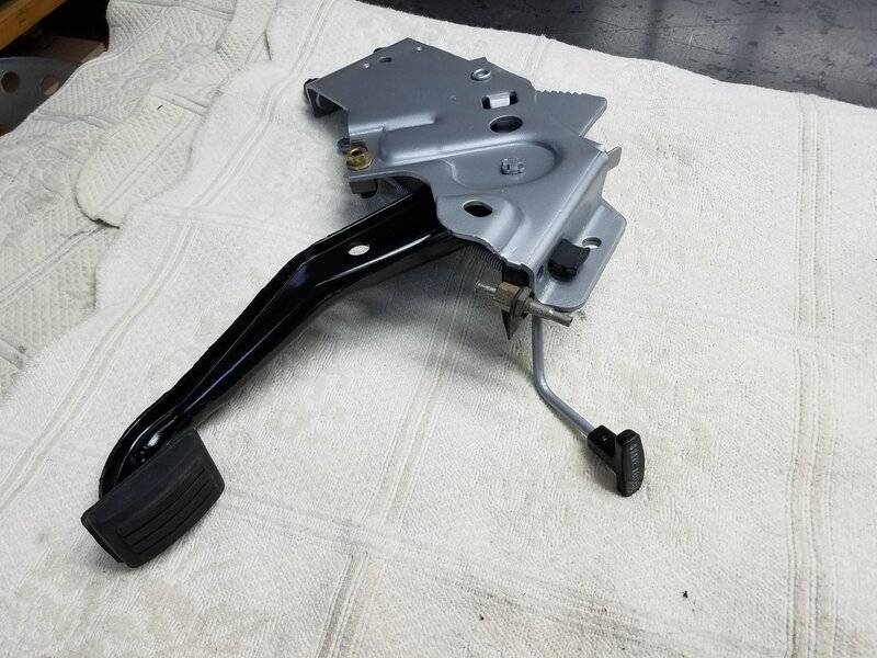

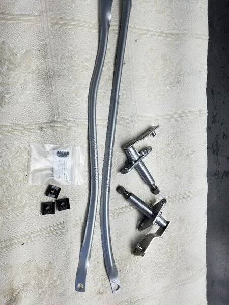

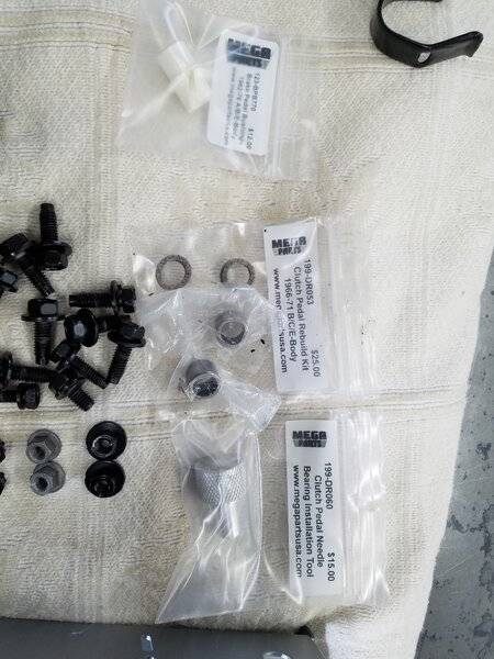

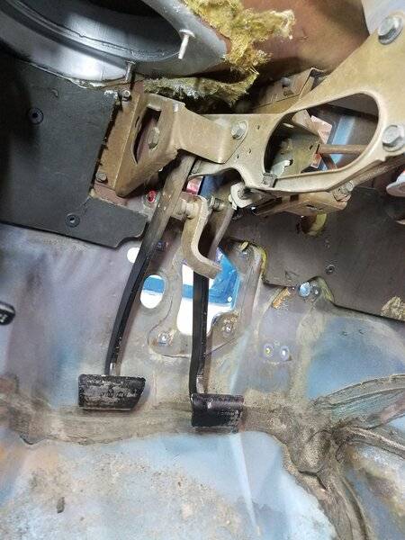

Probably the first time this pedal assembly was out of this car. Original patina, but these are the things that bug me as I dislike the color of rust. Disassembled and blasted all the parts. I use either a black or grey epoxy primer and then on these pieces sprayed with engine enamel. New pedal pads, brake pedal bushings, clutch pedal bearings, and back together. I bought this clutch pedal bearing install tool from Jamie and it sure made life easier. It holds the needles in place and has a shoulder to seat the bearing to the correct depth.

Wow gorgeous work my friend!

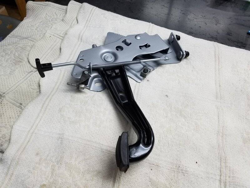

And the e-brake pedal finished up this morning.
