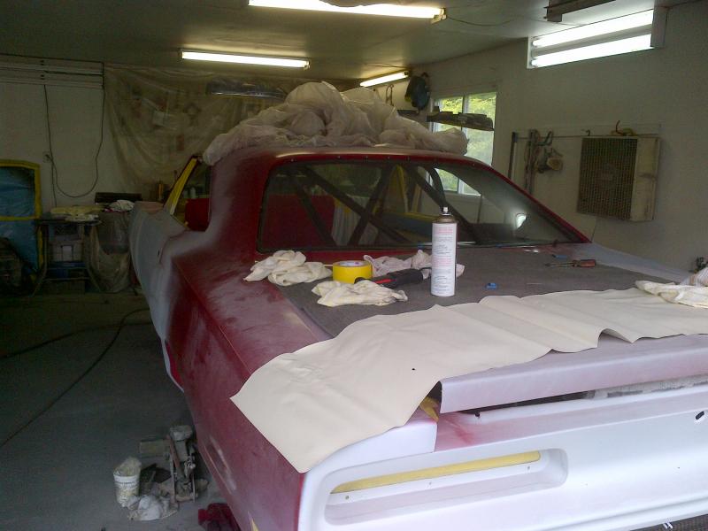

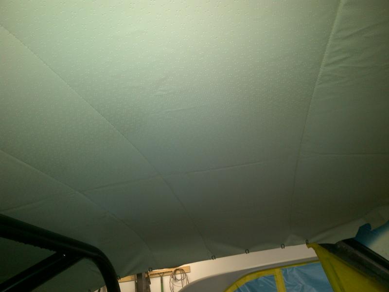

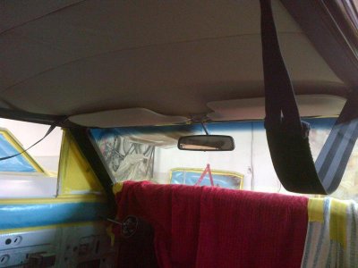

It's a long agonizing process...I'm diggin' the white though! Do the visors go white also? IMG-20150626-00811.jpgIMG-20150627-00813.jpg

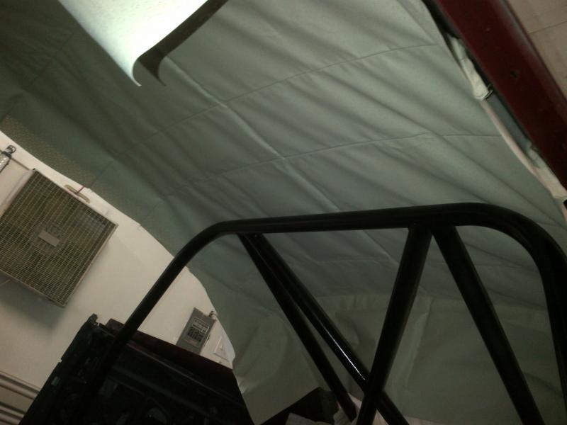

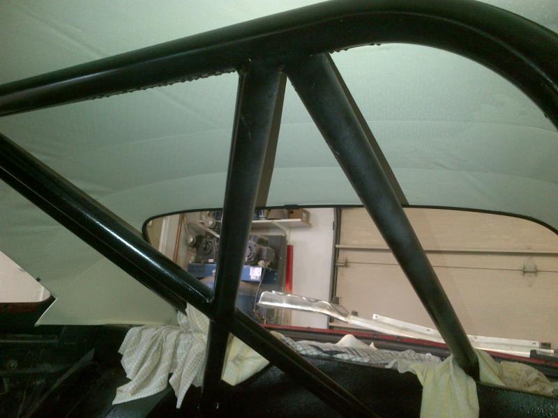

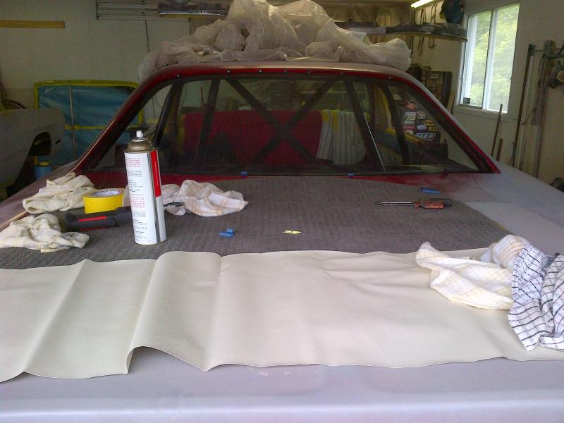

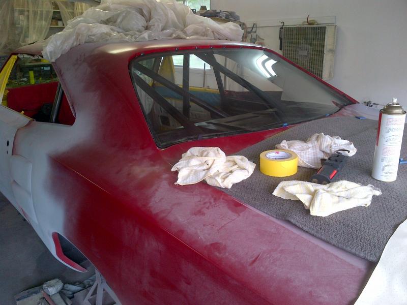

More pulling on the headliner,rear glass molding fitting,and it's starting to look pretty good around the rear window.IMG-20150701-00816.jpgIMG-20150701-00817.jpg
That looks like a pro job to me, one job i never envy anyone lol... I do pray when my turn comes to do it, it looks half as good, naa, i want it to look AS good!!! :)
Thanks Ron,I'm sure yours will be fine when the time comes. I had it all on it,a steamer,hair dryer...lol. I can't even imagine trying to do this with the glass in! One tip...I'm using door panel clips to hold it on the roof rail,they are easy to remove to pull it tighter and don't tear the headliner. Then I hammer on the proper clips.

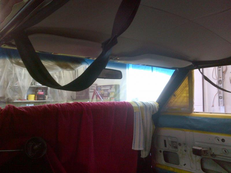

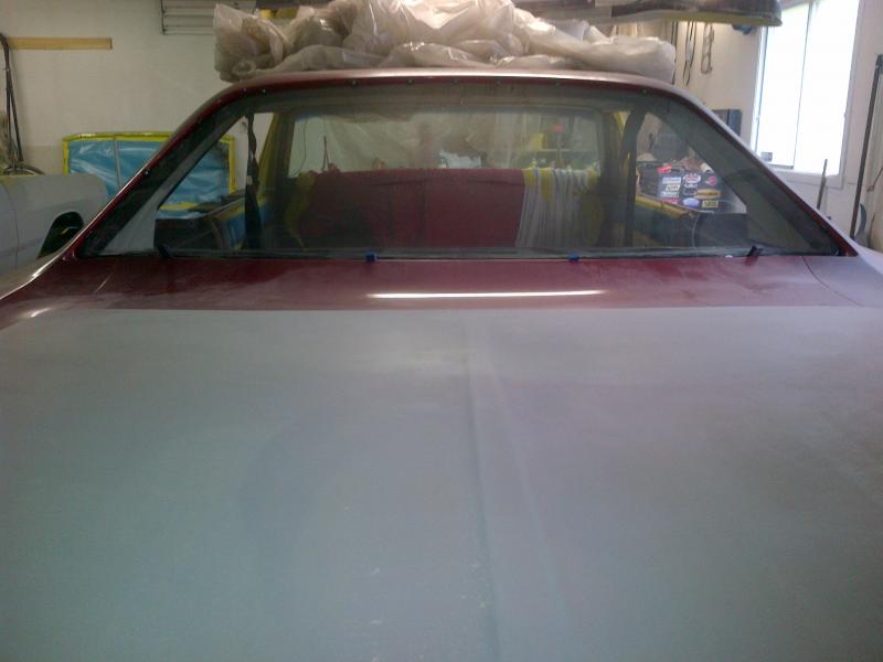

Yeah baby, 4th of July! My favorite holiday...and I'm Canadian! I went with butyl tape for the rear glass. I made some spacers,test fit the glass and then rolled out the tape. I also put a small bead of urethane around the edge of the tape...I don't know why but I did? It turned out great!IMG-20150704-00823.jpgIMG-20150704-00824.jpgIMG-20150704-00825.jpg

Boy I wish I would have done my own rear window, I had it installed with Urethane and it ended up high making the molding really rough to put on. I like the color combo, looks really good together!

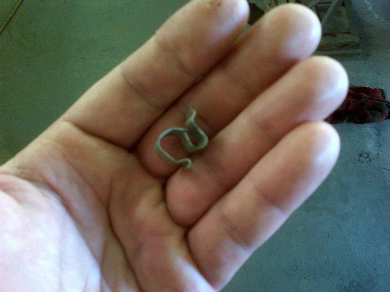

I'm looking for some of these...IMG-20150714-00831.jpg Holds the interior roof rail molding up.

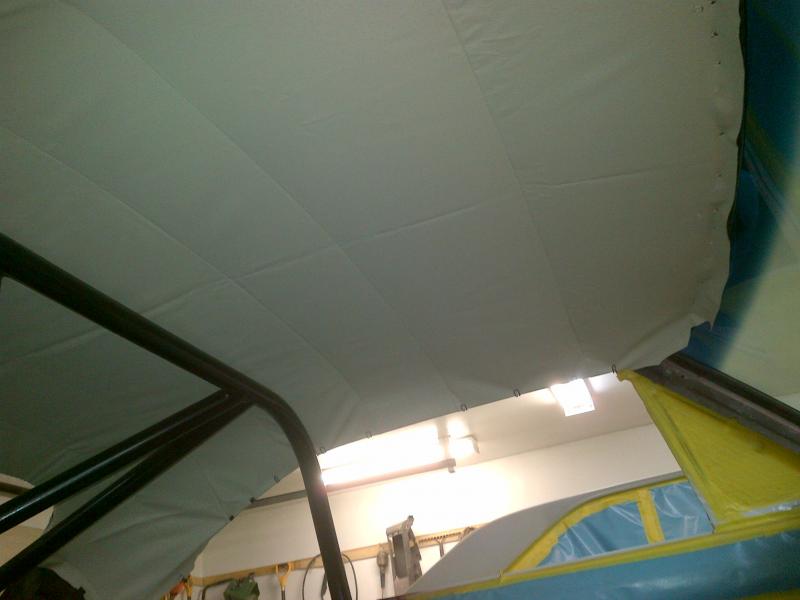

I cut all the cage out of the car,don't need it,don't want it!IMG-20150717-00840.jpg
Well that certainly is a big change.
Yes it is,been thinking about it for awhile....Still stronger than any factory chassis with subframes. I'm not drag racing it with a high powered engine. I just didn't want to see it anymore.

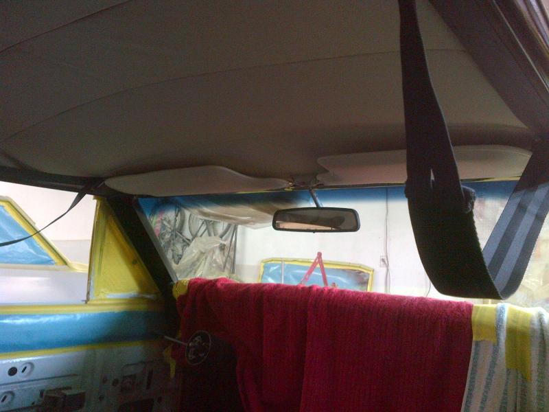

I got the new visors put together and the rear view mirror installed today. Pretty much done with the interior until after it's painted. Does anyone know if you can buy factory looking carpet by the yard...of a roll,or something like that?IMG-20150718-00842.jpgIMG-20150718-00843.jpg

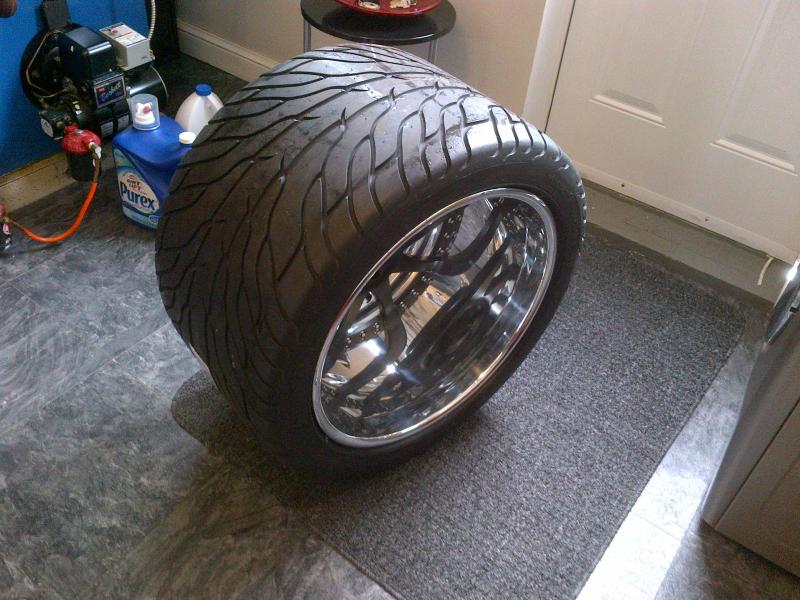

No real updates on the car,I'm in the process of cleaning up the garage and going through some old parts. I did receive my tires and got them mounted. Had to go through a ordeal to get them to avoid the shipping scare from the U S not to mention the horrible dollar. I got a buddy at a kia dealer to get them from a Canadian source that offered free shipping,I did have to pay the Canadian govt $18.00 for a tire fee! I can't make this up! lolIMG-20150724-00852.jpg
