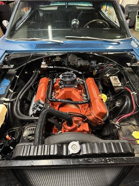

I got my a12 rr a day before my birthday this year and it was an amazing feeling. I tracked and drooled over this car for better half of 3 years. Just no funds and never the right situation. I finally got the new owners number and sent him a text and he was happy to let me look at the car . The car was nice, not perfect but still a decent runner for the money that didn’t need total restoration. Car ran and drove awesome for what it was . I put about 2k miles on it from feb to about June . My quick story on the car .

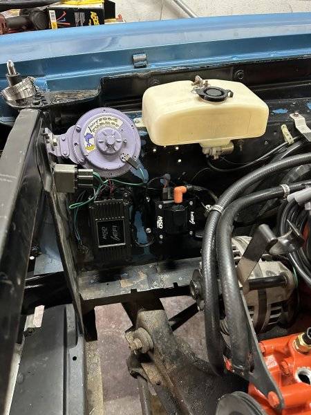

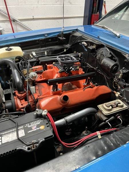

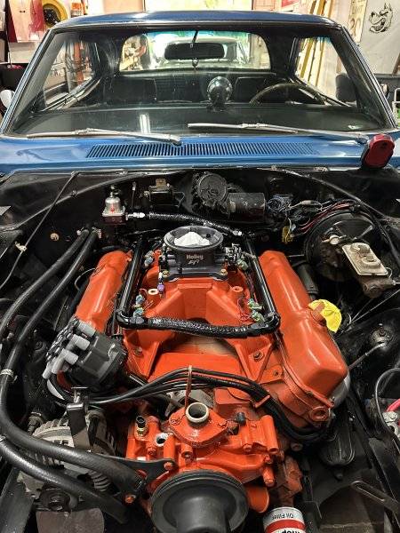

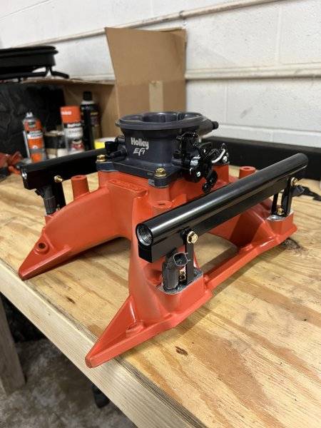

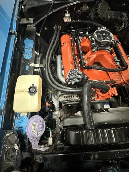

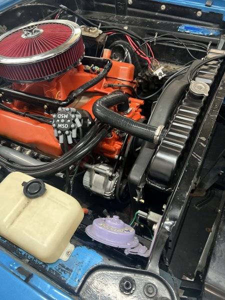

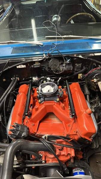

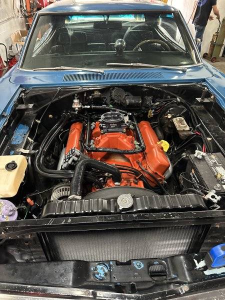

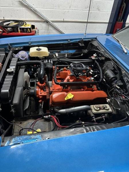

Now the mixed review part . I wanted new tech with the old school feel and look! Didn’t want to do a full blown new hemi swap . But day 2 mods just in 2023! So I gather all my stuff I been acquiring over the last few years from my first roadrunner and said let’s do it. Car is finally running on Holley terminator x stand alone , full fuel system all ptfe line and hellcat fuel pump. Wow Holley stuff is just crazy car clicked off first try with just going down the drop down menu . This is a self learning kit but still will need a professional tune but if u know the software u can also tune it your self . Pic time part 1
to be clear this is just to get the car running and driving and making sure no leaks and fuel system is good and the wiring and everything esle is working correctly. On the other stuff

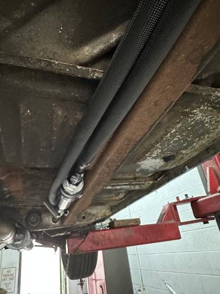

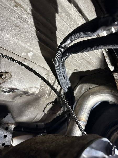

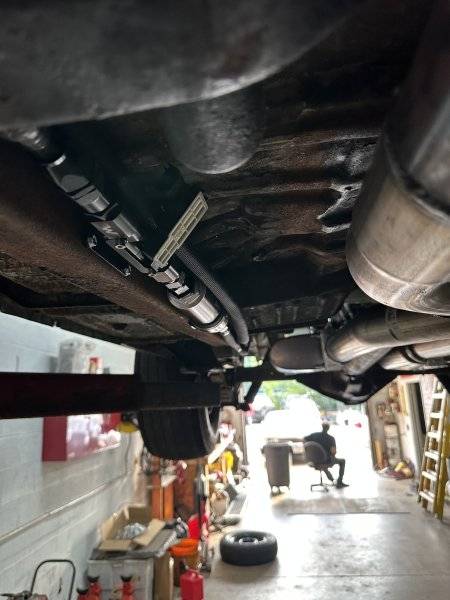

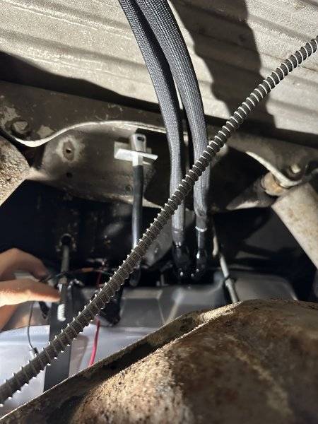

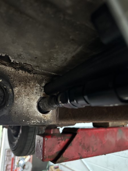

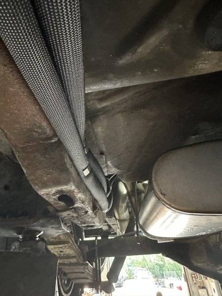

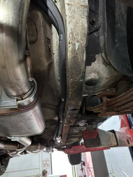

Fuel system is -10 feed and -8 return with a flex fuel sensor in line. Car will be tuned on 87 Oct and full e85. Has a 525lph hellcat pump , Weldon regulator , all ptfe line and fittings and big Holley fuel filter . Tanks inc. efi tank and fi tech fuel hat. And factory GM ls2 injectors for now . Fuel line is covered in DEI fire sleeves since everything is so close to exhaust heat and you can still vapor lock

Yess it a real a12 roadrunner . This was just to get it running and working correctly. I forgot to add a picture

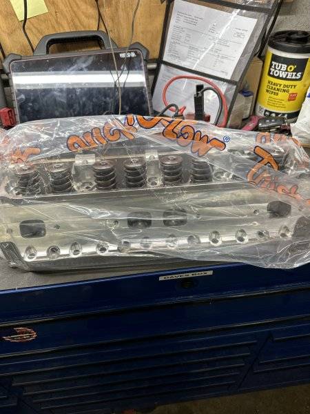

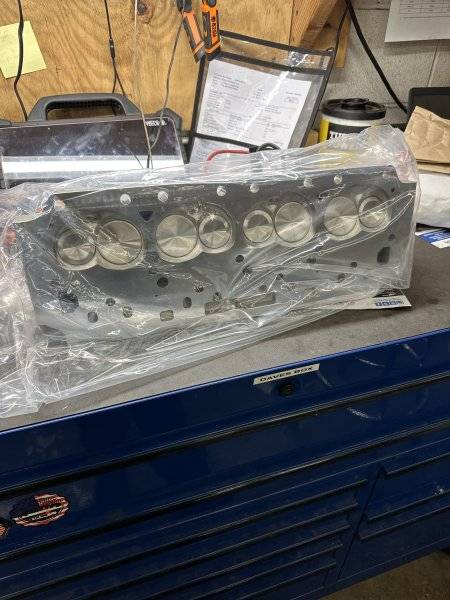

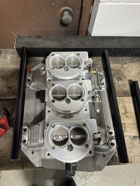

Sorry was at work and forgot to finish my posting . Yes this is a real a12 car everyone . The mix reviews will come I understand . I know what type of car I have . I didn’t want to take away too much of it . Being only 31 I know what these cars mean. That being said . I wanted to get everything running and workin correctly before I drop in my built 493cu with tfs 270MW heads . This car will still be a 6bbl just efi and will retain the factory air cleaner .

Yea I get mixed reviews and I can say this the car runs sooo smooth ! Crazy how alive the 440 feels . Not saying a carb setup can’t be this good cause it can but new carbs or restore carbs are 2500$ . And the engine bay was black way before I was born lol I got pics of the car in the 80s it was black than

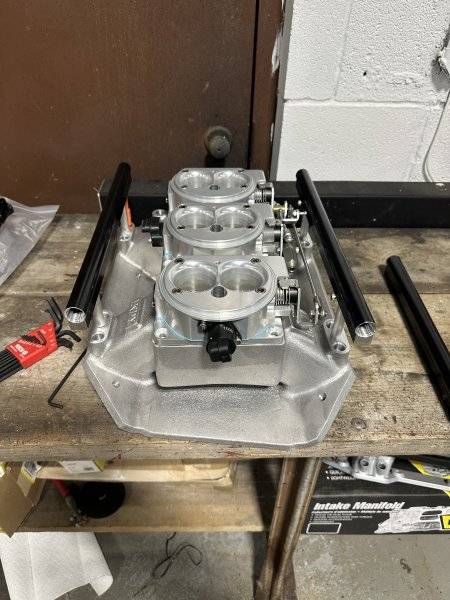

Sorry was at work and forgot to finish my posting . Yes this is a real a12 car everyone . The mix reviews will come I understand . I know what type of car I have . I didn’t want to take away too much of it . Being only 31 I know what these cars mean. That being said . I wanted to get everything running and workin correctly before I drop in my built 493cu with tfs 270MW heads . This car will still be a 6bbl just efi and will retain the factory air cleaner . View attachment 1509190View attachment 1509191View attachment 1509192View attachment 1509193View attachment 1509194
Is the 6 pack/barrel set up Holley also?
I wanted to pass on the fitech 6bbl option and I wanted to go MPI that’s why I went with the terminator x .
That answers that question I was going to ask.

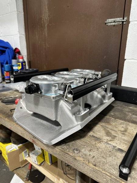

So that's the F&B fuel injection throttlebodies system, right?
I like the FiTech 6bbl, but 600 max HP would have lowered the anticipated power of the 572 I'm having built.
I'm starting out with my Promax modded Holley 6bbl carbs on the ModMan intake (for hood clearance) but if I go to fuel injection the F&B is the move!

no this is a custom fuel system. everything i got through different places. mostly Summit racing. a return fuel is very easy. just finding places to run and mount everything on a uni-body car .
