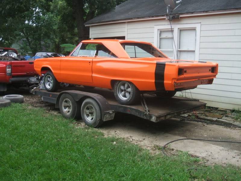

That is a very nice 66' you have there..The 800 is the right carb for your setup..The cam could handle more, but the heads can't..How much compression?

Daredevils car:
