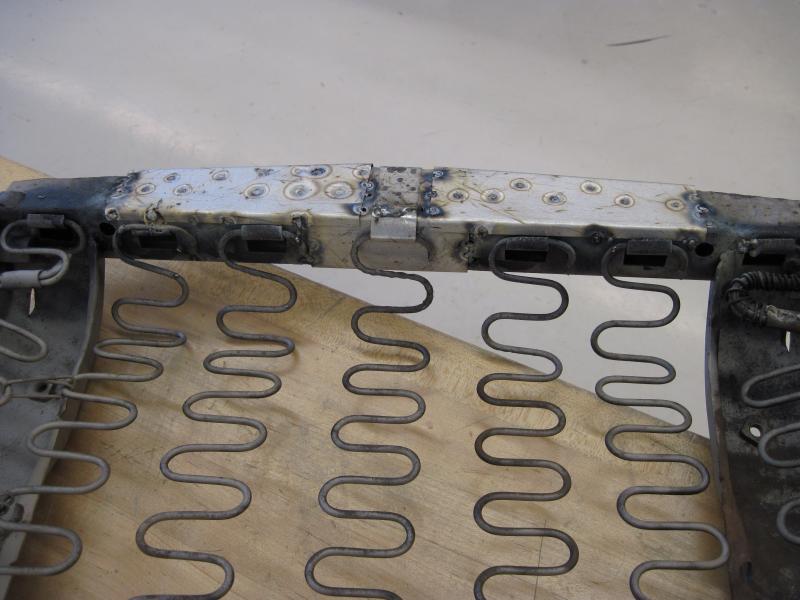

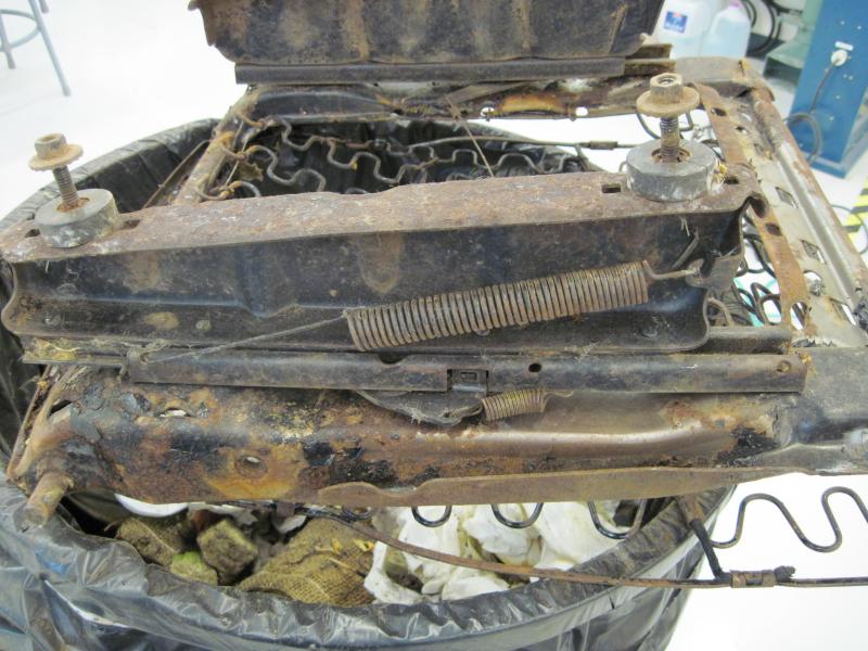

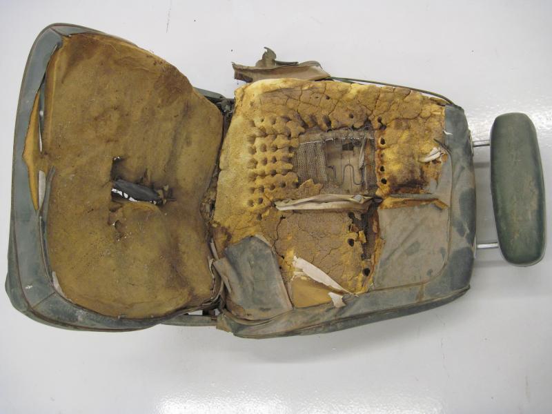

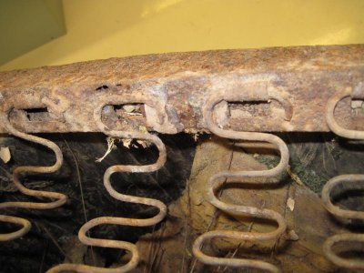

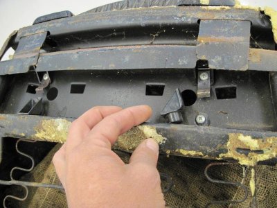

Here are my front bucket seats and some of the things that I had to do. passenger bucket seat 002.jpg

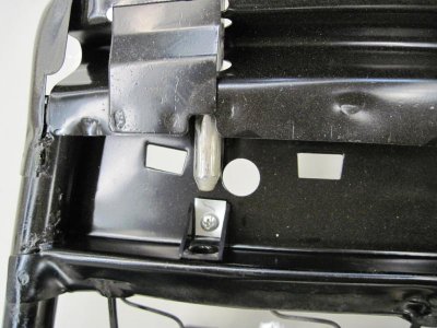

After removing all of the upholstery I dismantled it and sandblasted it in my cabinet blaster. My seat frame was broken and split so I had to straighten it and weld it back together.

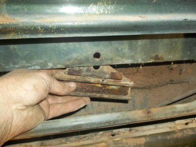

On the previous pictures the lower plastic headrest guides were broken. I found I can buy new ones but they are expensive. I used a drilled piece of sheet metal to support the bracket.

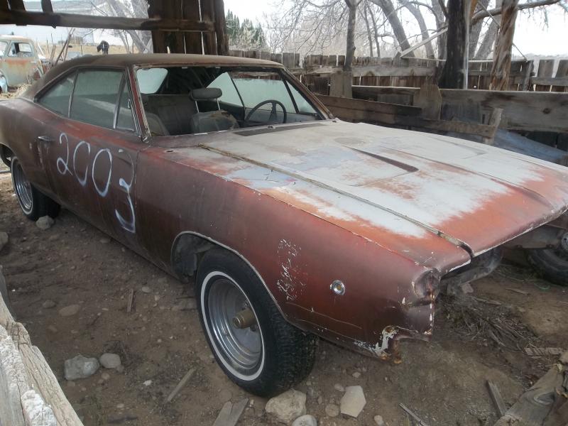

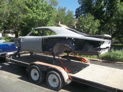

I have been working on the seats right now so that is what was on my mind. Here are a couple pictures of my car and the progress that it is making.

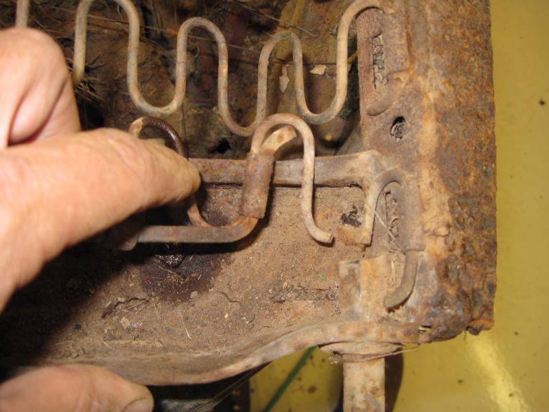

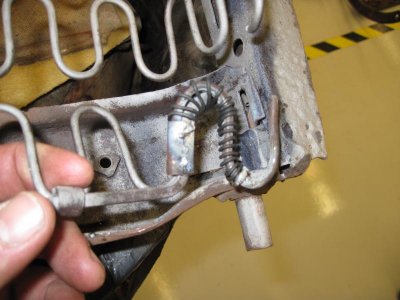

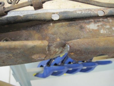

The driver side seat was in rough shape. The rear of the lower seat was rusted, the side rail was cracked and the outside spring was broken.
After sand blasting, cleaning it, and welding it Ibuilt some reinforcement for the back of the seat. For the broken spring I used a piece of spring from a doner seat and splinted the spring.

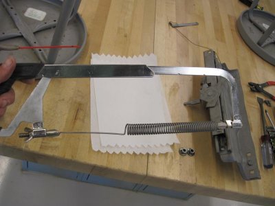

To sand blast and paint the springs I used a hack saw frame to stretch it.

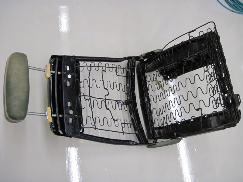

I cleaned the old grease and dirt out of the sliding rail barings with a solvent and re greased them for smooth sliding then I repainted all of the parts.
My front bucket seats are ready for upholstry now.

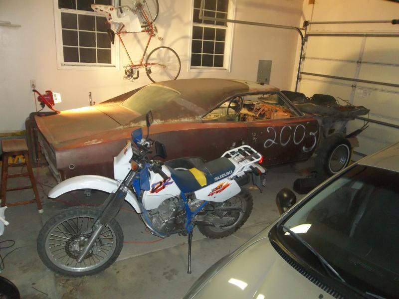

This summer I spent a lot of time disassembling, taking pictures, storing, and logging all of the parts. I would lable or point to each part and take a picture of it. I would then bag the parts with a lable and a black & white print of the picture where the part was taken from. I know that when I start reassembling this car I will not remember where things go.
Here are a few of the pictures that I have taken.

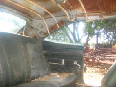

This is the car's interior before taking it appart.

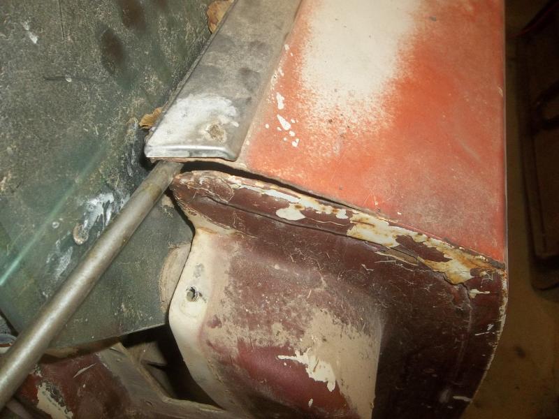

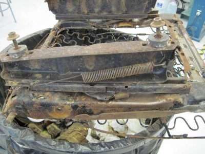

I made note of all the thisng that would need to be fixed. This is a split in the sheet metal on the drivers side.
