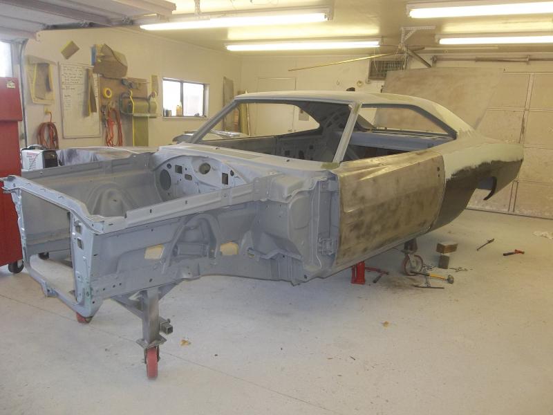

I can do good grunt work but, after putting this much money and time into this car, I would like a professional paint job. Now that I have all the panels fit I am sending it to Bob Martin. He is a local auto body man who specializes in restoring classic cars. I have seen his work and feel like that he will do the job that I want.

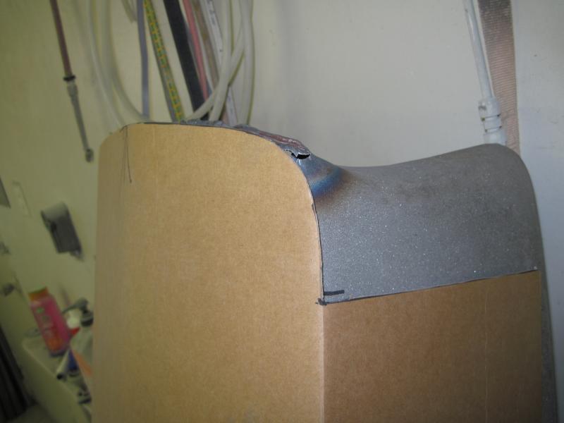

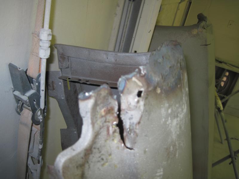

Left fender nose.
This is a cardboard pattern of the nose. Trying to match the correct shape.
After messing around with my fenders some more, I decided that it will cost about the same to pay a professional to fix my original fenders as it would to buy new AMD fenders.
I am OCD on some things and know that after I have my fenders were fixed with welds, patches, and bondo, I still might not be happy with them.
Long story short, I ordered new AMD fenders from Summit.

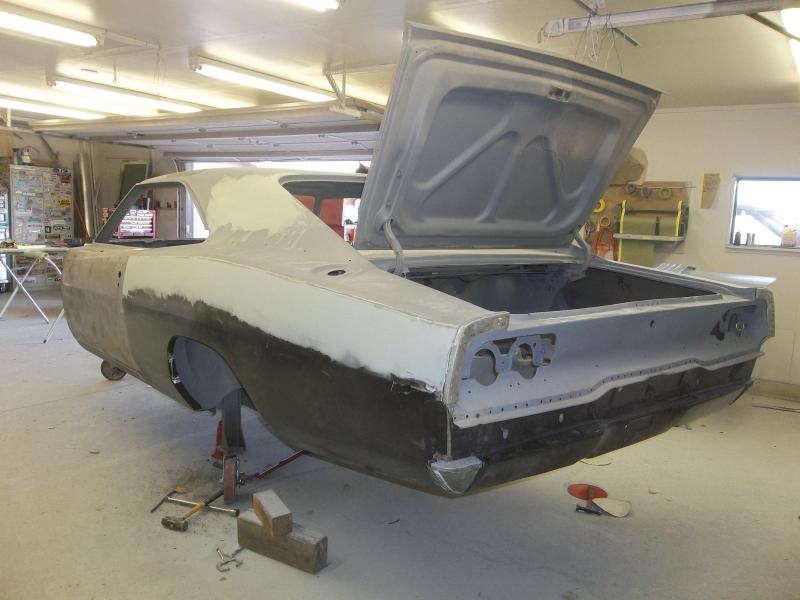

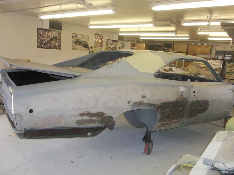

I have been excited to watch my charger body get straightened up and primed.
Man, ill tell ya what i can understand why! She looking good, im having fun with my work but checking in hear, its good to hear some happy results!!! I sure love the tail lights in these 68's, even before i could legally drive it was one of my favorites, my brother in law (now) his 1/2 brother used to hang around him and Karl and i were always doing something at his dads garage and he had one, he was a crazy kind of guy but had one of the coolest cars i seen back in those days, his was the ive green i guess they called it but it was a fast 4-speed machine!

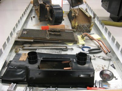

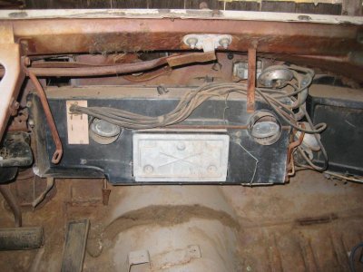

On the side I have been working on restoring some of the subassemblies. One of them is my heater A/C box.

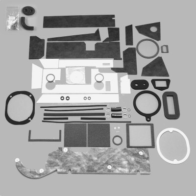

I have totally disassembled it and started to clean each part. I also bought a rebuild insulation, seals, and gasket kit from Detroit Muscle.

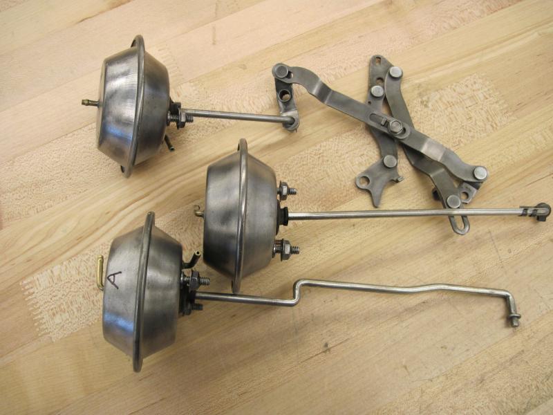

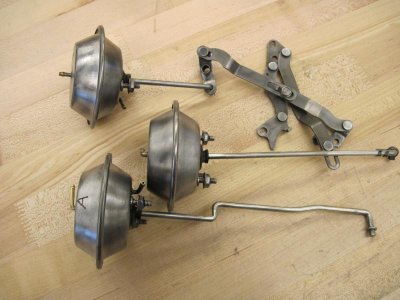

I got the A/C vacuum pods and linkage all wire wheel cleaned and they seem to work well.

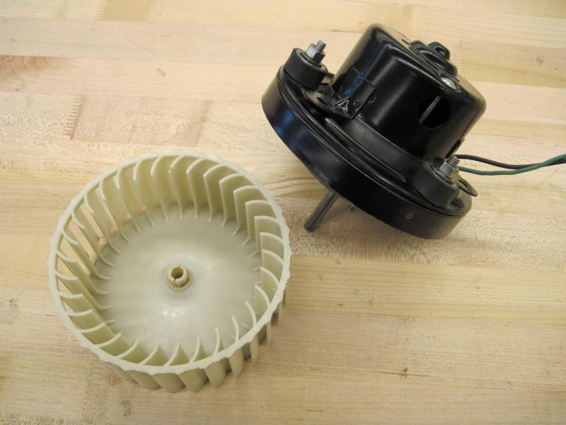

I took the blower motor apart and cleaned all of the dust and rust out, cleaned the brushes, and repainted. The plastic fan also cleaned up nice. I tested the motor and it also seems to run well.
