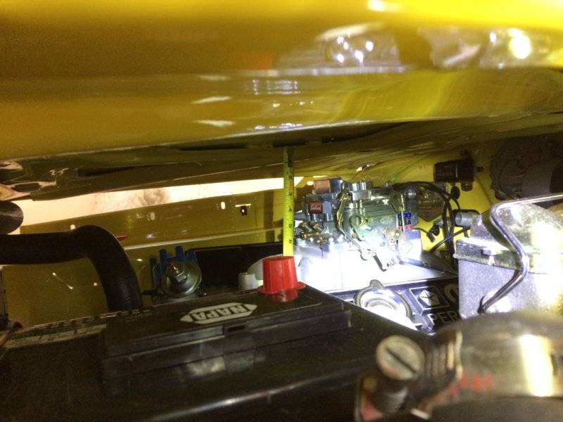

To find how much clearance I had above my carburetor I set a retractable measuring tape on lock on my engine close to the carburetor and gently closed the hood so that it would push the tape down. I had just under 3".

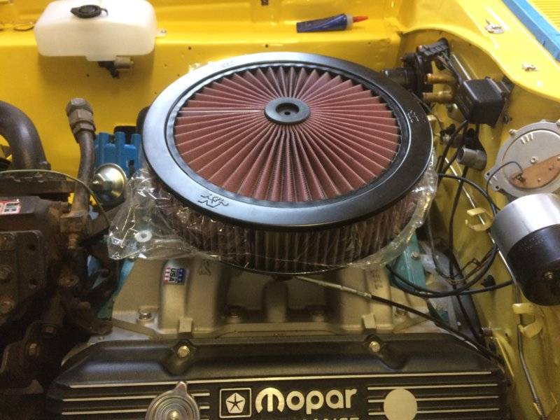

I spent a lot of time looking and trying to decide what I wanted to do. I looked into doing as Threewood suggested and try a ford 13" drop base so I could keep the stock looking cap. It is possible with a shallower air cleaner (2 1/2") and a drop base, but after I considered it I was not comfortable with how little air intake clearance above the carburetor and felt like it would resist air flow so I chose a 14" drop base with air flow through the top also. I might have been alright but I feel that it will have better breathability this way. I had to drop my clearance almost 2" This K&N seems to fit about right.

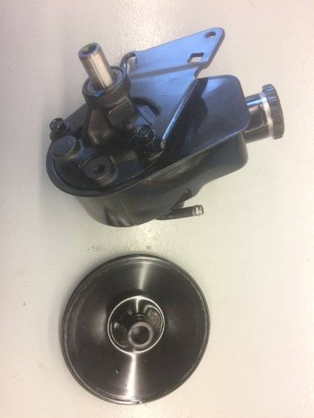

I'm having a hard time finding a power steering pump for my car. My car didn't have one so I don't have the pulley either. Do any of you have any suggestions where I can find one?
I know there were 2 brands I think Saginaw is one. I see if I can find where I bought mine.
I'm pretty sure it was year one. You might check Mega Parts also.
Just checked Mega, I didn't see the pump, but they had brackets, pulleys, cap, ect. Might also just try the local parts store.
Thanks for checking. I have checked with the three local auto parts stores here and they all don't have one and there not available in their warehouses. The Saginaw uses different mounting brackets but I will keep checking.
I have a pulley and pump if needed.
Thanks Glenwood, I will PM you.
I did finally find a OER number for one and I have found a couple but they are pricey (like everything else on this car).
OER #PS6157
I tracked down every vendor that I could find that has listed OER #PS6157 and they didn't have any in stock either and the pump would be shipped from the manufacturer OEM. I contacted OEM and my contact was a little miffed that someone from the "General Public" would be contacting them and let me know that the power steering pump was on a "long term back order".

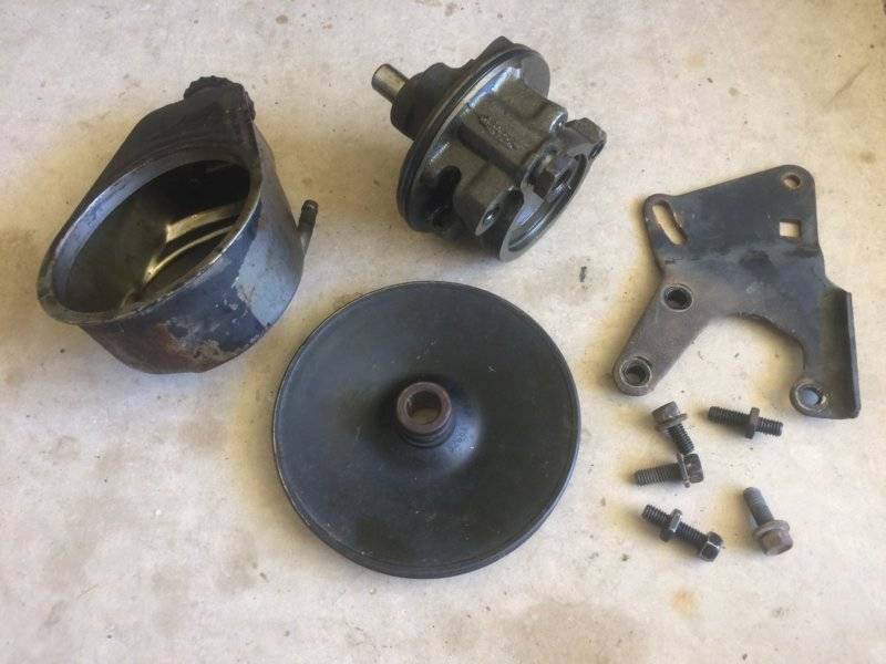

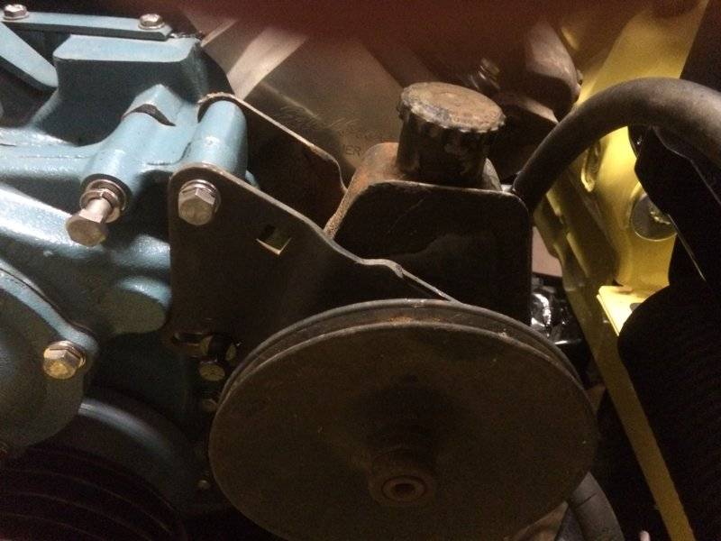

I have been surprised how hard it has been for me to try to find a Federal power steering pump for a 68 charger. I was looking for a Federal pump because I have the brackets for that style of a pump. The only option I ended up with was a TRW style pump that Glenwood kindly offered, thanks. I spent the afternoon digging through parts that I had stored years ago and found I had two power steering pumps I had forgot I had. I had a TRW style pump from a 75 Furry and a Saginaw pump, both with brackets.

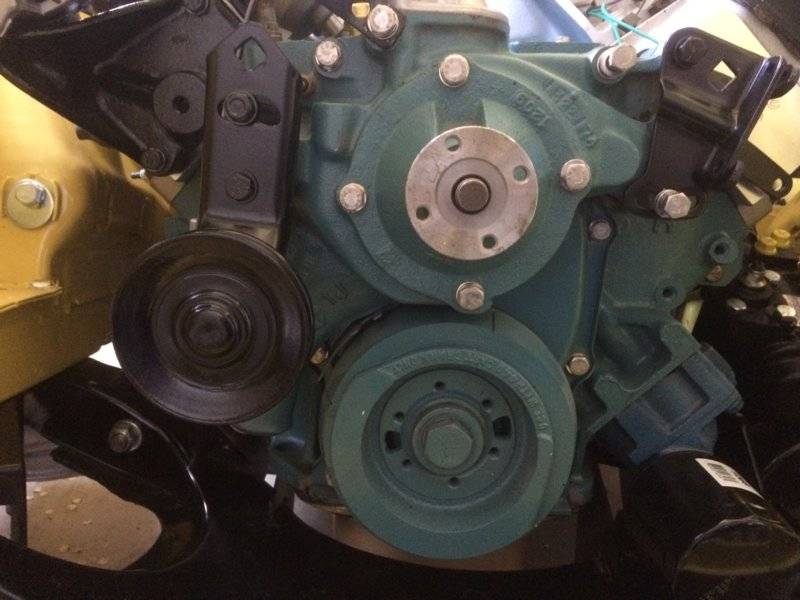

This is my Federal pump bracket.

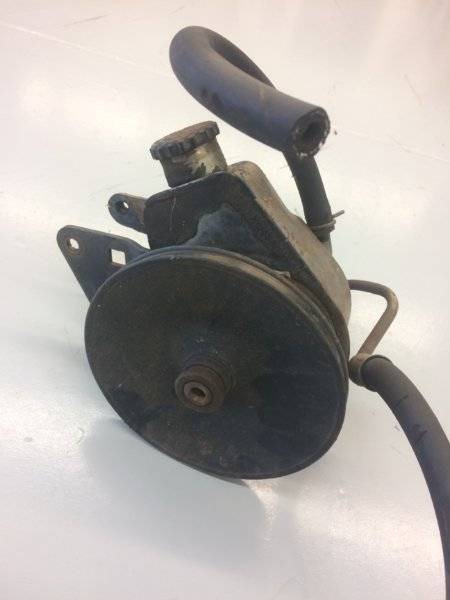

TRW Pump.

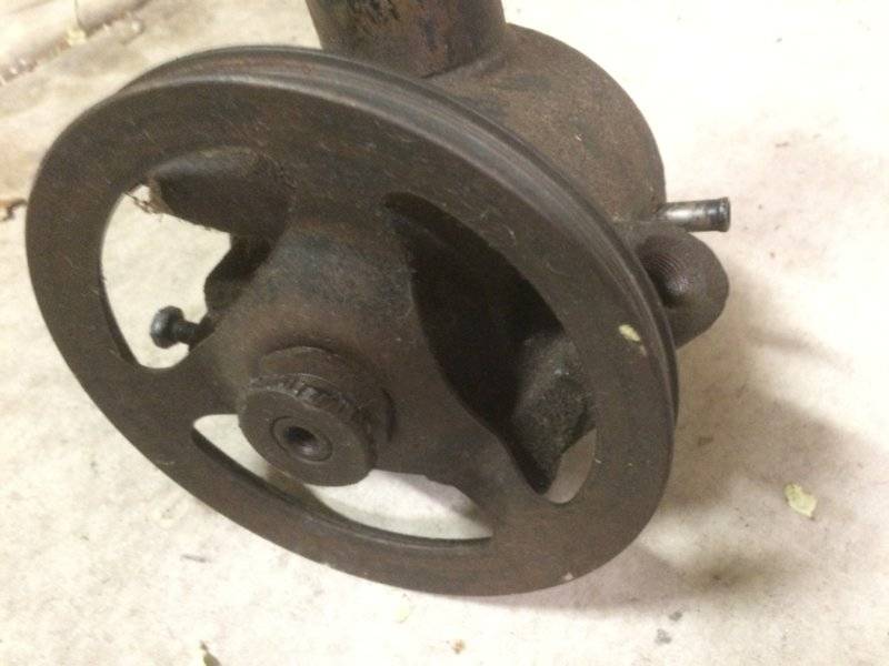

Saginaw Pump.

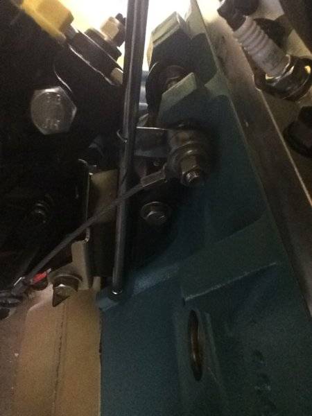

I got a few more things done on my car this week. The hardest thing by far was trying to get my oil dipstick tube installed. Maybe because I bought a cheep dipstick or because I couldn't get any leverage. I spent hours filing, sanding, and retrying to insert the end in the block. I finally put it in the freezer and then had my son push from the top while I tapped it in from underneath.
I had an NOS tube and with engine out of the car it was a BITCH! Not sure I would have got it in with engine in. I even made up a sleeve to go around it and hammer it into place.
I'm glad to hear that it's not because I'm challenged. I used a fitted wrench to hammer mine in place.
I have to agree....it was the biggest PITA to install.....I tried all the tricks.....They are tight for good reason but man how many hours I wasted on this one little thing....I use a box end wrench and a hammer.....

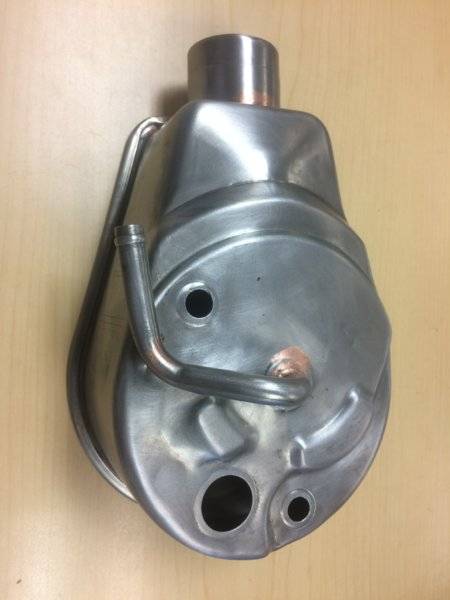

I was able to get a rebuilt power steering pump core at the auto parts store. It was not very expensive but I had to reuse my reservoir. I took it apart, cleaned, painted and rebuilt it ready to install.
