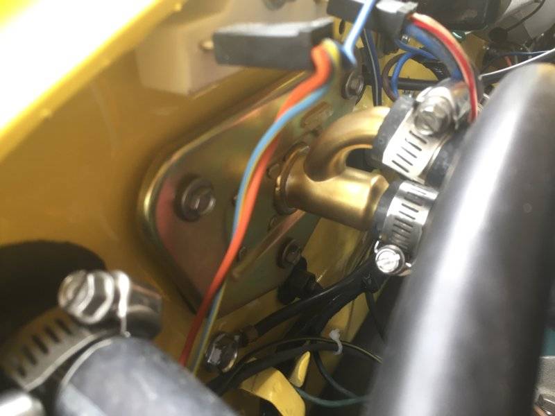

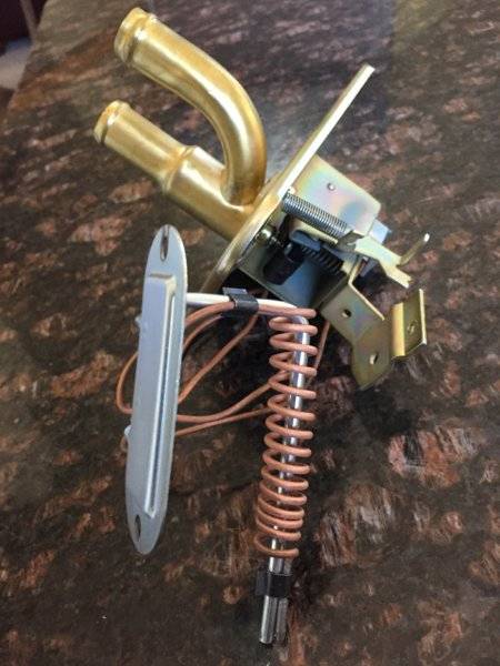

I got my heater control valve back, from being rebuilt, from Classic Air. I reinstalled it and it seems to be working well with no leaks. :thumbsup:

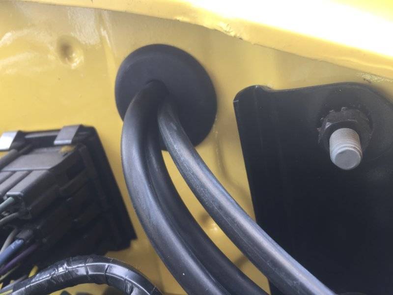

I couldn’t find who sold rubber grommets for the firewall hole for the headlight vacuum hoses. I measured the hole size and found a rubber insert the right size from Steel Rubber Products. I did have to ream the center out to fit the 3 hoses but I was able to custom fit it around each hose. I finally got the headlight doors hooked up and working. Of coarse I don’t hook them up correctly the first time and had to swap a couple hoses at the switch.

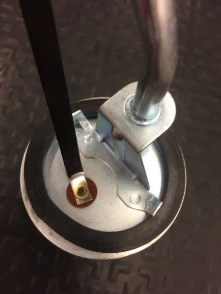

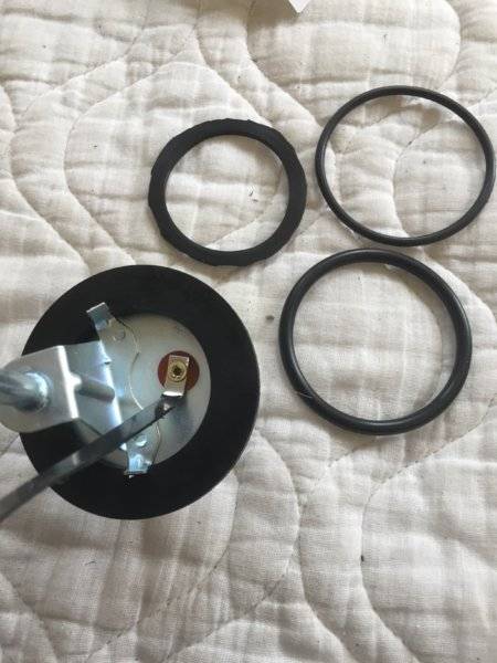

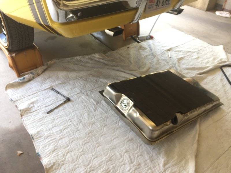

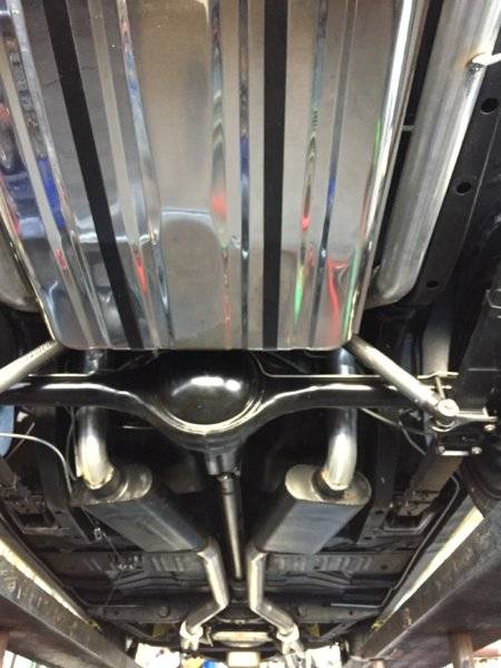

I’m still slowly working out some bugs. Previously I have only been putting a little gas here and there in my car, now that l’m venturing farther, I took it to the gas station and filled it half way. (By the way, that car was the center of attention there. Several people gathered around asking all kinds of questions). When I got home I noticed that I was leaking gas. I jacked the car up and found it was leaking out of the main seal. I siphoned out the gas and dropped the tank. I noticed the seal was distorted and too small. I spent the day running back and forth into town trying to find a new seal that would work. I finally found an extra large one that worked great.
One more problem fixed.

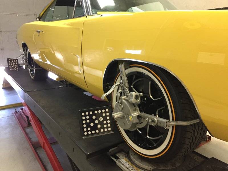

I took a longer test drive today. Every time I take it out I try to tune up more problems. It seems to cruse good at higher speeds but I still need to adjust my kick down linkage and transmission. It seems to start out in second gear and skips first gear and does not kick down when stomped on.

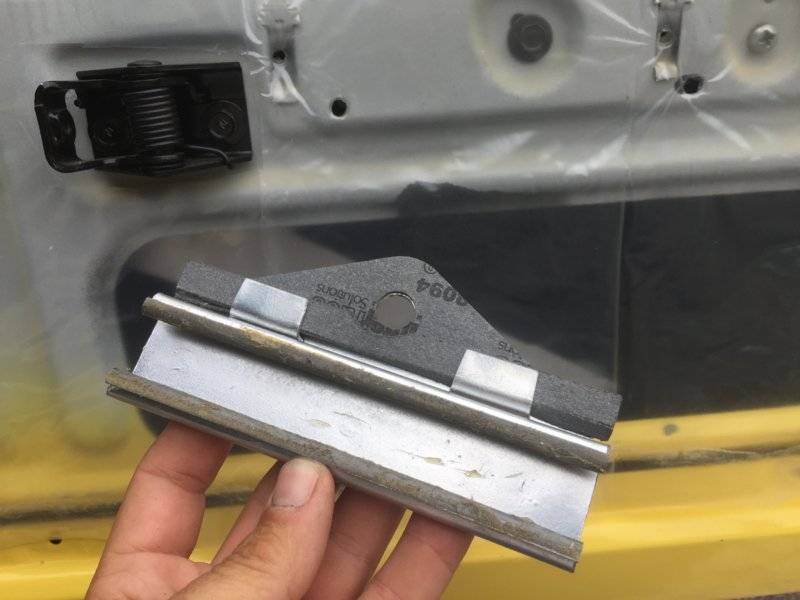

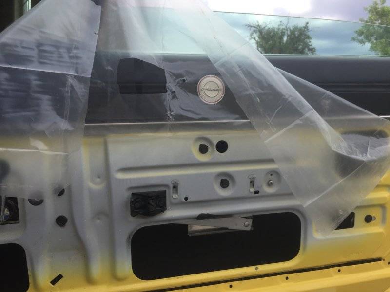

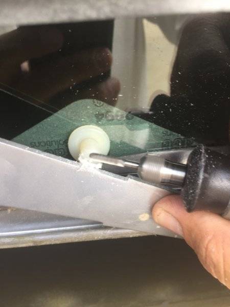

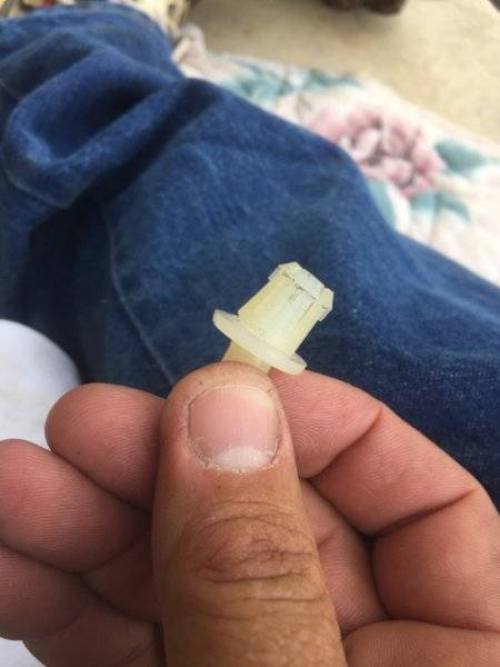

I took my wife for a drive the other day and as she started to roll down the passenger side window we heard a big clunk as the window support fell to the bottom of the door. When I opened it up to see what went wrong I found that the nylon plug that held the window in the bracket was too long and was hitting the arm as it went up and down, bending it and pulling it out. I was able to shorten the plug and re secure it back in and it seems to work well now. My wife was feeling bad that she broke my car but I was able to show her that it wasn't her fault.
I'll watch for that during assm. Thanks!
That plug has to push in to lock the holder.....
