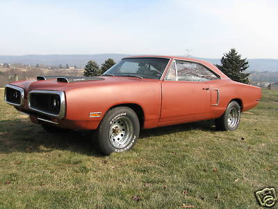

Hi, as a new member here I will start my project with a short presentation of myself and the car.
After 12 years without a real car, (but with various European junk) the 40-year crisis struck with full power and I searched for a project. Found it in MD and two months later the car arrived to Sweden. The car is a 1970 Dodge Coronet 440 with a 383 and a 727, got a 8 3/4 with unknown gears. The seller was a real nice guy and I bought me a new interior and some other parts and he packed the car full before it was shipped.
The car war originally a 318 car, red with white vinyl top and with interior, since I´m not a resto guy or think that a 318 car are worth an original retoration I will build the car as I want it.
The plans today are Hemi orange paint, black vinyl top, black interior and centerline telstar 7*15 and 10*15. I dont really know what has been done to the engine but it is a -69 383 with a pair of older 516 heads, 68-70 HP exhaust, torker 383 intake and an Edelbrock 750. I mesured the cam on the liters and wiht a 1.5 ratio the lift would be 0.525", it is a hydraualic cam. That is pretty much all I know about the engine, the tranny is stock with stock converter.

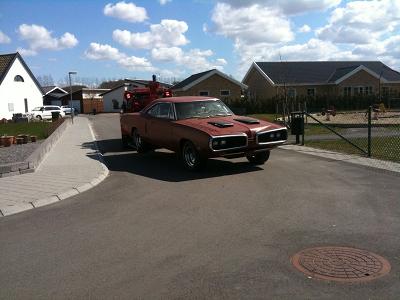

The engine now runs great with new plugs so I will leave it that way for now, will spend my time with bodywork and some rustrepair.
Hope to get the help I need from you guys, I will keep you updated with photos!

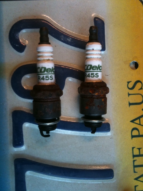

Take a guess why the car did´t run well before...
