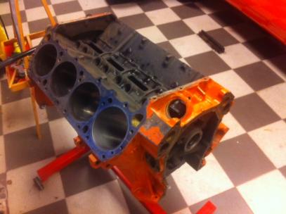

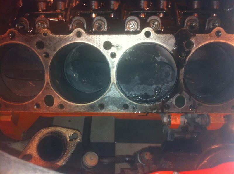

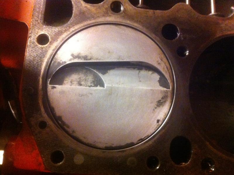

Pulled the second head of and it looks worse then it is in the picture due to water and oil but at a second glance the number 2 and 8 pistons are mounted in the wrong direction, hmm, looks like it will be a little more work than I first expected.
And it seems that the block is not even either, when I measure how far the pistons are down in the hole the top number is 0.040 for piston number 1 and 7 but number 2 is only 0.020 down and number 8 is 0.030 down, nothing that can't be fixed but did they came like this uneven from the factory?
Will buy a Flex-hone and get some new rings along with the new bearings if I don´t find more trouble in the bottom of this Pandoras box...
You'd be stunned Swede on how many blocks have a wacked deck height on each side. Both my 512 and now 340 both were way off.
That's crazy with those piston's! How does someone miss that?

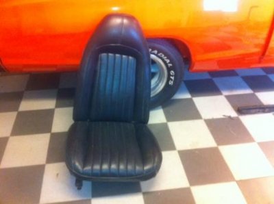

Ran into a set of E-body leather bucket seats, they are in an incredible shape! Only has 4400 miles and are soft as a babys ***! Problem is that the tracks are to low, will start a new tread about the right height.

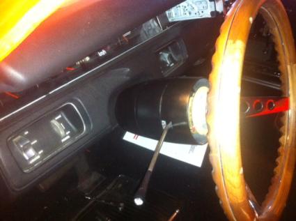

The next problem was the column shifter, took it apart and cut of the shifter and indicator parts, look great now, had to buy a new coupler from a Mr Slater in MN, arrived in no time.
Why a new coupler? Because I am skipping that power steering and go manual, found a manual gear in Sweden and with new seals and gears it works great.

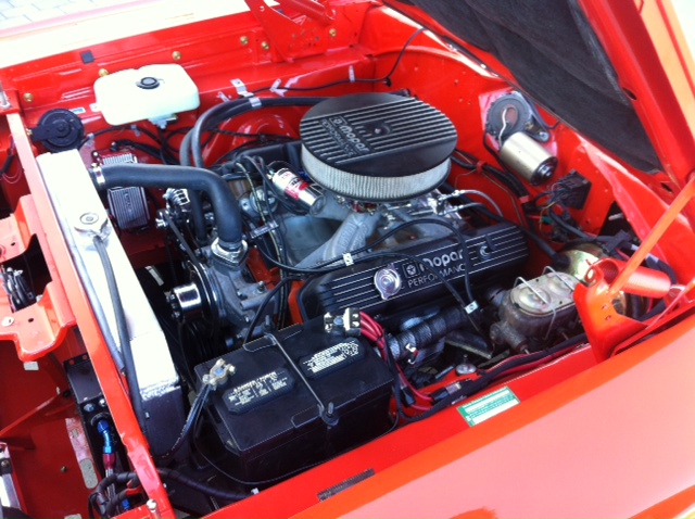

And this is not enough, the engine is getting a new cam shaft, the MP 284 and a set of headers, this will probably get me the character of the car that I want.
And finally, a new stereo is already installed in the car!
When I put all this together it is a weight saving at the front of 120 lbs, power steering, intake manifold, water pump and housing, mini starter and the HP exhausts!

The local engine guy here is a Mopar fanatic. He has a 64 Plymouth Valiant he drag races with a 273 that produces 550hp N/A. Anyways, he told me a while ago that it's not uncommon for Mopar blocks to have .010 to .040 difference from one side of the deck to the other from the factory. He also said he rebuilt a 440 for a 70 Charger. The guy had owned it since new, the motor had never been touched, and it always had a slight vibration. He took the motor apart and found that the #6 and #8 rods where 6 pack rods and the rest were standard 440.

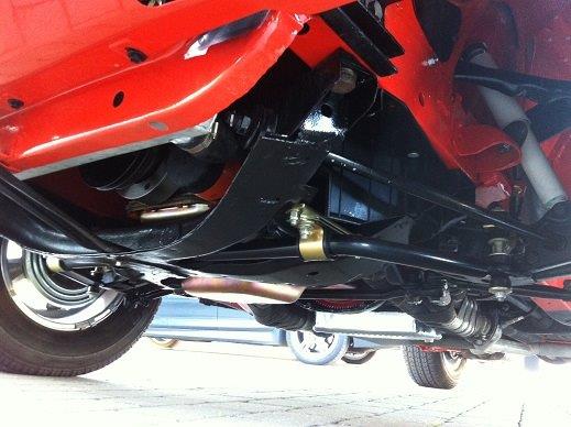

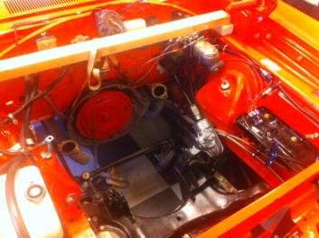

Here is some pictures of the progress so far, The steering is ready, the collars too, cut the gear indicator off and did some grinding, ended up pretty well.
Have not been able to mount the seats yet, waiting for a console and will see if it is possible to have it together with the quicksilver shifter.
The block is cleared up and I will take it to the shop next week, got me a Flex-hone and tried it on one cylinder, the result was great.

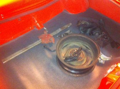

I also found a complete jack and a rim.
