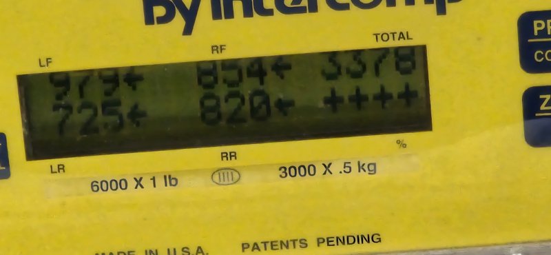

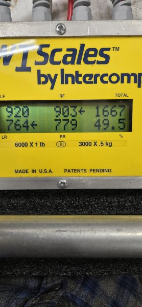

Got the scales out today. Add 210# in the driver seat, 200# for me, 10# for my suit, helmet and safety gear. A bit of an eye opener. Right rear is 100# heavier than the left. It should never go right at the launch. Raised the front by the center of the K frame until the tires were off the scales. Now the RR is 20# light. That uncovers the issue. When the front tires come off the ground all preload from the front is lost. Now with negative preload in the rear during a wheelie the car drives right. With all 4 tires back on the scales the right ladder bar preload is loosened. Each flat on the hex is counted, 8 flats. That number is way high. How did this all happen? Over the years the car has set high on the right, low on the left front. So what did I do? Cranked the LF torsion bar tighter. This also adds preload to the RR, until it wheelie. All shock adjusters are fully loosened to check for bind. Scale readings don't change. Time to start over fresh. The right ladder bar pivot bolt was removed to eliminate any rear suspension influence on the front suspension. The torsion bars were adjusted to level the front right to left. The bolts now are with-in 3/32" of being screwed in the same amount. Previously the left bolt was screwed in about 1/2" further. With the front sorted out the car measured at all 4 corners. The front and rear are both level side to side exactly. Now we move to the rear. Measuring the height of both rear springs the LR coil over platform is one revolution higher than the right. They are adjusted and equalised. Next set preload. With everything level and no preload the RR is light. By extending the adjust it raises the front of the right ladder bar. It only requires 2 flats to get the RR to 25# heavier than the LR. This will be a good starting point. Now the car only sets about 1/2" higher on the right than the left race ready with drivers weight and fuel. Amazingly the right to left weight bias is now 50/50. 54% on the nose. Much more confident about a 9 hour trip to the track now.

Car went dead straight at St Louis. Had 40 lbs hung on the nose to keep it from carrying the wheels past the 60ft clocks. Running Lapeer past the 660 is a little spooky. The pavement looks as well prepped at a parking lot. Car moved around when it came off the preped area at 125 ? mph.

Well. I think that first off I’ll read the chassis adjustment about 6 more times. Also thinking that being about a hundred HP and close to a second shy ain’t so bad after all. Still planning to get on a real set of scales but I’m almost afraid to know now. Just thankful mines been going straight when on 2 wheels.
It's amazing how screwed up it can be and go straight. It all has to do with how soon the wheels come up. Look at this Pic this is what the scale readings were before the redo. Compare the cross weights LF/RR vs RF/LR to the current setup.
