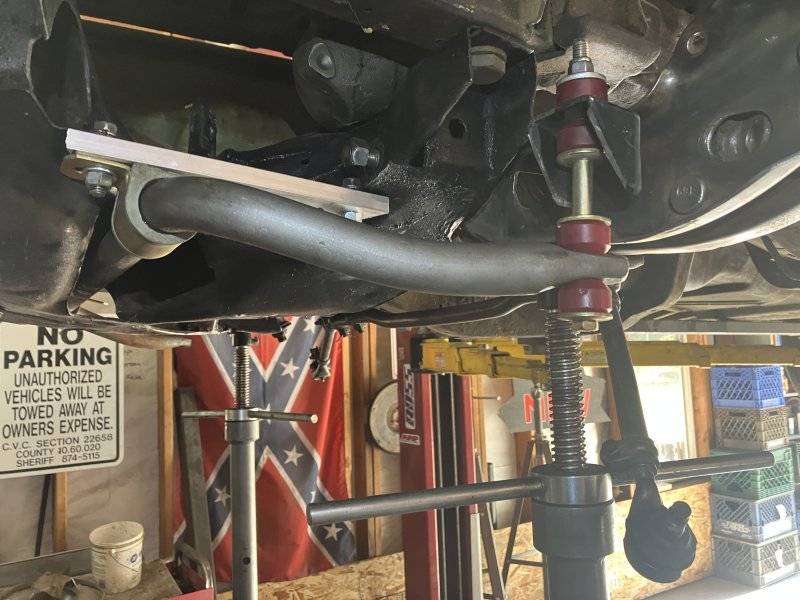

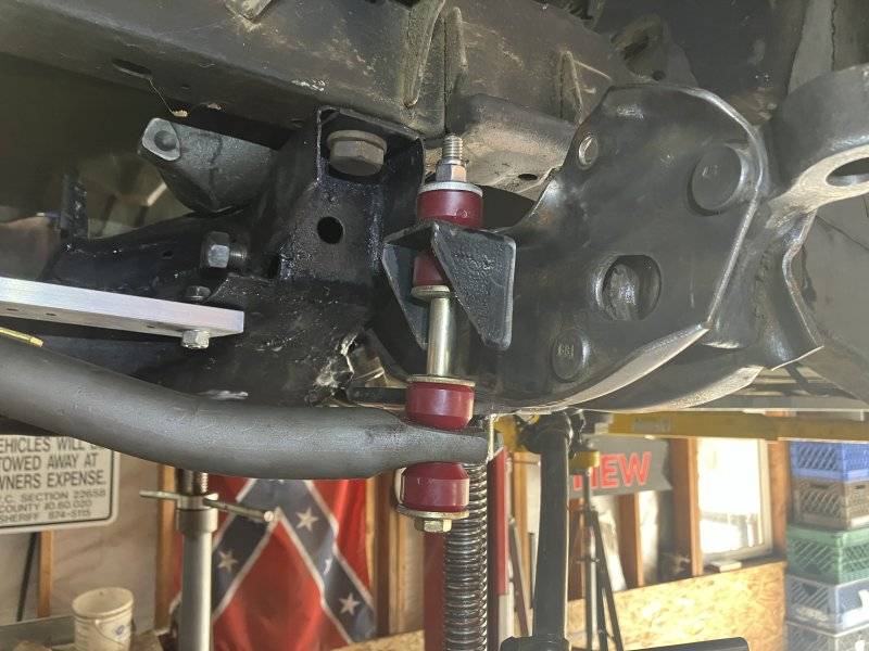

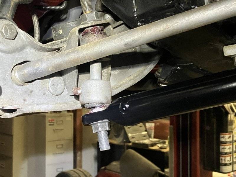

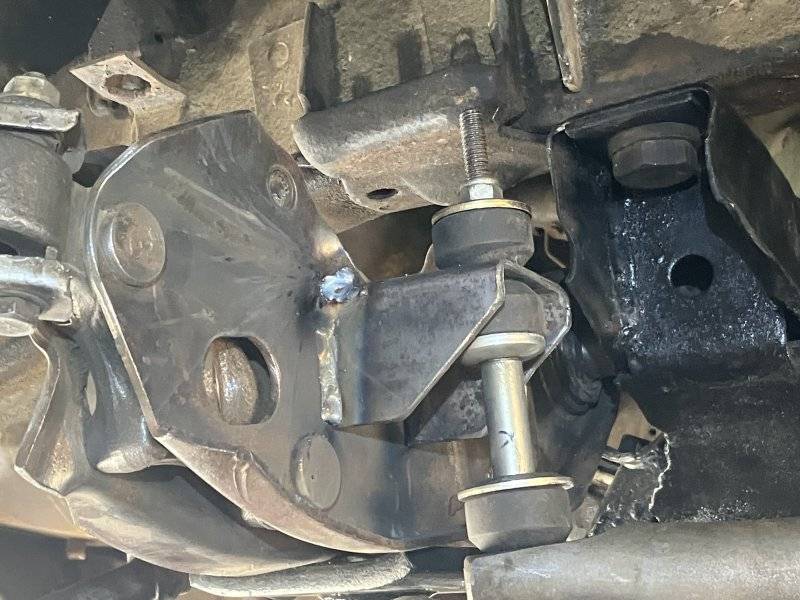

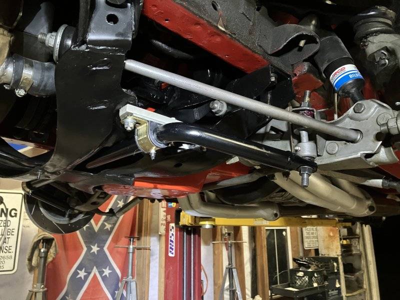

That is disappointing that you couldn't get the GM bar to work. These pictures are of one of them in my 69 Dart 4 door.
The first picture is me establishing where to weld the custom end link mount on the control arm:
Note the curve of the bar.
I could shorten the link a bit to tuck the bottom in a bit tighter...
It fits and works though. Maybe the curve helps fitment?

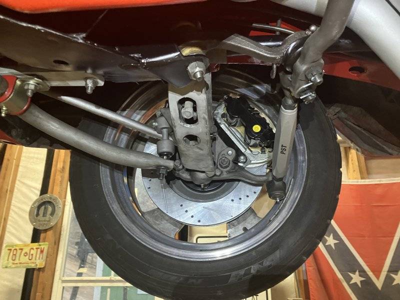

Fitment on my Charger, first was prior to 2022:
2022:

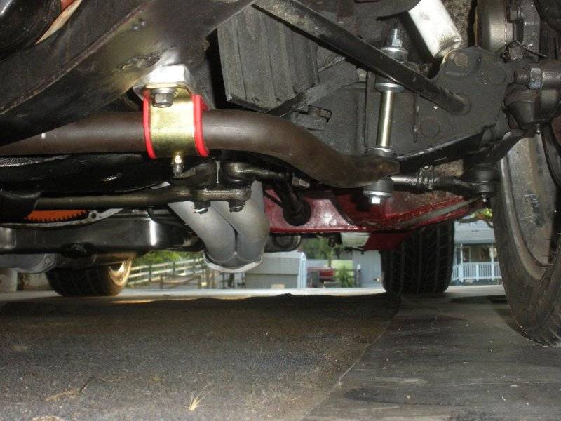

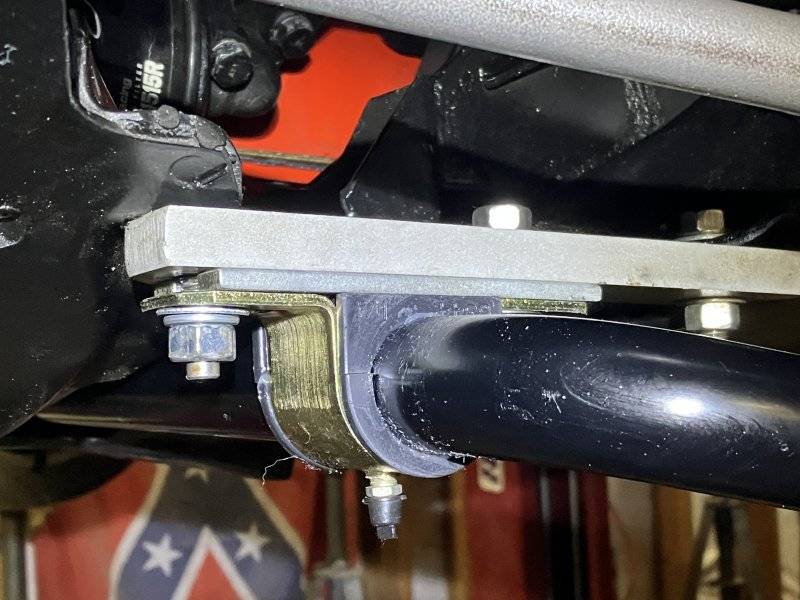

Now with a QA 1 bar with no banana bend like the GM bar has:
It was looking like the QA1, pic 1. But the link was at a more severe angle top and bottom. Part of my problem might be the current ride height. I'm an inch +. That seems to make the tab angle conflict with the flats angle on the bar. After I get some miles on the car, going to Fresno Thursday to get my short block parts from Mike Silva, I'll drop it down some and see how that looks. The FF bar and regular links worked better for now. I'll get the car back in for a re-check on the alignment next month sometime. Will get the thrust angle issue resolved beforehand. And get it all groovy for the drive down to Woodley next month.

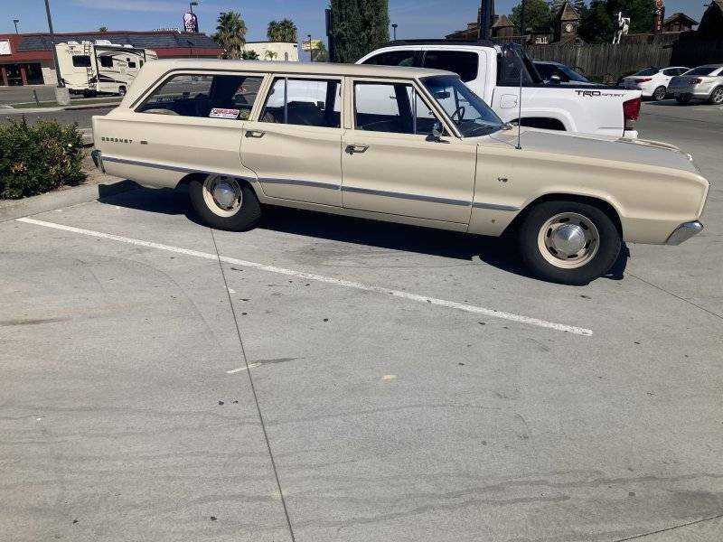

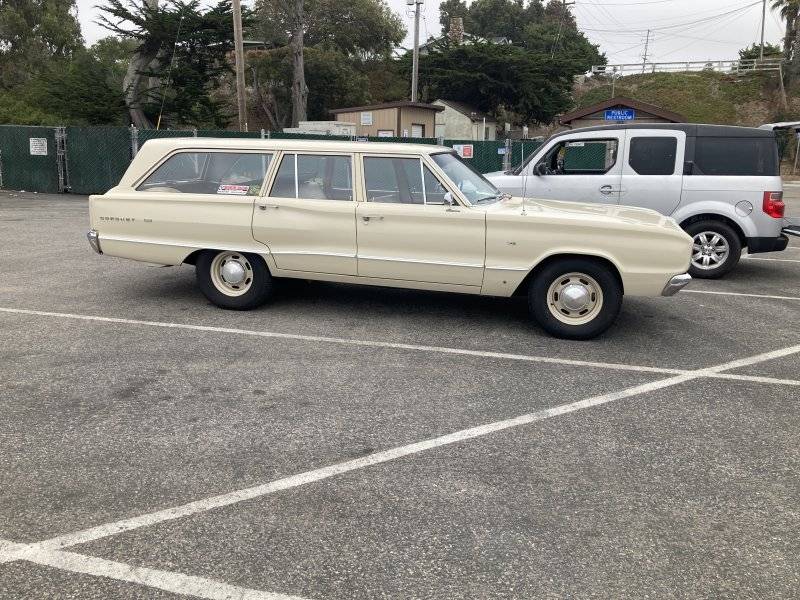

Almost forgot this. Shot of the car this morning at the Morro Bay C&C. So far, it's leveled out. Down the road after the suspension settles in some, I'll start backing off the bar adjusters 1/2 a turn at a time till I like it.

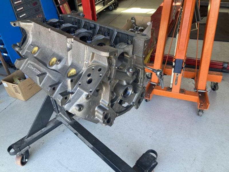

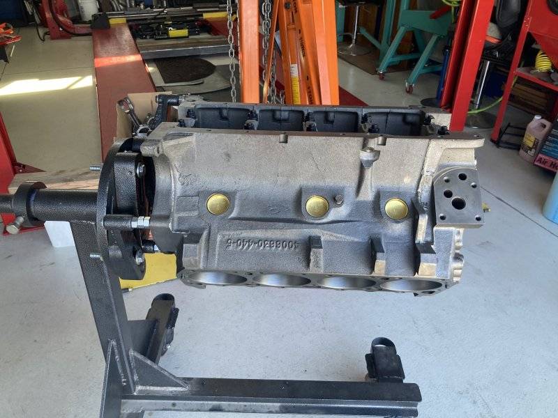

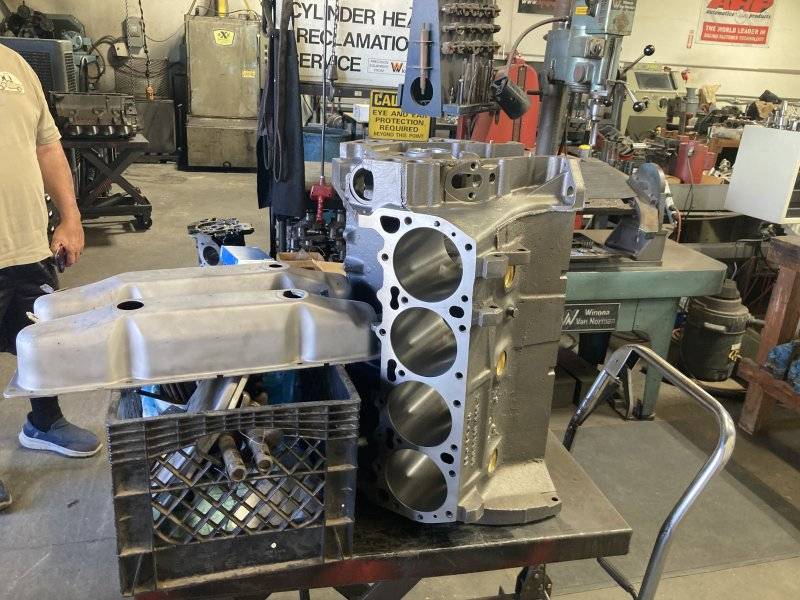

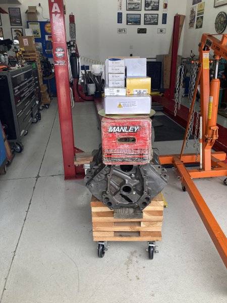

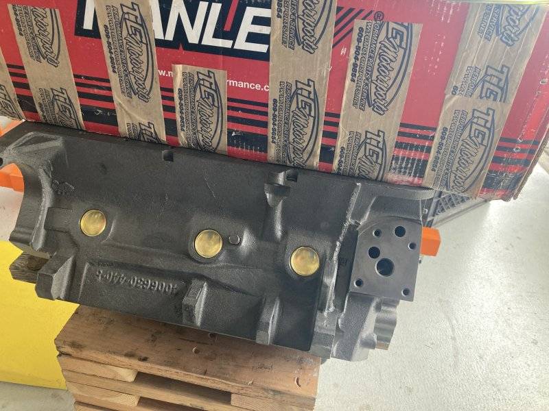

Picked up my short block pieces today in Fresno. It was a great shake down run for the new upgrades under the car. With the block in the back and the rest of the parts on the middle seat, it dropped the back end close to 2".Assembly of the engine won't happen for awhile as I have some financial commitments, but thats ok.

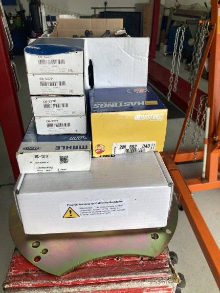

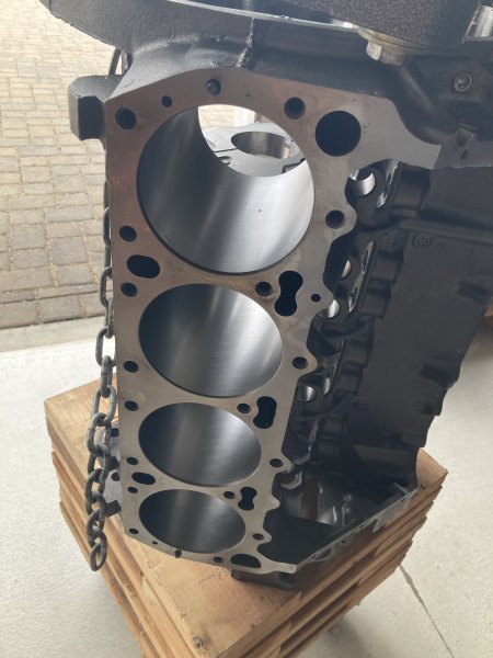

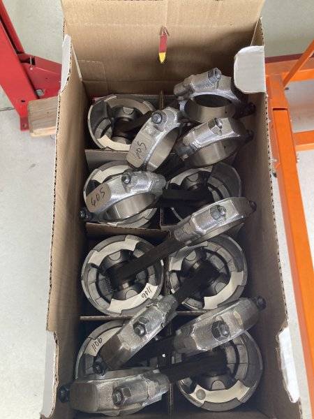

Block was cleaned, cam bearings removed, align honed, decked[ to get it flat and squared up], bored .040, honed with plates, cam bearings installed and fitted, small parts/rockers/tin cleaned, balanced. Clevite bearings, Silvo-Lite cast early pistons, Hastings moly rings, ARP main studs, block plugs. The Manley crank box is just a convenient box for my cast/stock crank.

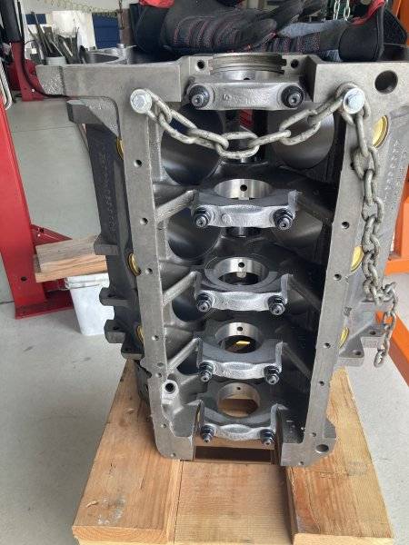

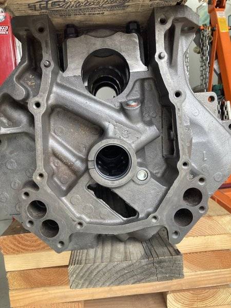

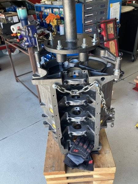

Heck yeah! Especially since it's replacing the oil sucker/leaker thats in it now. Just before lunch, I finally got the engine stand head configured for it. Tapped out the trans holes first plus spritzed some WD on the back side. Later after lunch I'll get it on the stand, tap out all the other holes, spritz with WD, then bag it till I'm ready for assembly.
You can use a mattress bag to cover it up - works good.
Don't let Don Frelier see that picture. He will bust your balls for the washers/spacers. Ask me how I know. :poke:
Needed to move the arms away from the block. Too close, no room for crank flange etc. Found some legit spacers at the hardware store. 1", only had 3 of course. $20.00 each. NOPE! 1/2" nuts @.79 each X 12.

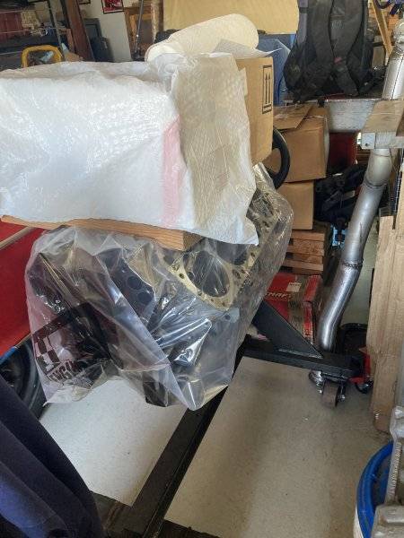

Mike supplied me with an engine bag. This afternoon I tapped the rest of the holes, sprayed the block down with WD. Bagged it. Sprayed the pistons and rods with WD, double bagged them. Pulled the crank out of the box, then out of its bag, WD'd it, back in the bag then back in the box. All protected on the new/machined/clean metal parts until its assembly time.
