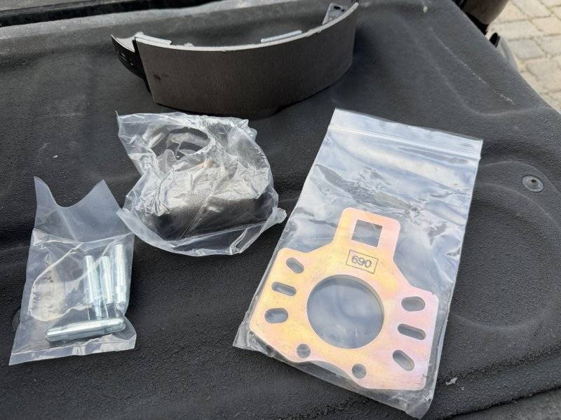

Today some items showed up that I ordered from E-Booger. Semi metallic shoes, pins, wheel cylinders and a yoke holding tool. On my Fall Fling drive, when on the way home, I felt the rear shoes[ think on the rr] hanging up again. Plus I have noticed and Steve Wall too when he got to check out the Lares box, the brakes feel spongy and a little close to the floor. When I was having issues with the self adjusters hanging up[ at least I thought they were] the rr primary shoe for worn down close to half on the lining from the shoes hanging up. I also noticed that the pin and cylinder cup/piston seemed to be always part way out when I pulled the drum off. I'm thinking there is a machining issue on that cylinder. On E-Bergs site, he has cylinders listed that deal with the spongy pedal feeling after a disc conversion has been done. The car has been that way since I bought it and is still that way after my updates. So when my lift is open, I'll put those items in. Also the pinion seal is leaking, so thats why I got the tool. Bought a new seal plus a thinner wall 1/2" drive 1 5/16" socket for the nut. One thing I don't know about, since it has a 489 housing and the PO did the gear change and carrier unit, is if he used a crush sleeve or the solid spacer. Going to buy the solid spacer and either use it, if it has the crush sleeve, or save it for another time. Another thing to deal with is the actual power lok carrier. I would get some poping and creaking when backing into the garage. I always figured it was suspension issues. It got way worse when I changed the cross shaft to use the tapered roller axle bearings. Even after putting in a second bottle of modifier and many sharp 90's and 360's, it makes a bunch of noise when backing up into the garage. Very noticeable. So I think I'll change the power lok unit out for one of the Doc's Sure-Trac II units uses helical gears like the Gleason Torsen unit. My dually has that from the factory.
Today the remainder of my diff stuff showed up. Got the new, gear type carrier from the Doc. That power lok unit makes quite a bit of noise. The pinion seal leaks too. Since I have no clue if the PO used a spacer or crush sleeve on the pinion, I ordered the spacer. Got new carrier bearings plus ring gear bolts. When I get done with the Challenger project, my wagon will go on the lift so I can deal with the brakes and diff at one time.
