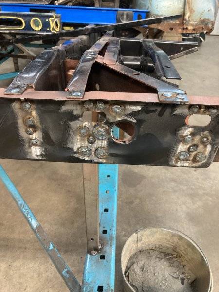

Got the rear crossmember and leaf hangers welded on min. Also the rear seat pan and trunk floor test fit. Everything is looking and measuring good so I marked out the rails from the understide to prep the floors for drilling.

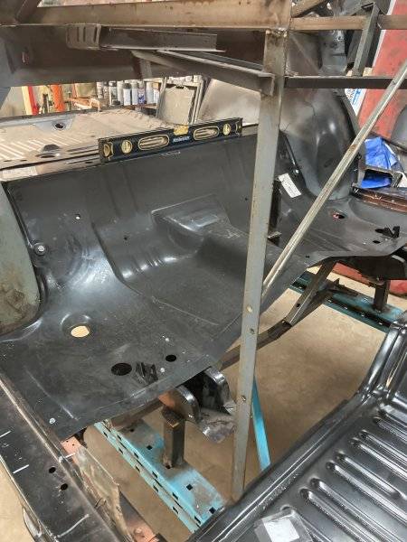

Not a huge update but I did manage to get the front floor and rear seat pan burned in. Trunk floor is fitted so next I will mock in the rear door jamb and 1/4 window supports and then fit the 1/4s, deck filler tail panel etc to make sure everything is looking good.

Test fit number one of what I’m sure will be many. So far not looking to shabby all things considered. Also for the step wells in and replaced my rear lower window channel. I had one made since I know a good metal guy and it was over $300 by the time it landed here in Canada.
