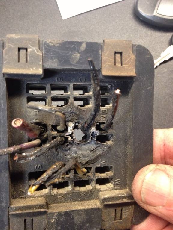

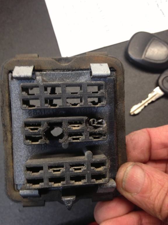

I'm sure it was just bad luck but about a week after I picked it up I was driving down the road when smoke started coming from under the dash, the engine died, and the car coasted to a stop. Long story short, the alternator shorted out, burning the charge wire back to the fire wall. It also took out the fusible link and amp gauge. In the process it burned the connectors in the bulk head. I repaired the burned wires and replaced the amp gauge. I had hoped to salvage the bulk head connector but after several tries it was no luck I had to swap out the bulk head connector and the three plugs on the engine compartment side.

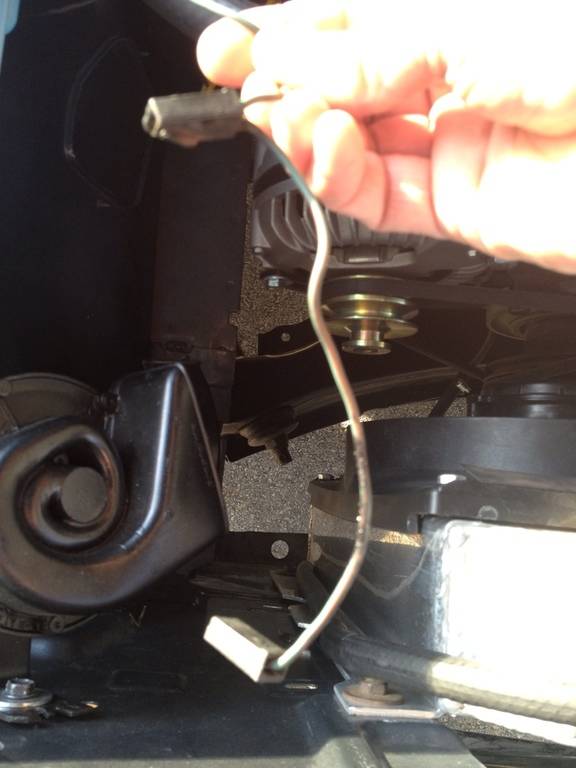

Hopefully someone can give me a little insight to this set up? Here is a picture of the end of my horn circuit, it looks like a standard two horn set up. The problem I have is this wire has no breaks between here and the fire wall plug. So where does the horn relay splice in? From what I have researched the horn relay is mounted out by the horns, but this connector is not set up that way. When I press the horn button on the steering wheel I do get a ground to this connector.

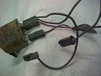

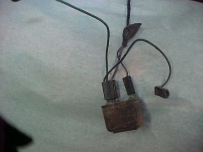

There should be a T shaped plug that the green wires for the horn come from.Wire is sorta a pink color in one side of the T plug and the green for the horn out he other.Then there is also another wire that plugs into the single spade on the relay.There will also be the WS washer pump wire there too.They all are sorta together with alternator wires.
I can run out a snap a pic if that would help.

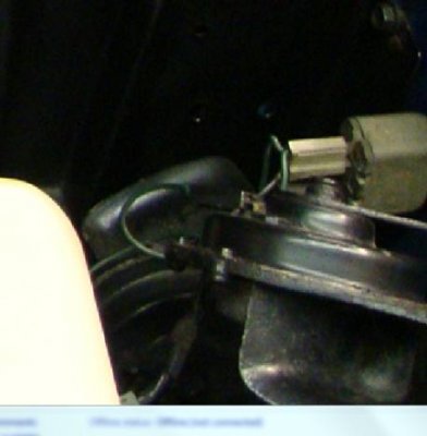

A picture might help, whats shown in my picture is a single green horn wire that is taped in a bundle with the alternator wire and the WS washer wire but thats it.
