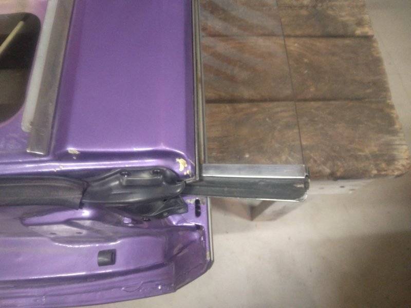

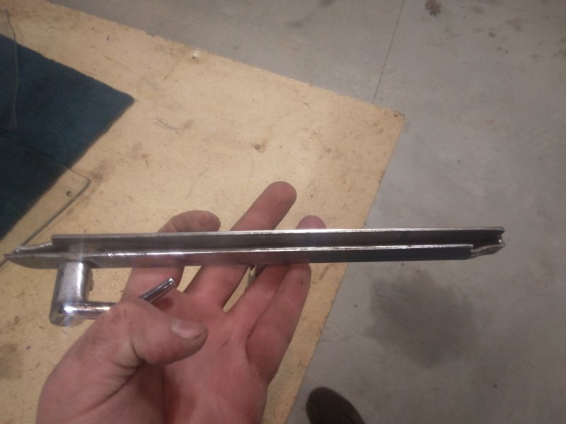

I will post about some repairs and upgrades I have made over the years but will start with what I started on  today. I Removed the passenger door to replace the guide (black channel and white h guides?) so my wife can roll the window down on her own more easily.

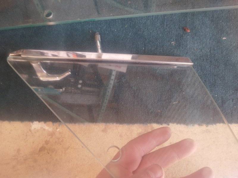

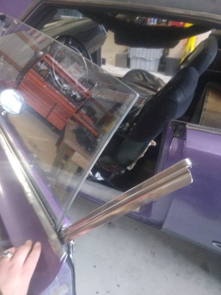

I wanna know how you got that trim off without taking your window out.
Other than costing more i take it will still fit and work?
Has been like that since 2015 rattles like crazy and some how I haven't broke it off when closing the door

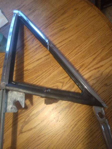

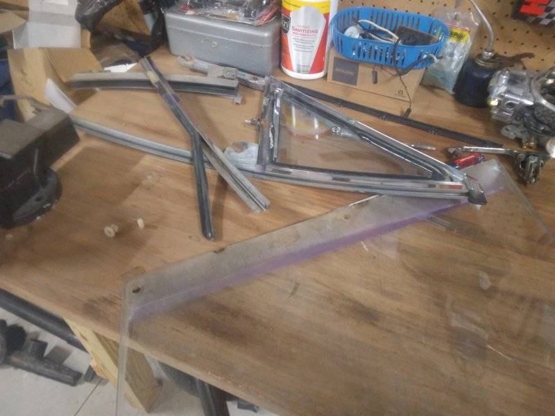

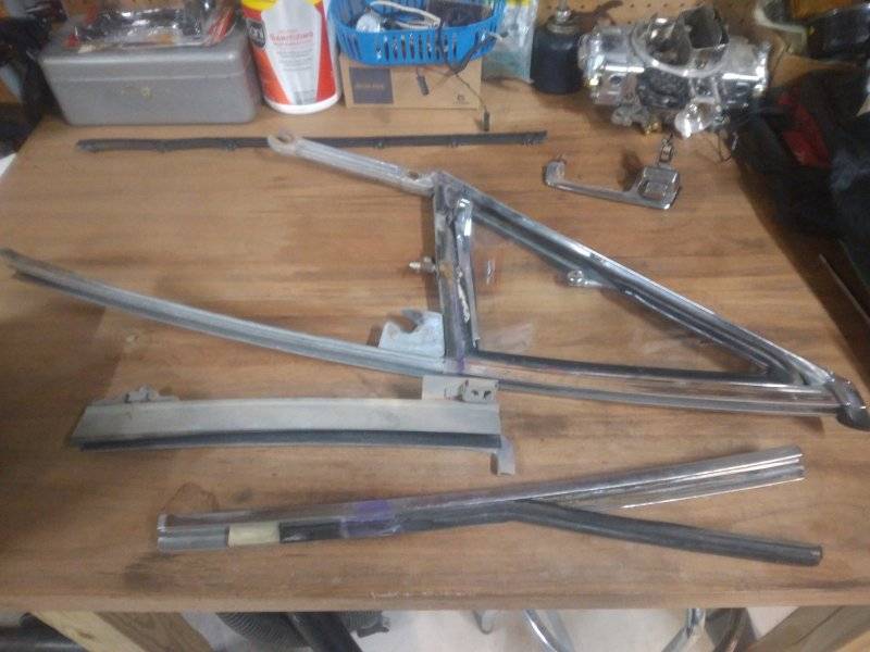

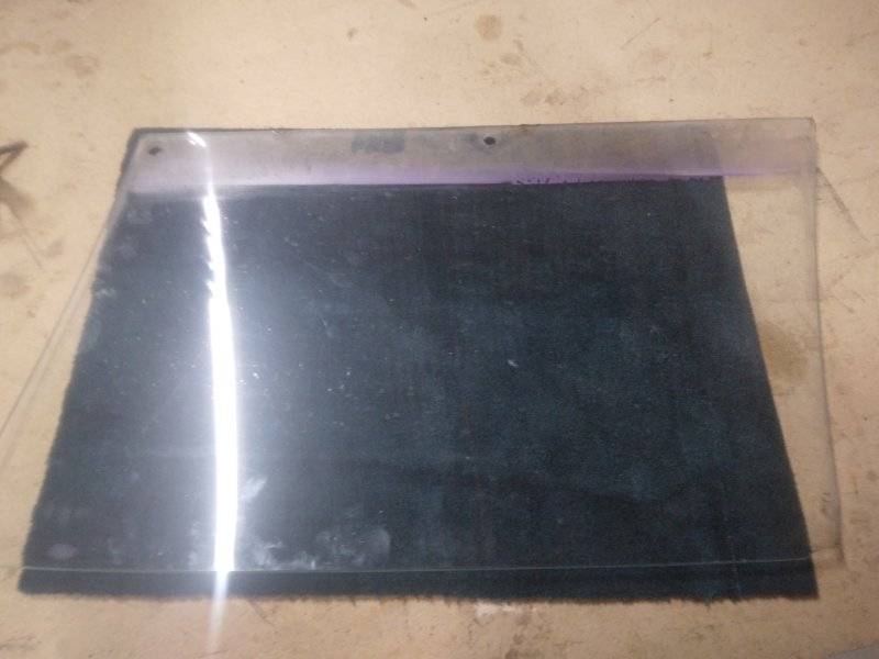

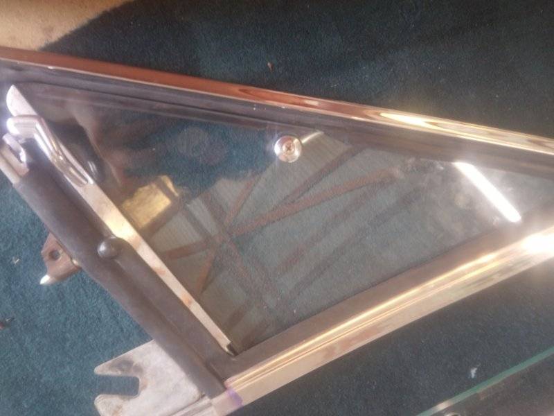

Update pulled the vent window and passenger window from the door, removed black button door handle and replacing with chrome button.

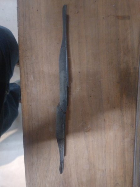

Cleaned off the over spray paint on window from p.o. and removed weather stripping and seals from all components.

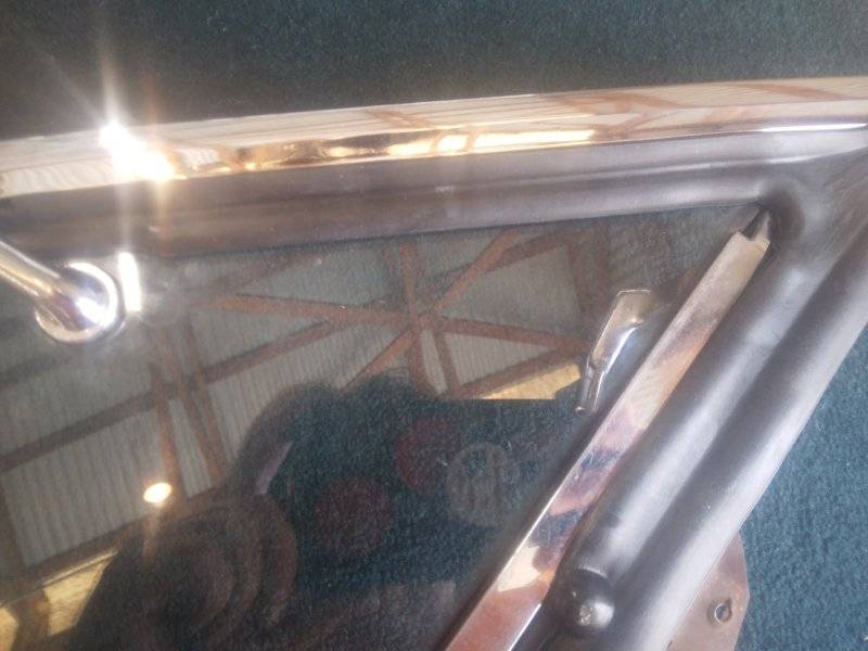

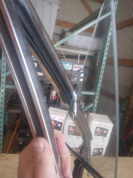

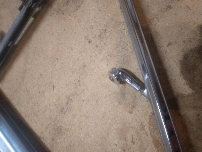

Where can I find the seal for the vent window upper pivot? (2&4) Also is the lower seal on the vent window just glass setting tape as well? (1&3)
1.
2.
3.
4.
