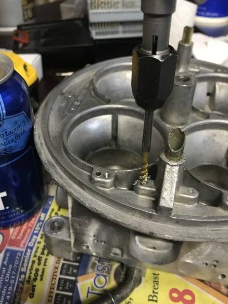

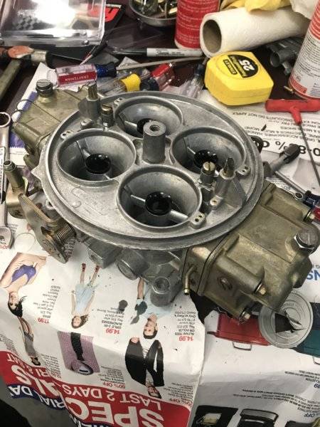

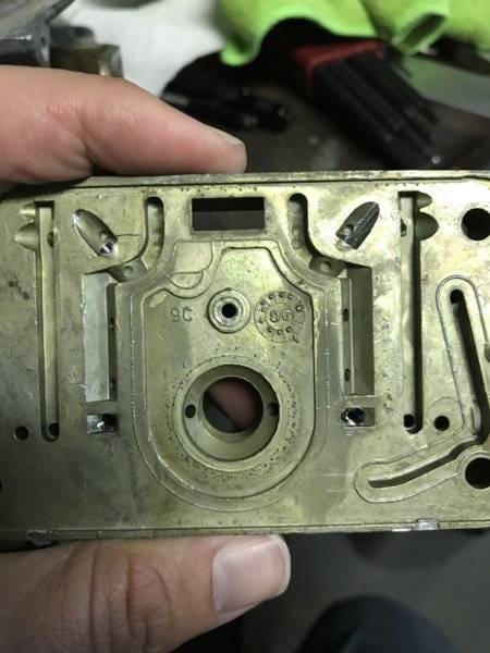

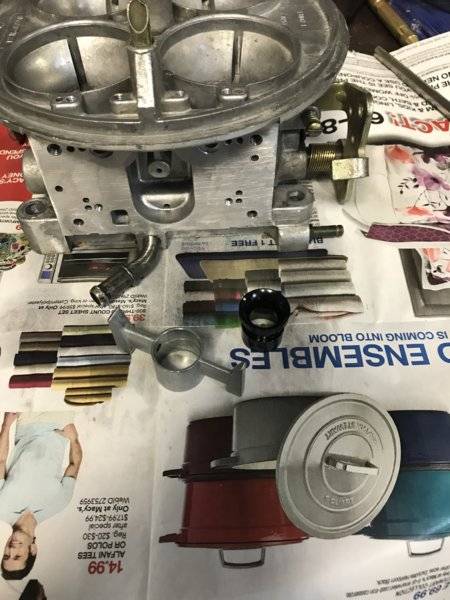

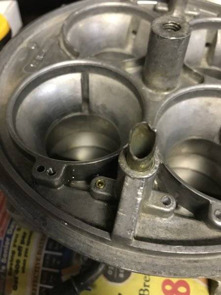

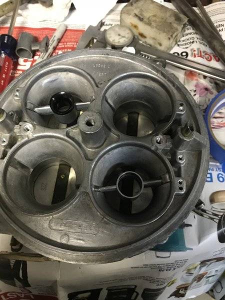

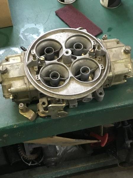

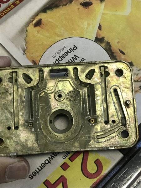

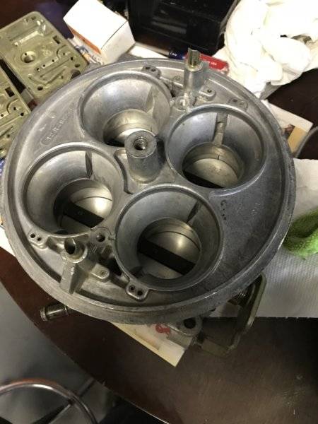

Did up an older 8082 for a 500ci Hemi. Converted it to annular boosters, made the air bleeds and IFR’s adjustable, drilled out the angle channels, and remapped it to be a much cleaner running carb. I put it on the road runner to try it out. I was very happy, one of the best running carbs I’ve had on it.

I went a tad richer on it. Ended up around 13.5 in neutral. Drops to 14.5 in gear and looses about 150-200 rpm. Comes to a stop real happy, don’t have to 2 foot it or anything. I like them as lean as they will tolerate but still be happy and have good drivability.
