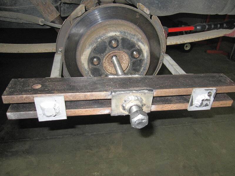

The rear rotors would not come off my son's 2006 Town and Country and I did not want to wait for a store bought puller so I made one. It will work on 16" and smaller drums and rotors. I had all the materials in stock.

Common problem around here.
A liberal coating of never seize and we still have tough ones occasionally.
We help fix other people's stuff and if they were installed dry it can really be a pain. Torch sledgehammer etc...
Heat the rotor ONLY on the last 1" of the O.D. Keep moving around the rotor and tapping it with a dead-blow.
When the rotor expands off of the fit it will get loose and come off easily. Nice puller though! I'd worry about
ripping the E-brake shoes apart if it has them?

Usually a combination of tools and techniques are required - this puller looks like a great idea, perhaps used in conjunction with heat and a hammer?

Nice , looks like that will lend itself to many uses.
I had to beat the hell out of the fronts and use penetrating oil on my "only" 5 year old Renegade.
I've never had them that bad, not even when I did my then 140,000 mile Dakota.
Anti-seize went on when the new ones did.
I had a front rotor on my friends van (he lives on a dirt road) where after a day or two I was forced to remove the whole hub assembly.
Took it to my friends 100 ton press with an acetylene torch. I think we were at 45 tons when it popped loose.
Sounded like a bomb went off.
I don't think even Mike's nice puller would have removed that sucker it was practically welded on there.
