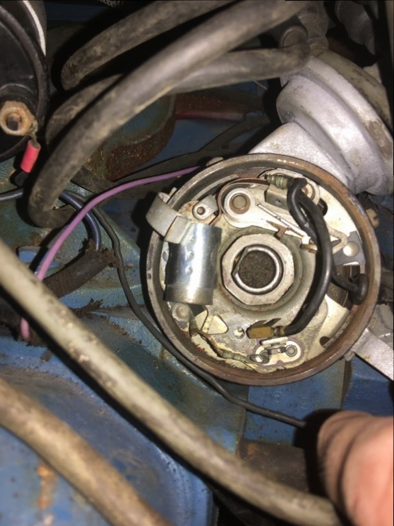

This is what I found in the cap. Do they both go on the post, or does the ground looking wire bolt to the base, or neither?

Looks like you have a dual point dizzy converted to just one set of points. I think you can just remove that heavier wire and keep it in case you want to go back to dual points. Or install the other set of points that's missing and run both. Or did you remove it yourself?

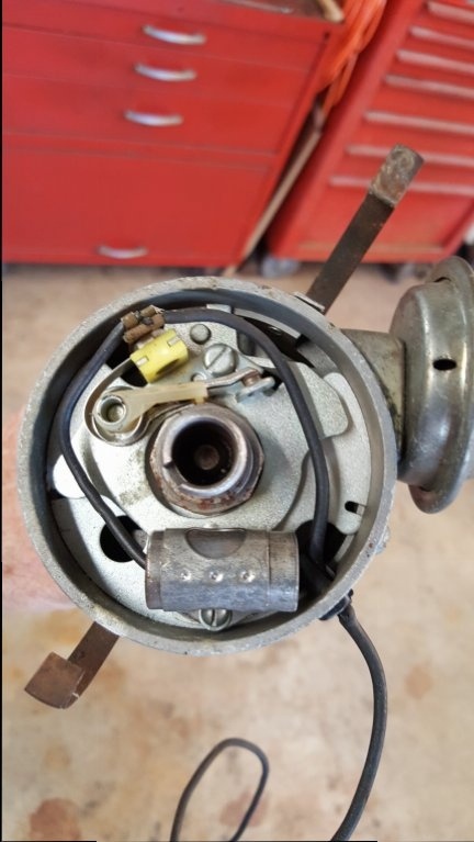

Here is what the single point dizzy looks like.
Ah, im missing a set of points. Now its making sense. I cant find any points local, but they are cheap enough on line. Do any of you guys have any knowledge of setting the points in a dual point distributor? Is it a PITA, or should I drop a couple hundred and convert it to Electronic Ignition and be done with it? Do they work with only one set?
Yes they will work with one set. They will operate as if they were a conventional single point distributor.
The ideal way is to use a dwell meter. You have to do one set of points at a time, isolating (disconnecting) the other set.
You can adjust each set useing feeler guages, having a good eye and touch doing it but it's not as exact as useing a dwell meter.

Thanks for all your great feedback and Ideas. I did find 2 full sets of points online for $15.00, so I have those coming. The single set that's on it now don't have any voltage going through them. They are new and I did clean them up with emery paper with no luck. I do want to keep it as original as possible. But its nice to know for $150.00 the full kit to convert over it is available if needed.
