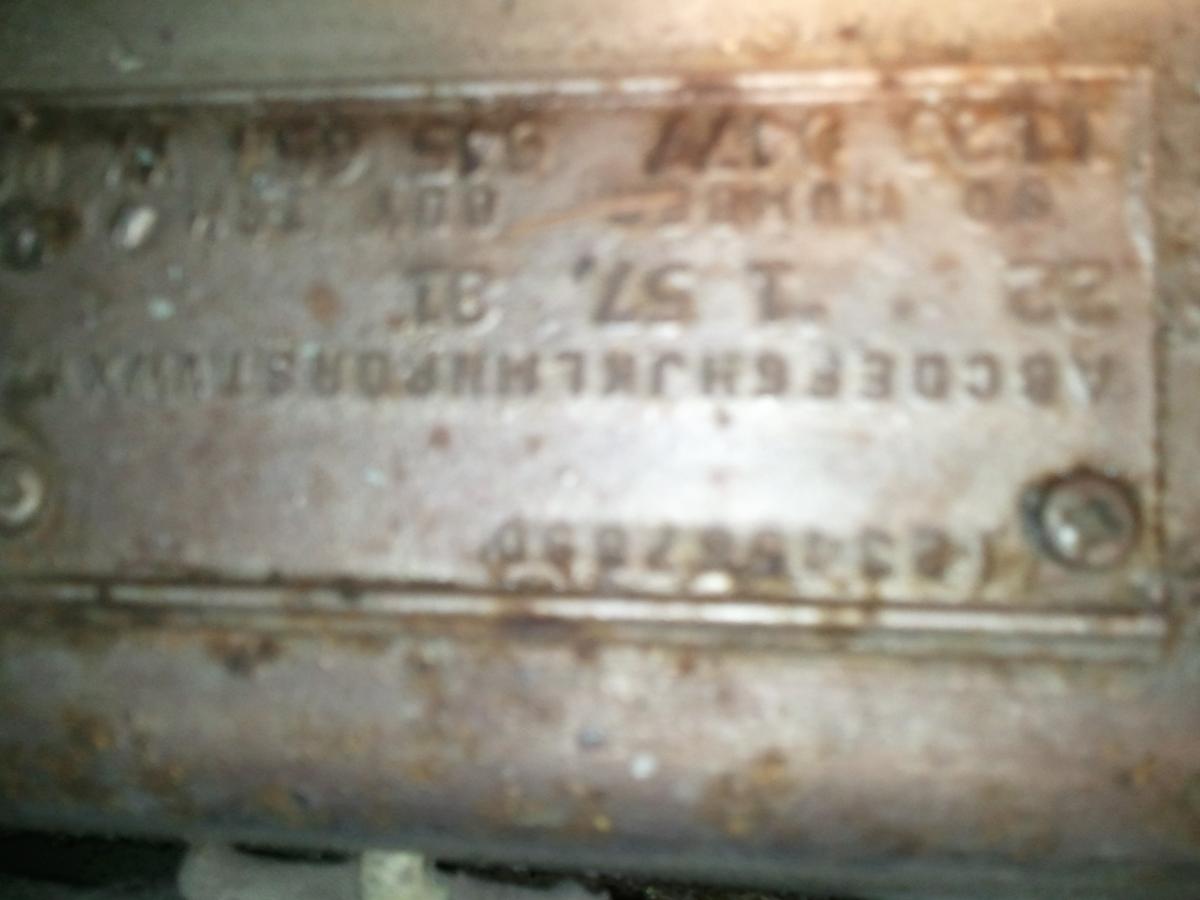

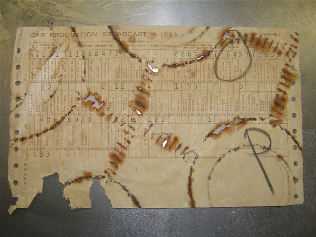

IM on my phone and will try and post data plate pic. Can anyone tell me which code is the color code and what color its called?
Pic

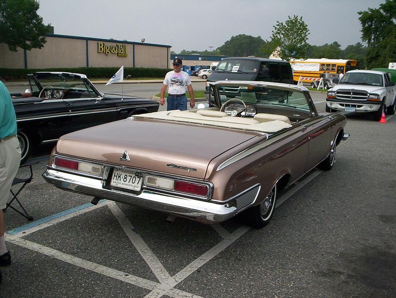

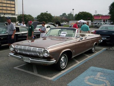

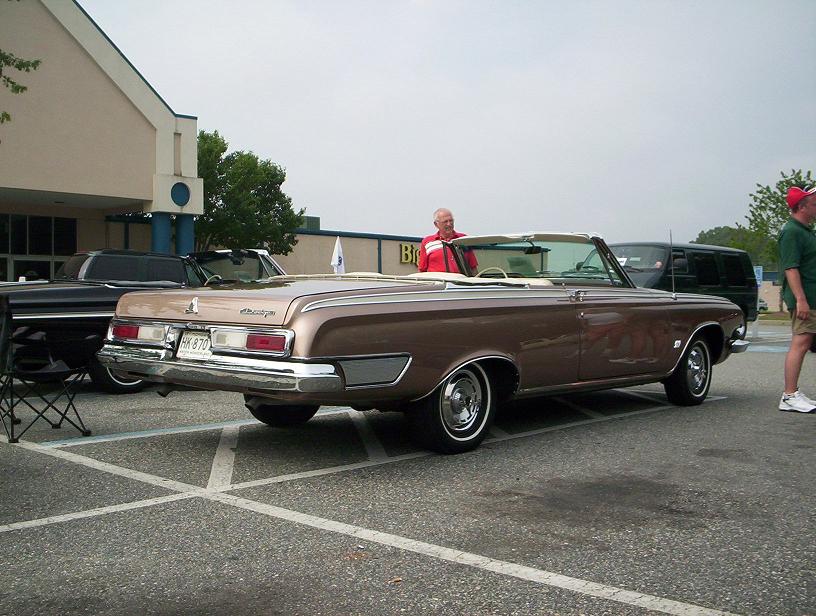

The one below showed up at a Walter P Chrysler Club show in Williamsburg, Virginia a few years ago.
This is the only one I've ever seen in this color. I vote you keep the original color. Every other one I've seen has either been black or red, and you always see the red & white interior.

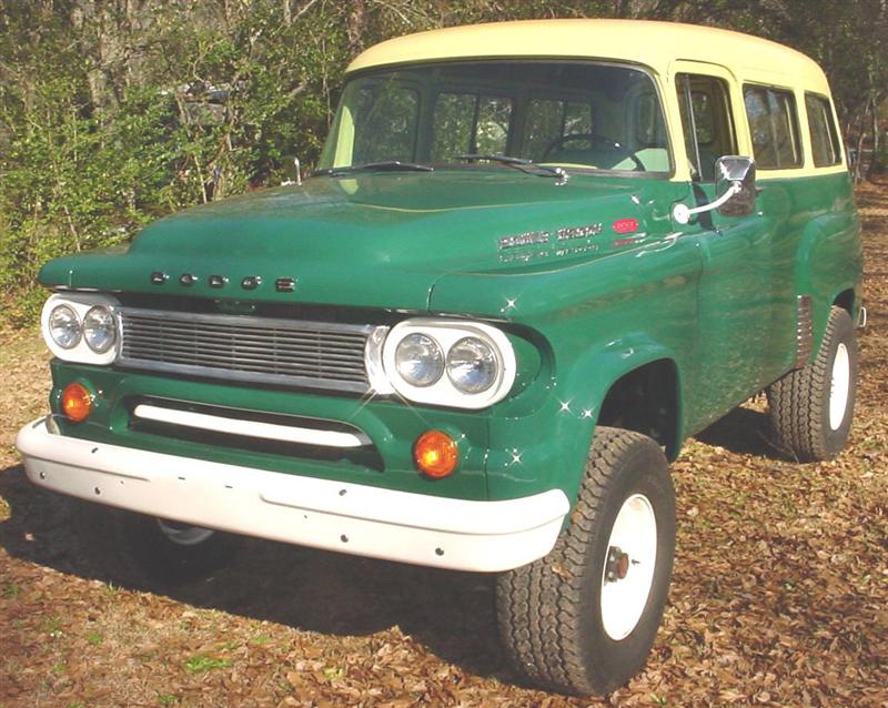

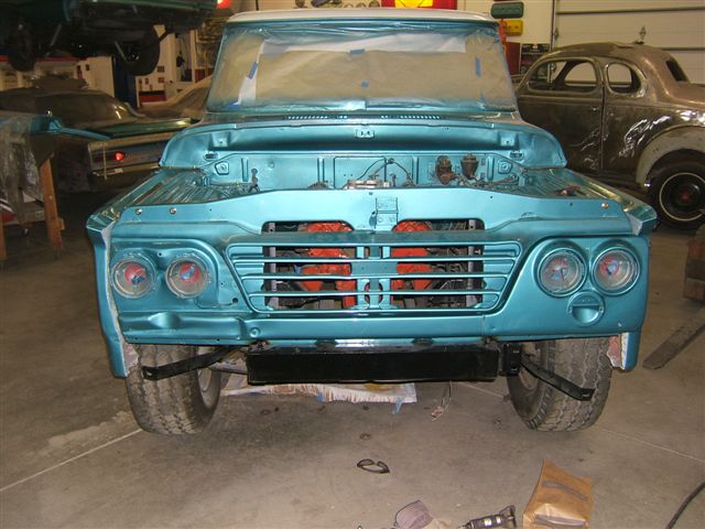

You mentioned you had a 67 Power Wagon.... Here is a pic of my 63 W100 Town Wagon. I owned it for 35 years.... Then restored it and sold it.
Does this kit have parts you guys would recommend as a whole or should I go with a more expensive wilwood kit?
The Wilwood stuff is nice for a full out pro touring, or race car, but overkill for a street cruiser..... Expensive too.
That brake conversion looks like it would do the job. I've had problems with that booster and bracket combo before though. I'm thinking a dual master cylinder mounted to your original booster might be the better choice. You might find a set of spindles in a salvage yard, or e-bay and buy the OEM componants from Rock Auto. A spindle/brake assy from a 67-79 A or B body will bolt on. New rotors, calipers and a master cyl and your good to go. Save all that original stuff though.

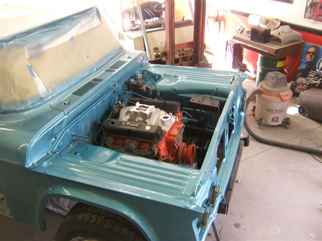

Nice rig there. Too bad you sold it. Mine is a 67 W100/ short wide 8 lug. Little 318 and I changed the color from yellow to white over Q5 turquoise metallic, the same color as my 67 Dart. The 67 was hit in the nose, so I used a parts truck/ 63 and am still building it.

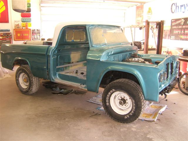

I did some mods. removed the fuel tank and filler tube from the door area and tank behind the seat. I used a ramcharger tank and 70 Challenger flip top sheet metal and gas cap and now it loads from the side.
Nice power wagon. I like the early front and the round tail lights. And the fuel tank and filler are a nice touch. After restoring the Town Wagon I was afraid to use it any more. I kind of went overboard on it. I also have a 64 Crewcab which is more of a nice driver, so the Town Wagon went and was replaced with a 65 Coronet 500.

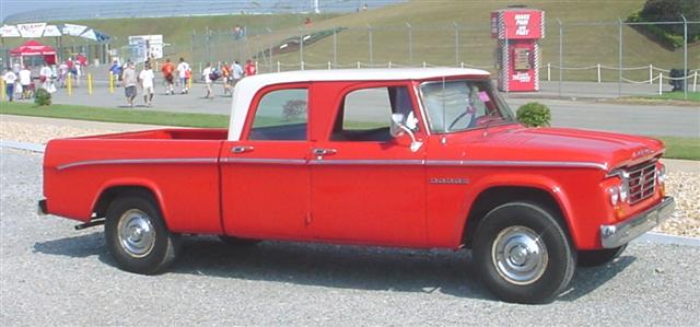

Heres a pic of my crewcab...... I'm the second owner

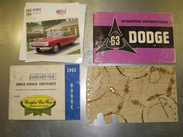

Thanks for the PM regarding buildsheets. You may enjoy this paperwork!!!
Dave
And right after I took this pic I placed them all into a plastic sheet protector. They are in my safe.

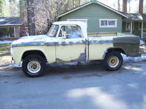

here are my other two trucks. nothing nice but they do run.
And the 68 uteline is beat up but I have some new parts for it.
The 69 long bed, I just bought a few weeks back runs and drives for $100.00.
