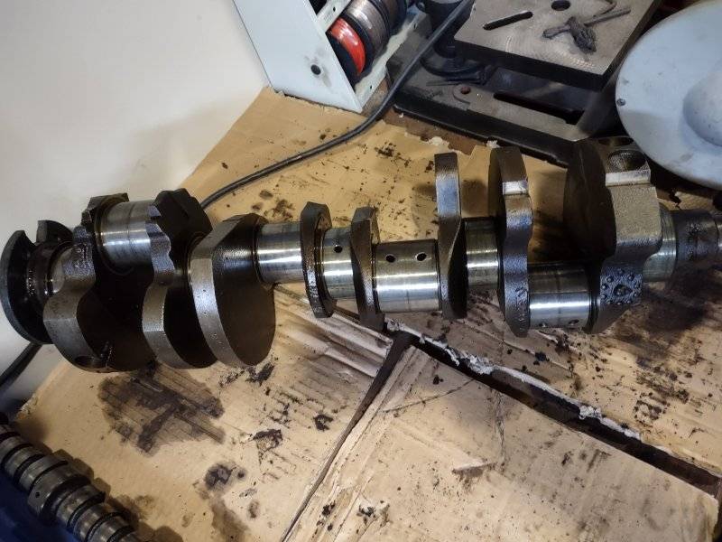

I just checked in regarding the balancing on my crank. Apparently they are going to need a small piece of mallory to balance the rear of the crank, so that I can use a neutral balance torque converter. I half expected that, so no big deal.

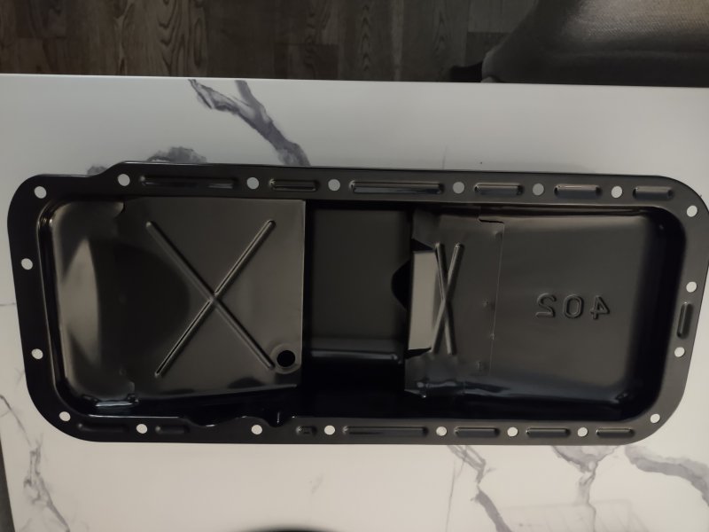

The new oil pan and pickup arrived from Mancini's today. I am impressed with the quality of the pan. It is quite heavy and the baffles are embossed like the original. The pickup has a P part number.

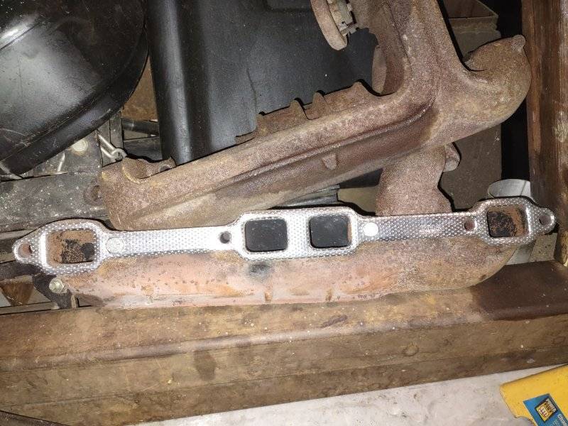

I checked the factory 73 log manifolds today and they match the exhaust gasket size perfectly, so I assume that the 66 log manifolds will be the same. I am pretty sure the head openings were smaller, so will gasket match the exhaust ports when I get the heads back. I might look at the guide bosses as well.
Ideally you want the exhaust ports on the exhaust manifolds to be larger than the ports on the cylinder heads.

The crank is back from balancing. They put one slug of Mallory in the rear counterweight and a touch of weld in the factory drilled holes both front and back. The professional products balancer has a weight on it, but I guess it was not quite enough. The welds look like they burned through, but actually the factory balance holes broke right through the side of the throws.
