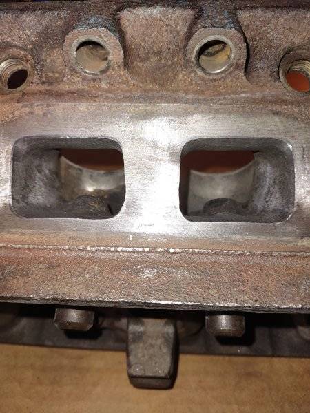

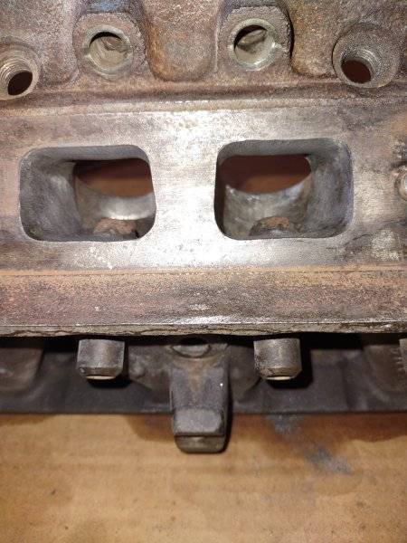

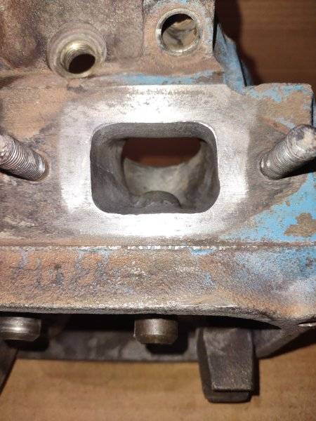

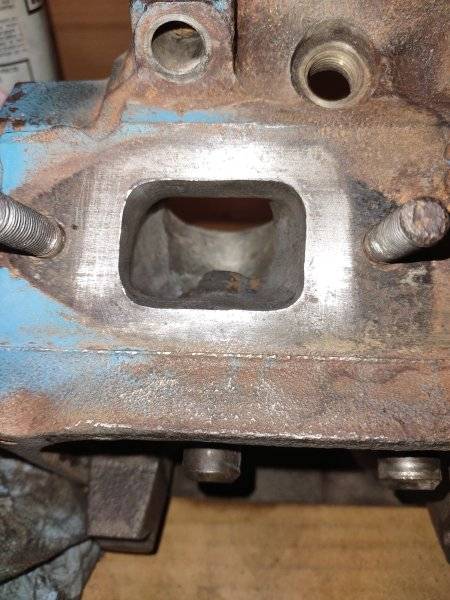

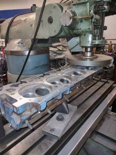

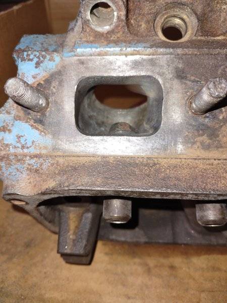

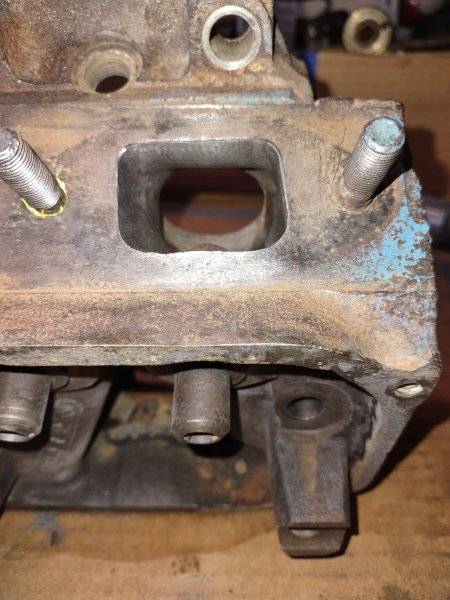

I spent some more time on the heads today and got the exhausts done on one head. I will finish the other one tomorrow.

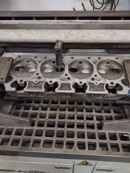

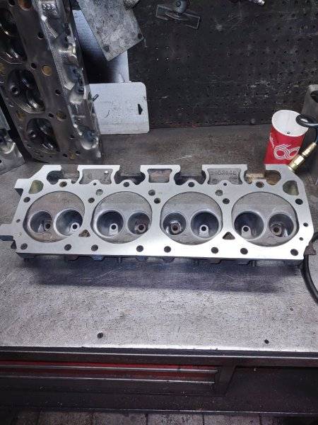

That's good - you really want both heads cut the same so the compression stays the same one side to another. At my father-in-law's shop, we evaluate the heads and cut the worst one first. The second always gets the same amount of a cut even if it doesn't need it so the engine runs consistently.The second head ... should be about 5 thou total as well.

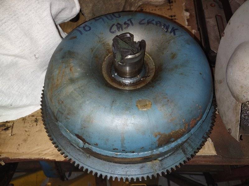

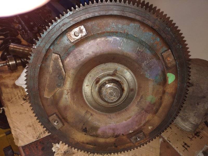

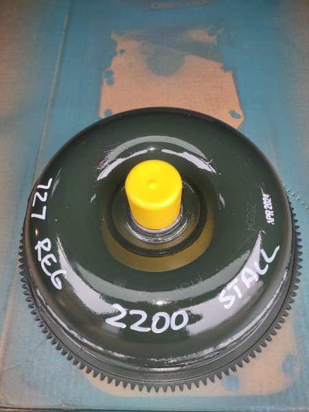

Seems like good service. Quick, and the guy actually thought about your use and did what is best for you. That's a business I would go back to!The converter just got dropped off. When I spoke to him on Monday I told him I didn't need a full 2500 stall and was more concerned that there wouldn't be any slippage on the highway. I told him that I cruise at 2300 at 60 mph. I guess he listened
