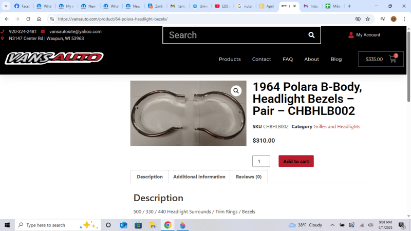

Finding a nice used pair is probably not going to happen. I might as well pull the trigger on the repops. Stimulate the economy, what the heck.
Thanks Scott. My drivers seat just isn't comfy for me. It needs some help.Mike, I used legendary foam when I did my seats. Very happy.
310 US.... you should post a WTBuy....Finding a nice used pair is probably not going to happen. I might as well pull the trigger on the repops. Stimulate the economy, what the heck.
The 64 / 65s were kind of naturally sacked out. In comparison to the 66/67Thanks Scott. My drivers seat just isn't comfy for me. It needs some help.
Prices range from $299-$524 what I have seen so far.Finding a nice used pair is probably not going to happen. I might as well pull the trigger on the repops. Stimulate the economy, what the heck.

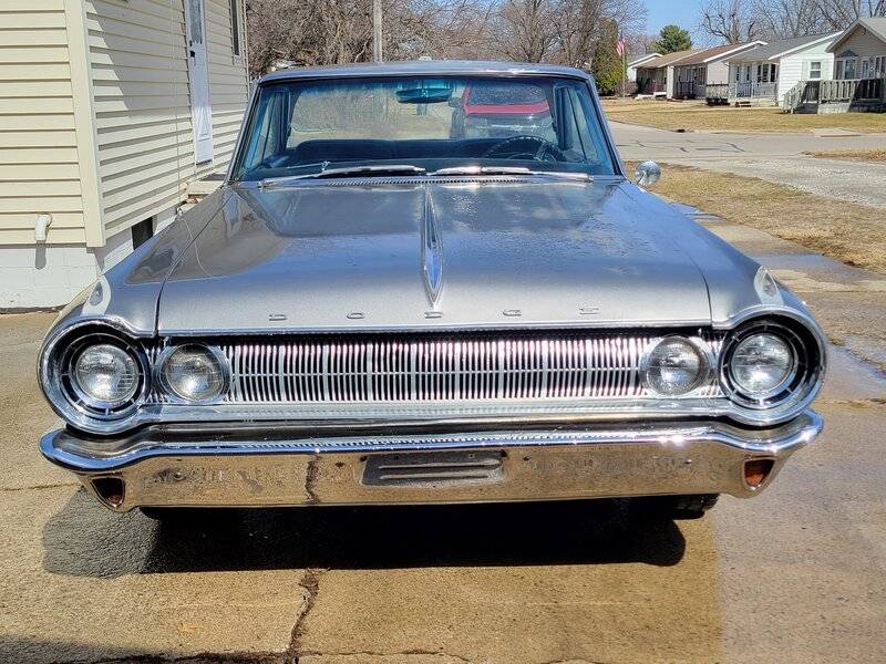

Both are clobbered. Labor and plating costs now days could eat up $300 pretty fast but I could check. The drivers side looks pretty good until you get close. An amateur straightening job possibly?are yours so bad that they are unsavable? maybe send them to one of the trim repair guys?
They do nice work. I have checked out their booth at the Nats. Iverson Automotive out of Minneapolis does top notch work as well. Not cheap though. Many of those shops are at $100/hr. labor rate. It doesn't take long for the $$'s to add up.Yeah, those headlight surrounds are the first thing to go. The front bumper does not give much protection for them. About the only guy that I know who may repair them is Bill at Special T's, near Chicago. Probably cheaper to buy repops.
plating? those should be polished not plated (i think) .. i would check into it.Both are clobbered. Labor and plating costs now days could eat up $300 pretty fast but I could check. The drivers side looks pretty good until you get close. An amateur straightening job possibly? View attachment 1830524
When I said plating I meant any chroming or anodizing. They are probably stainless. Harder to straighten but easier to polish. It still takes many steps.plating? those should be polished not plated.. i would check into it.

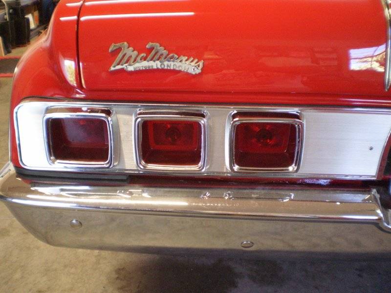

Those look great. Pitted pot metal is the worst.I bought a pair of stainless steel plates Bill manufactured to fit over the usually-pitted Polara tail light bases. These have fine flutes milled into them to replicate the look of the original bases. They are held in place with the tail light bezels. As you can see, I had to attach the ends of them with a small trim screw. I hated to do it, but nothing else would hold it down. An acceptable repair, as pitted originals are impossible to repair. I bought them from him at Indy Swap meet; $450/pr.
If it is thick enough, you can sand the pits out and polish the zinc. A customer of mine did that with a pair of tail light housings off a Cameo pick up. They were thick pot metal though. Aluminum can be straightened and the anodizing removed, sanded and polished. Clear coat if you choose but polishing aluminum occasionally is pretty easy.Those look great. Pitted pot metal is the worst.
