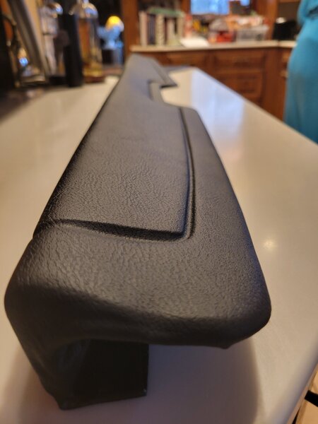

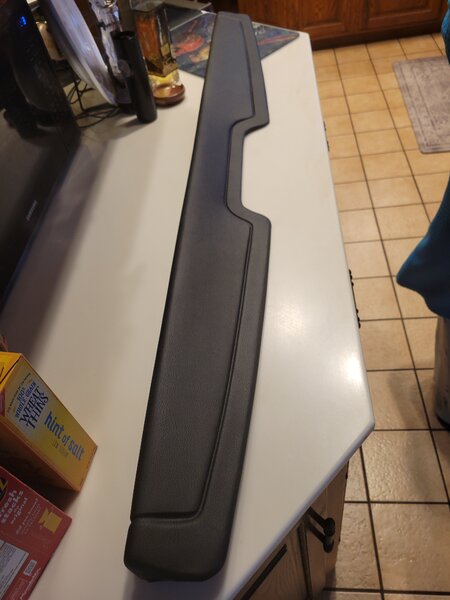

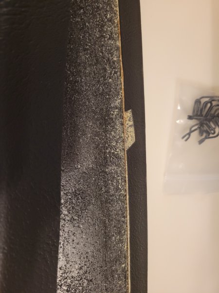

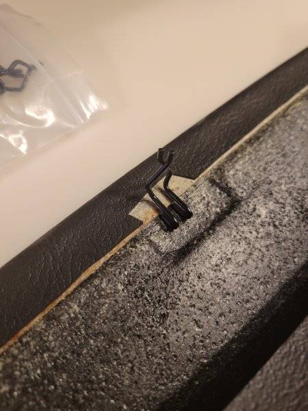

Hey guys, I got my dash pad today from ABC Moparts. Nice stuff. I see the clips they use are door panel clips. Is that what you all are using or would some plastic "Christmas tree" style clips work better (and easier)

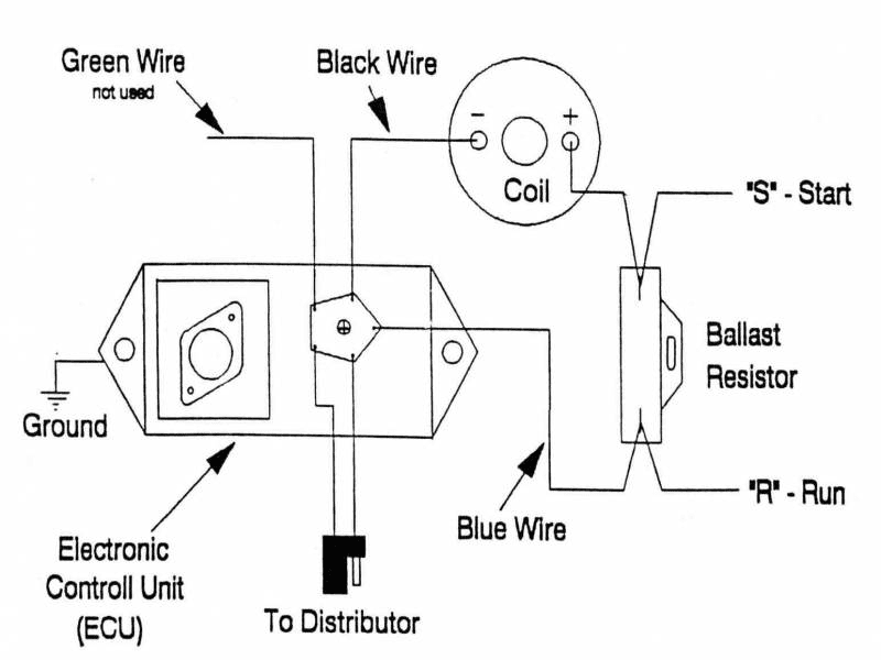

Well, I got her running. A little wiring clean up and a 4 pin ECU instead of a 5. I printed out 4 different wiring diagrams and only 1 made sense for an old system. Now I will try my hand at the dash pad. (If I have enough patience)

I found this schematic to work on my 64. The start position wire from the switch feeds the coil directly. When you let off the key, the power feed goes through the ballast in the run position.

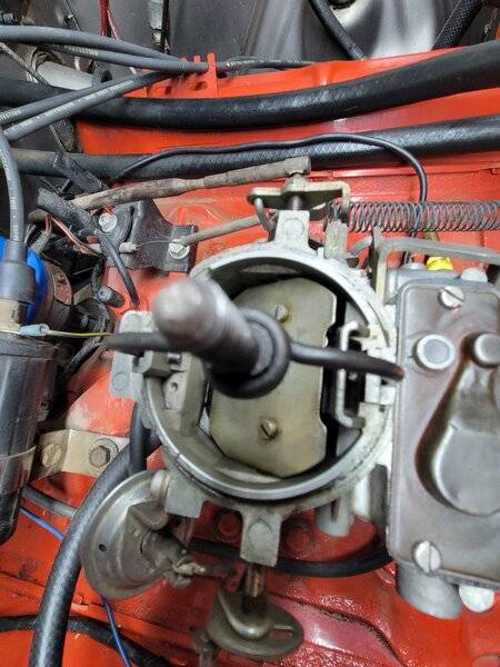

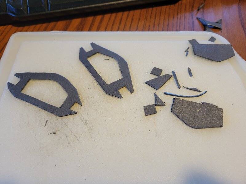

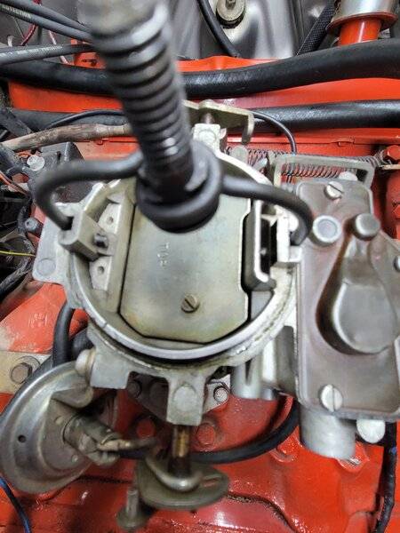

Oh, another little fix I did was to raise the choke thermostat in the intake. I got a sheet of header gasket material and cut out some gaskets. There is no adjustment for the rod length for more choke closing. It worked well. Just enough length for the choke butterfly to close all the way. Hey, when you're having starting issues, everything has to work as designed.

Hey Mike, what carburetor is that? Looks nothing like any that I’ve seen on any 318 that I ever had. Mighty fine looking Polara, early Bs are my favorites.
It's a Holley. I don't know where it came from for sure. It seems to work well.
