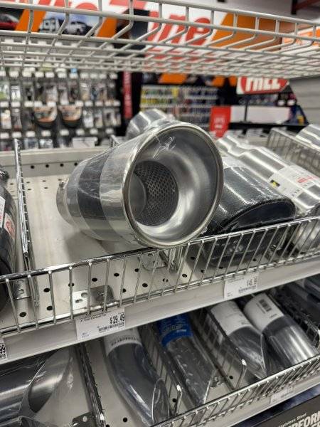

Easy mod:

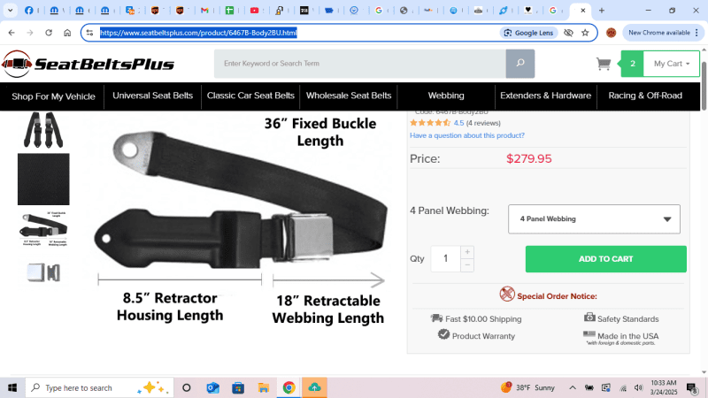

If you take off the inner aluminium sill plates and pull up the side of your carpet, you will find threaded provisions for optional seat belts in the sills. All '64 Dodges had these. A set of Retro Seatbelts can be attached here with regular seat belt bolts. There was no factory provision for attaching rear seat belts, however. I have added rear belts to my car, using large, thick flat washers for floor reinforcement.
I found these and they look like they would work fine. The retractors are a nice feature.
I am not necessarily restoring the car. I feel like I don't need to find original belts that I would send out to get restored.
I got my seatbelts form that place.. i am very happy with them.. I went with this one since i like the latch type.. it's the same as my 66 new yorker had..
Good to know they were nice belts. The PO screwed rings in the bolt holes. I found some clip on belts for rings but thought the flopping and noise might not be good.

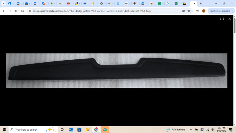

I was reviewing my bank accounts and thought what the heck, I might as well order a dash pad. The fellow at ABC Moparts called me back to make sure I wanted a black one. Nice fellow.
great thing to spend the money on though :) Nothing worse than a bad dash pad
Or none. It looks like the PO refinished the dash but never got to the pad. Arizona car. I can imagine it wasn't pretty. One thing I didn't get was a core. Yes, something you look at everytime you get in the car.

Got em. I guess I'm fixing this ol girl up all at once. I need to get it ready to cruise to Mopar's in the Park the first of June.
