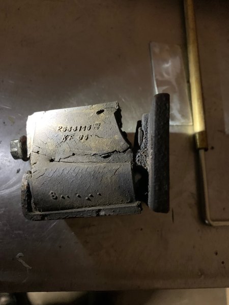

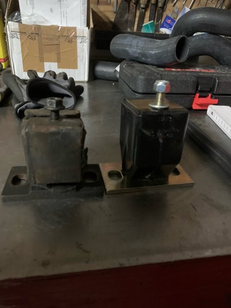

After pulling the old one out we noticed that the new one is 1cm (0,39") HIGHER than the old one. It would only be possible to install that by using force/pressure and it would also move the transmission/driveshaft position.
We do not really feel it would be a good idea to do that.

It woulg be my guess the new mount is the proper dimension, given the old one is pretty well gone! If it fits without the trans hitting the floorpan, I say go for it! ruffcut

It's not fitting without forcing and squeezing. It's possible but it does not feel right and would move the whole transmission/driveshaft 0,39" higher.

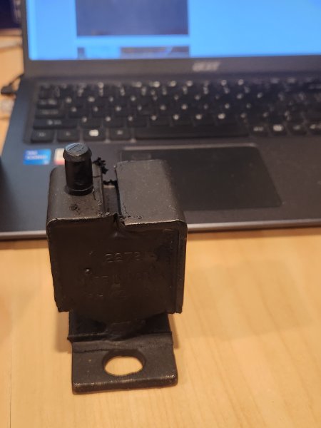

You bought the wrong part for your survivor Charger. Get a stock replacement. That urethane mount is for a hotrod

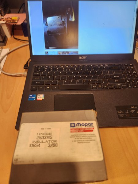

READ the label, dated 3/98
Well that's still 25 years but it looks to be in great condition.
