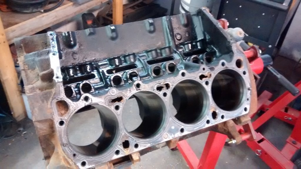

  • I finally tore down the 400 the rest of the way. While it is a 400 hp thick web block it definitely doesn't have a forged crankshaft. Here is another strange thing. We know its not the original engine in the 66 it was hooked to a internally balanced 383 torque converter. Not good. Second strange thing is that the harmonic balancer is also for a internally balanced engine but is the later model balancer 3614371 used 72-75. Crankshaft casting number is 3462923. Everything in the engine is standard sized as we thought.

Thanks but we're going to go with the 400. I already have a forged crankshaft coming for it and new Keith Black pistons. I'll have arp rod bolts put in the rods and have everything balanced.

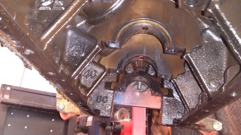

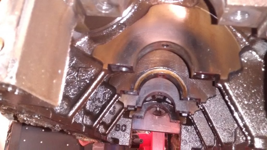

Here are a few photos showing the extra thick webbing on this block. Very seriously considering options on how far to stroke this motor.
